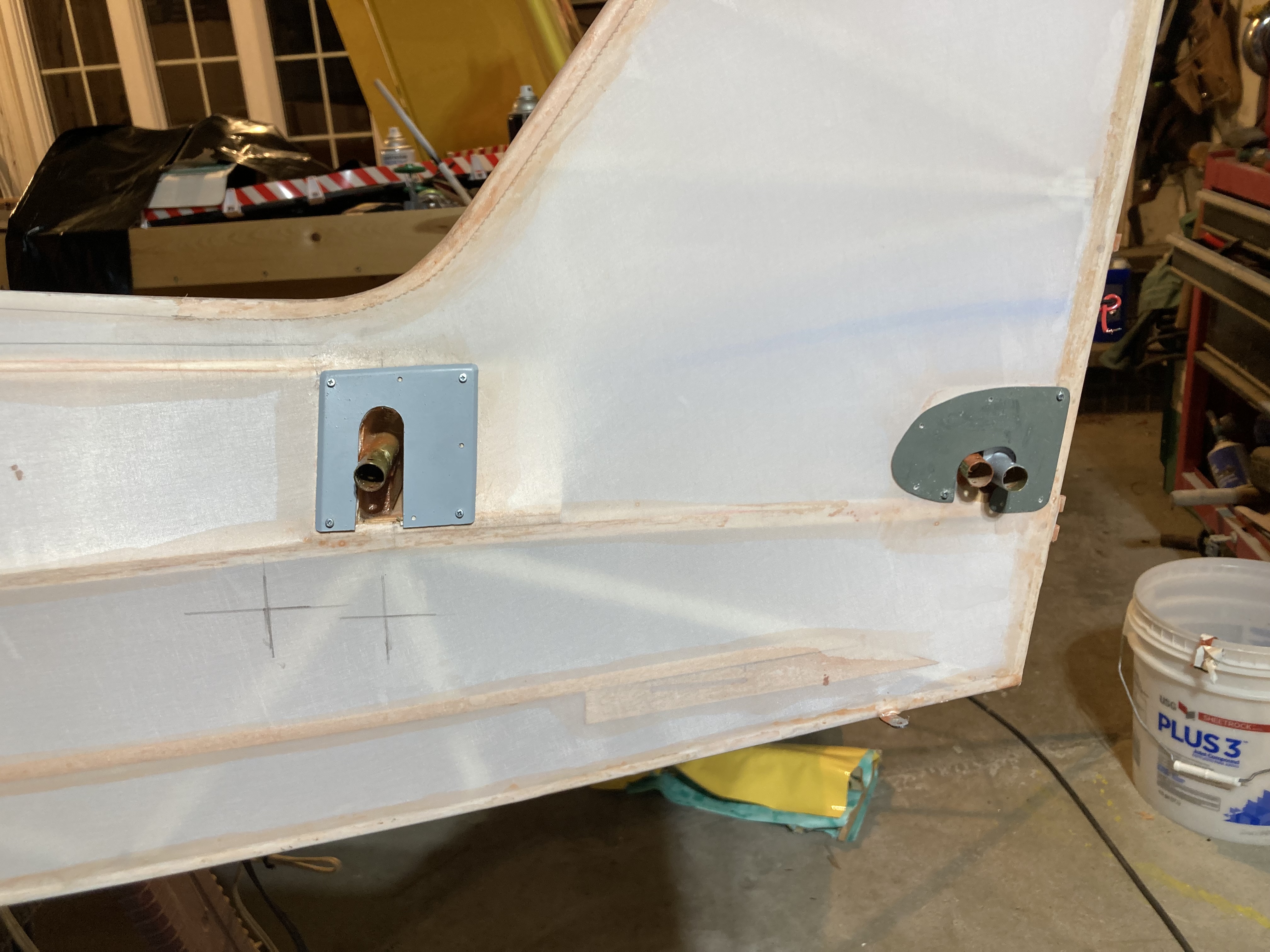

I wish I had your patience to build. I can spend a lot of time building the flying parts but the interior I just don’t have patience. Nice work on all the details like the exhaust now that is what I like building.👍

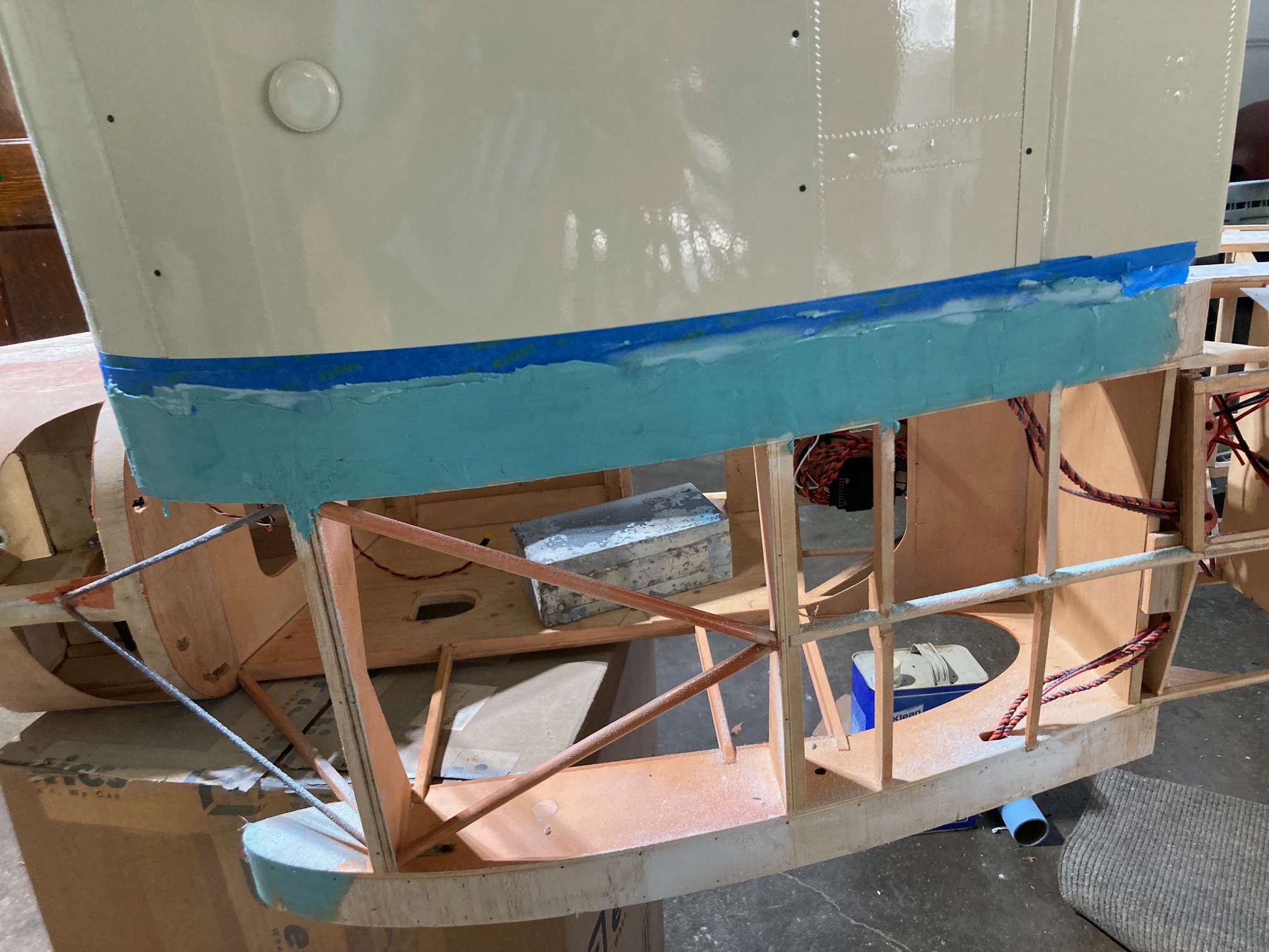

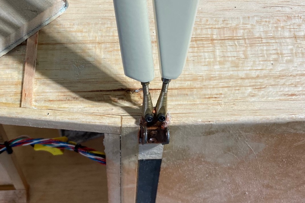

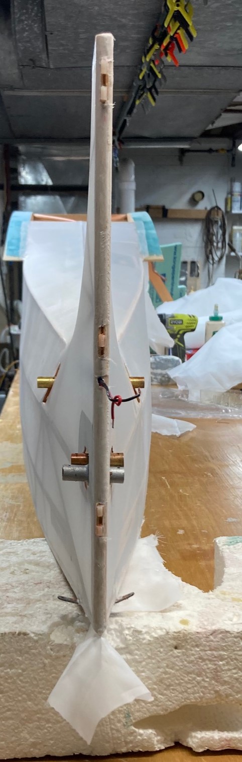

I knew the wing fairings were a little close so I decided to add a little space. There are six layer of masking tape on the wing root, filling with SuperFil. I made these rod ends some time ago when I first bought the lathe, 6-32 threaded end with 4-40 through bolts, the nuts are soldered on to the rod end, should have done the same on the Champ!
