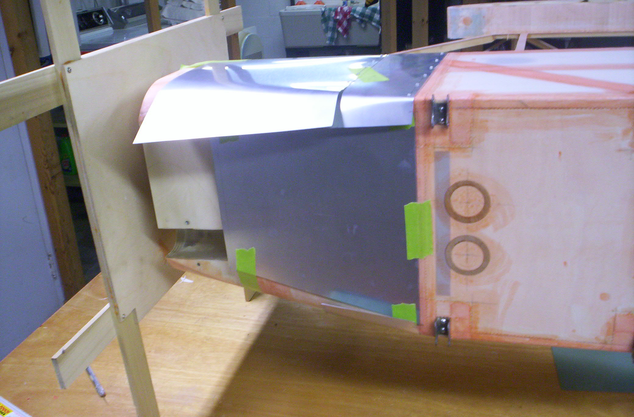

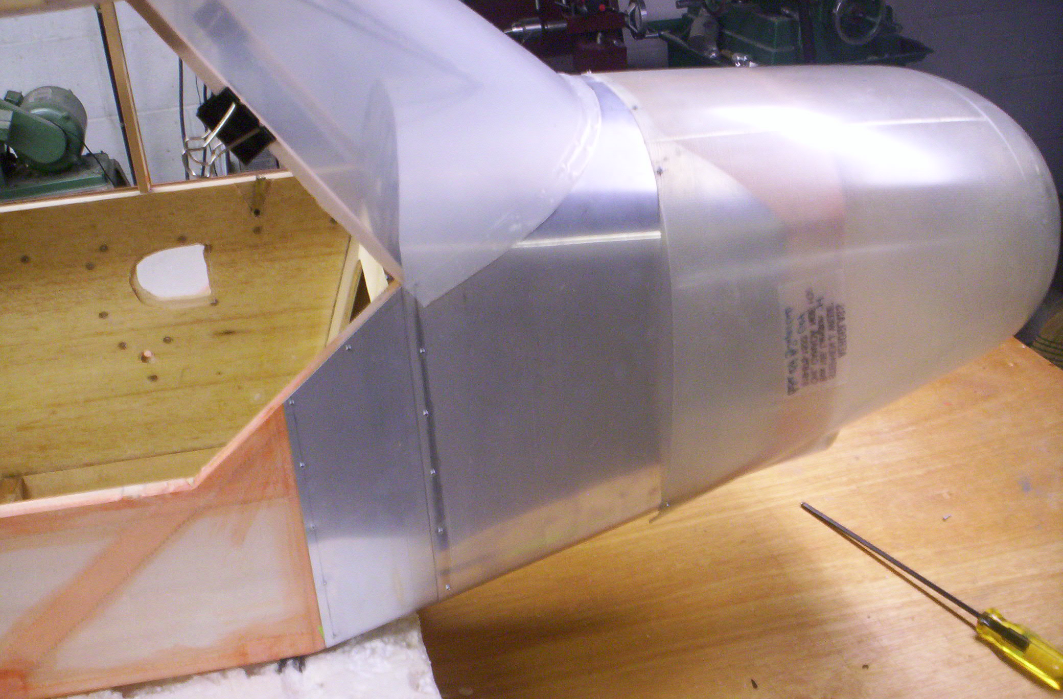

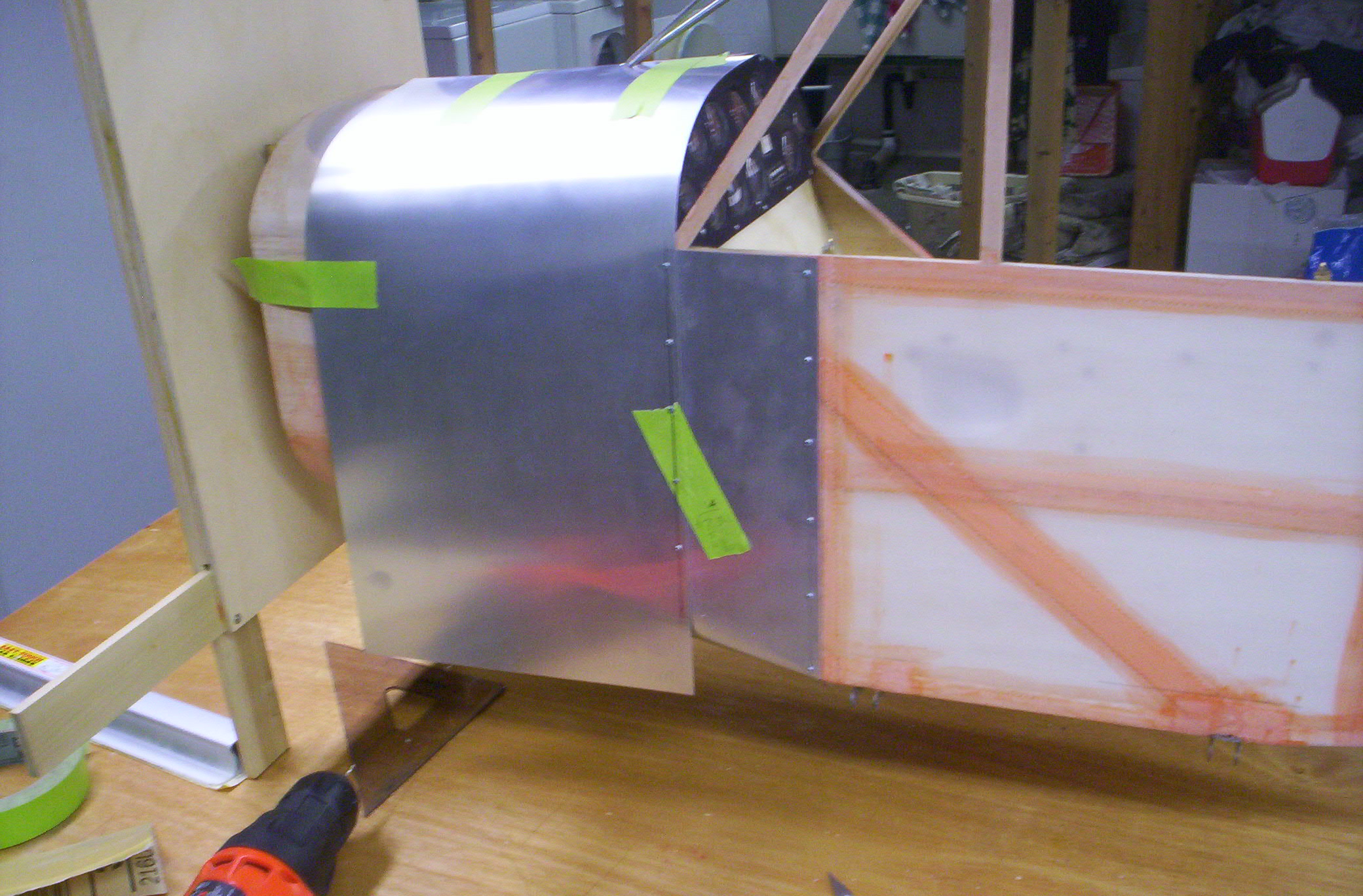

The boot cowl section is 5 pieces, one on the bottom, two on each side that over lap on top since the front support wires meet at the center of the plane. The full scale is split at the top as well. The Cub may be different since there is inverted from the Super Cub.

Tony, just going with your Super cub boot design. How does this piece look on the other side?

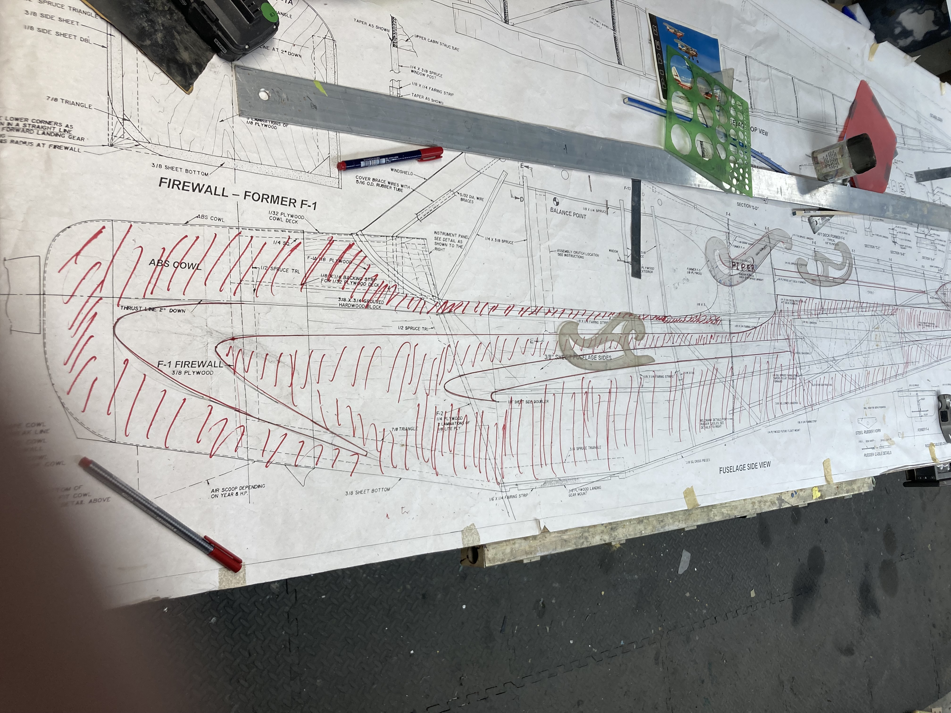

Using three artist drawings and one photo drew the graphics on the fuselage side view drawing. I will use this to make templates for laying out the fuselage. I'm using the N number from a photo I found at the Piper museum. For the longer curves I used a piece of 1/4" square spruce nailed down to the bench. Templates will be made out of SeeTemp Can't wait for spring
