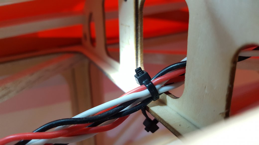

I put all my wires and fuel hoses in the braded wire loom. Never had it rub threw .When my wires are running down the fuse and I want to zip tie them to the cross members, e.g. formers, I don't like to zip tie them directly and the zip tie cutting into them at basically a 45 degree angle. I'll put a zip tie on the former and then zip tie the wires to that zip tie. Seems like a lot less cutting into the insulation:
