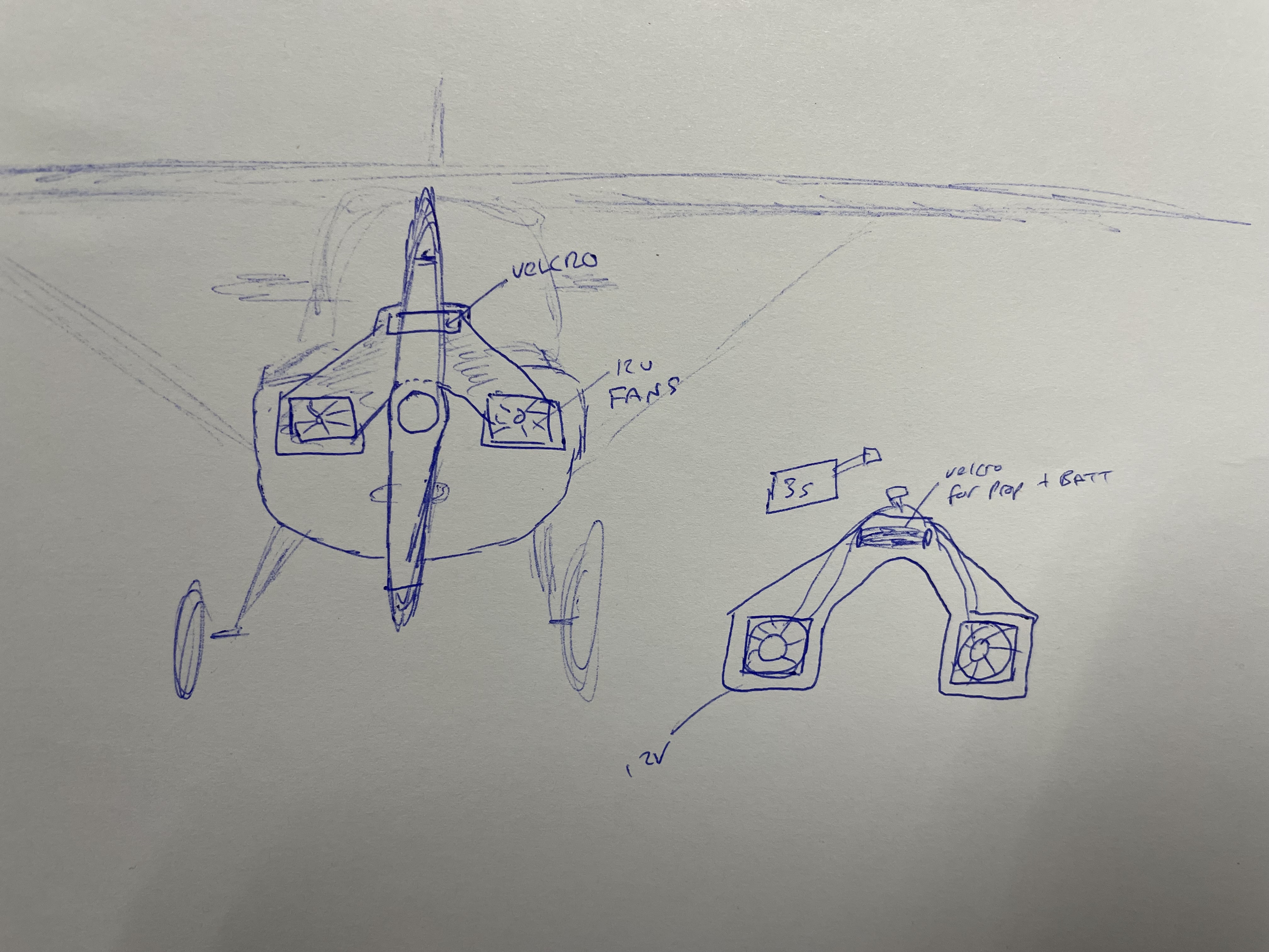

Just ordered two 50mm cooling fan on Amazon, $13. I think that the fans will be mounted to a sheet of 1/16" aluminum that will rest to the prop hub. Need a 3s battery.

While I'll be, never heard of it, thanks Nick, might just make one. The kits are designed for 4" and 6" spinners, the plane doesn't have a spinner.
Shouldn't be hard, get a couple 12V fans and a 3S Lipo mounted on a V shaped wood stick that ties to the prop.

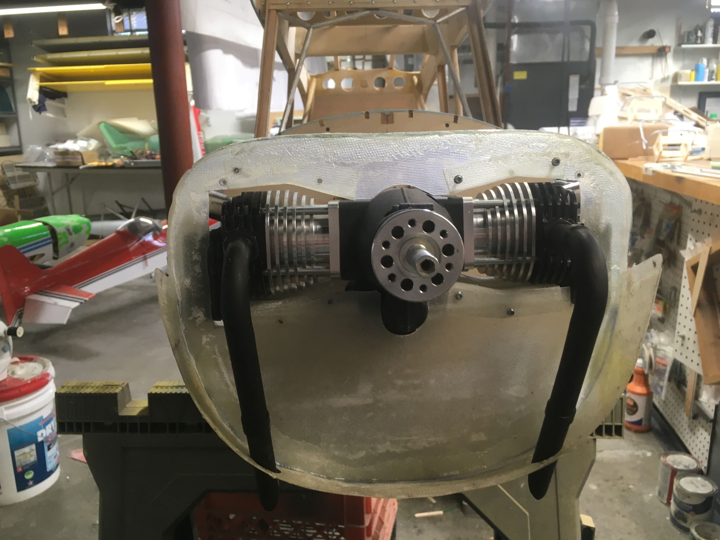

I suspect since I loose compression that the cylinders cool faster than the push rods. The cylinders are finned and are in the airstream path, the push rods are tucked under the engine baffle away from the airstream. The Champ baffle is shown on the top photo, the push rod tubes are right behind the servo screws below the cylinder.

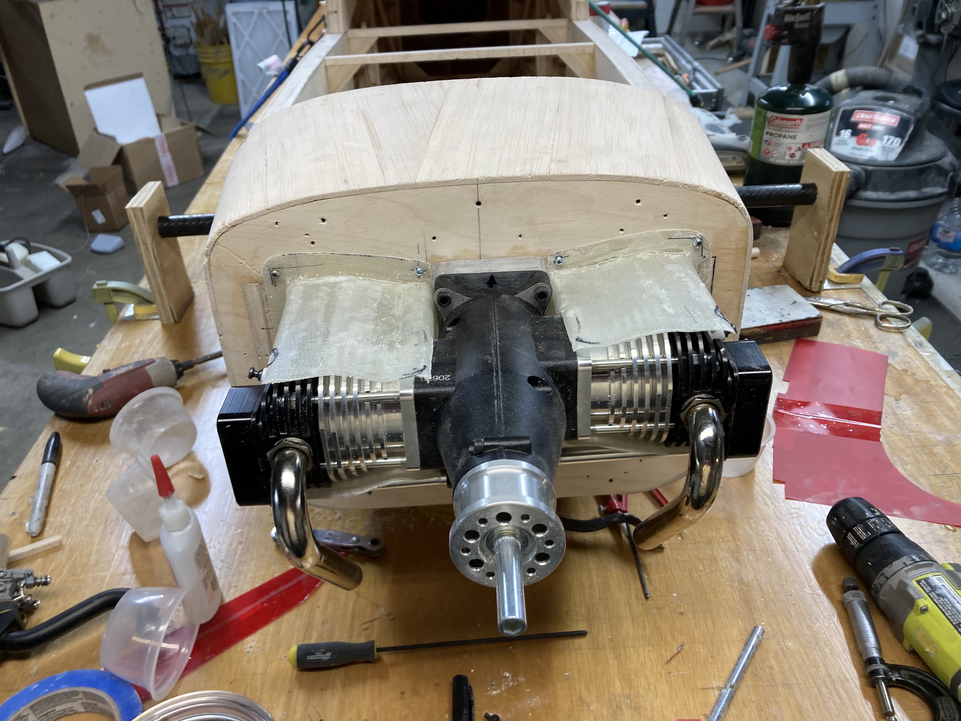

I hope to fly the Super Cub soon. I used the air dusts that were made for the 30% Cherokee before reverting back to a two stroke engine. The ducts of the Cherokee are shown on the bottom photo. The duct hugs to cylinder and the push rod tubes are on the cold side of the baffle. If this install behaves differently, I'm thinking I might try increasing the intake valve lash a little. Current settings are .004" intake/.008" exhaust. I'm theorizing that the aluminum cylinders cool quicker than the steel push rods housed in tubes providing an additional level of insulation. Aluminum has twice the rate of expansion of steel, is it possible the intake valve is held open?
