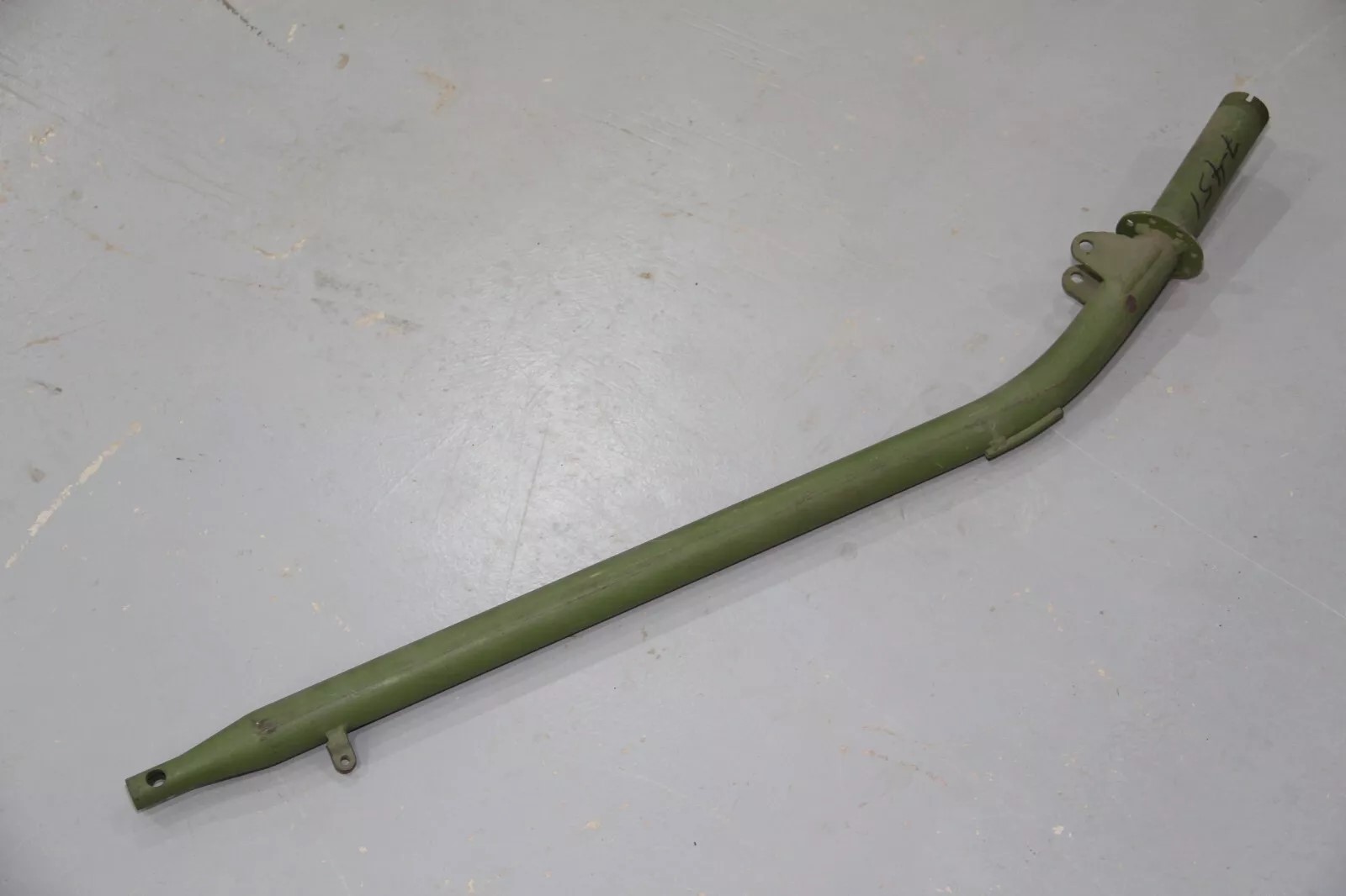

I'm using grade 8 1/4" bolts 4" long to fashion my axles, 130000 psi yield. The wheels are Dubro 5 1/2" foam tires, the wheels are very close to full scale tire proportions. The gear struts are 3/8" x .065" 4130 tube. I have a 3/8" spacer between the strut and the wheel. This space was left to add brake drums in the future. The threaded area is removed to make the axle, the axle is inserted about 2" into the strut and retained with a 1/8"roll pin. Looking at the full scale photo below I'm thinking that I might make the strut longer and eliminate the axle all together.

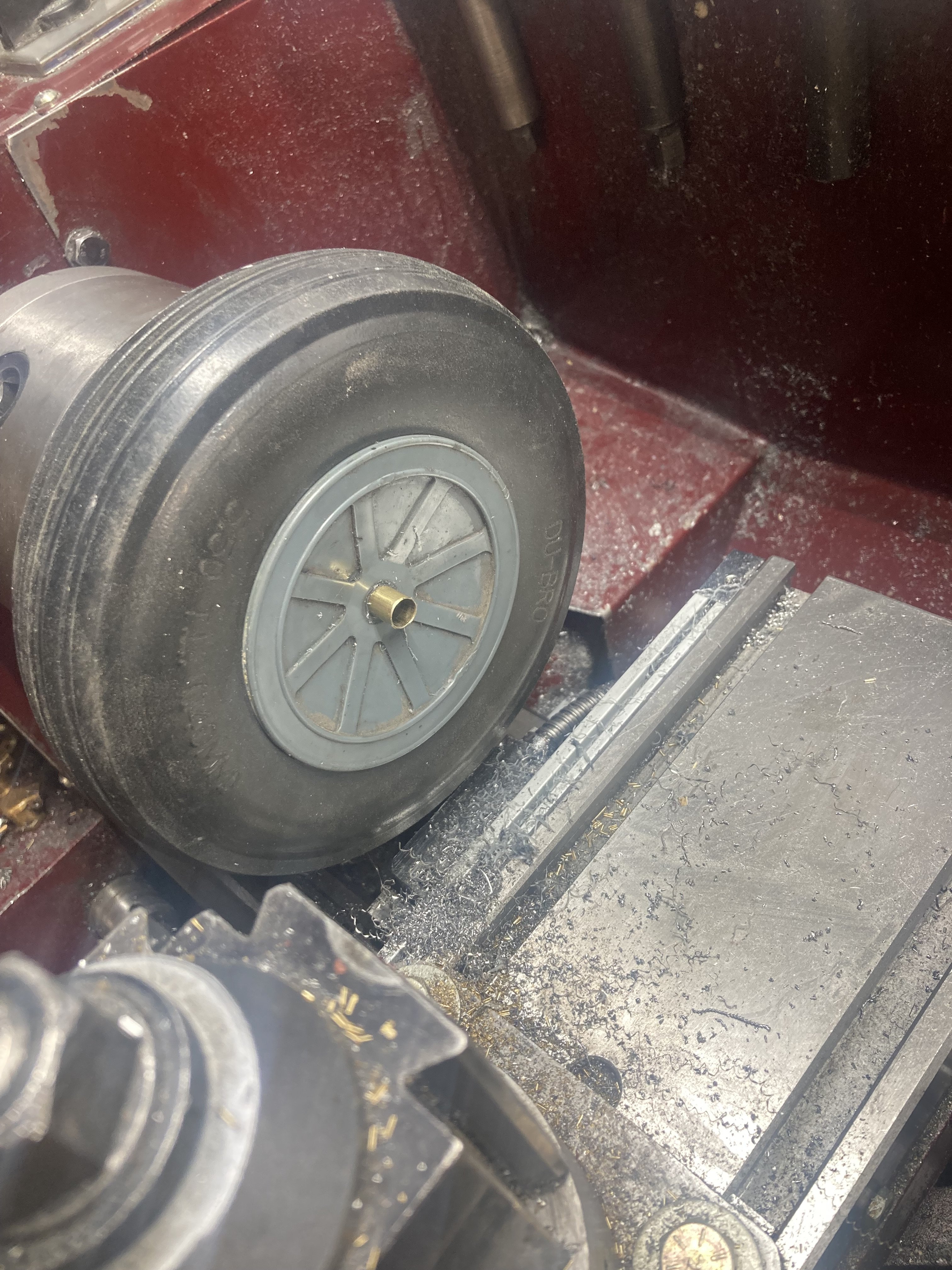

While the wheels were off I decided to bush the wheels with 9/32" OD K&S brass tube, the tubes were trimmed flush with the wheel in the photo below

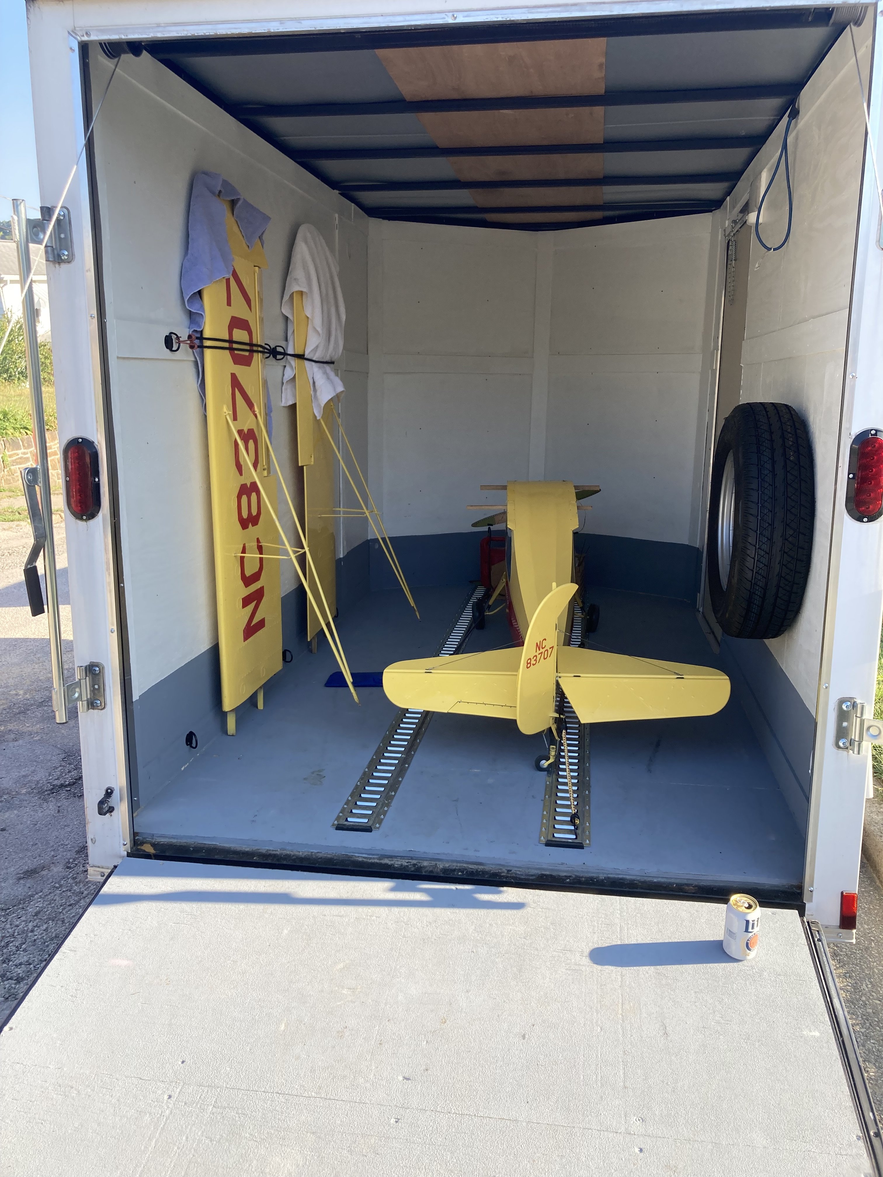

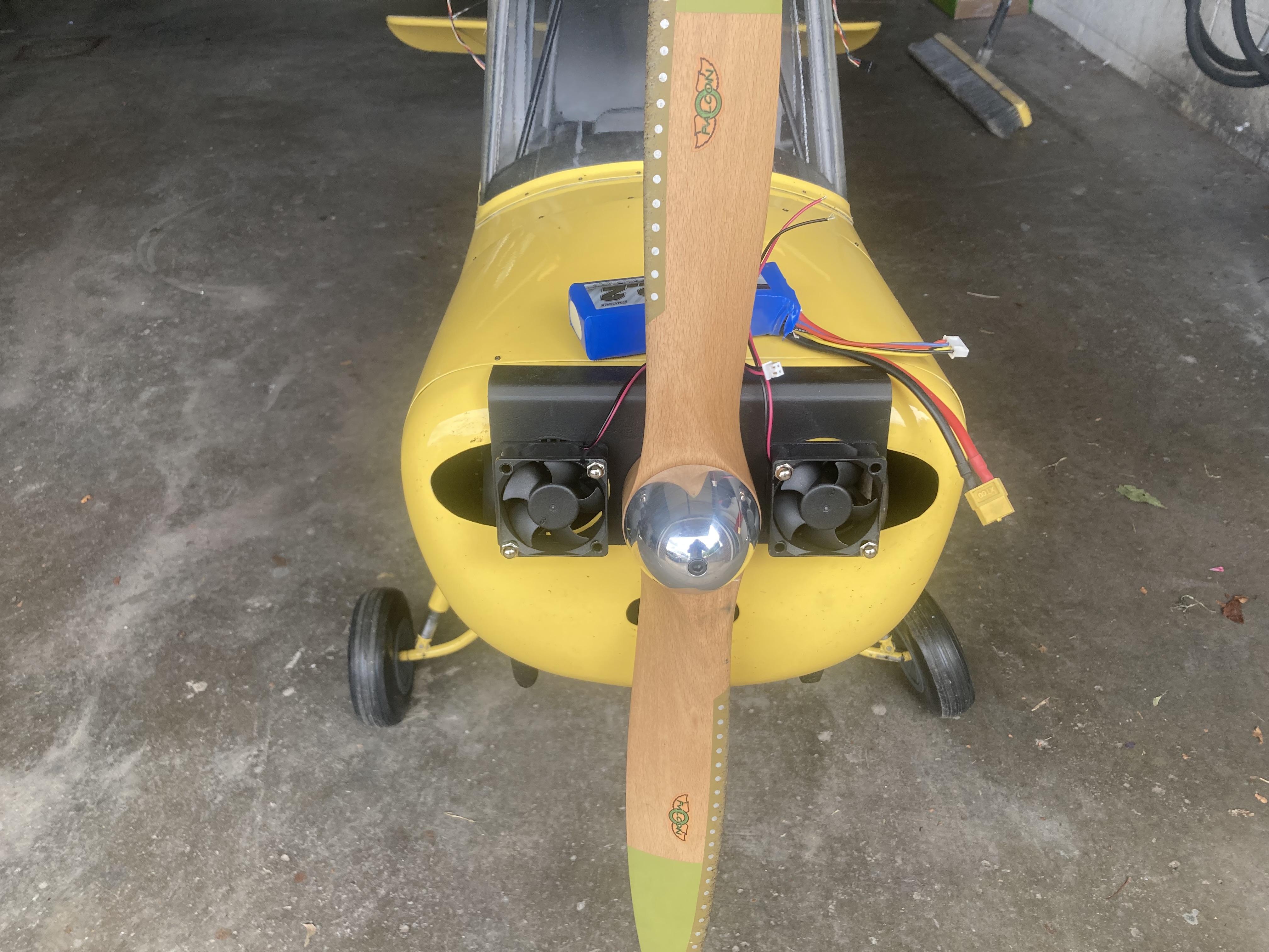

Flew maybe 6 flights today, spent two flights trying to get the 2 wheel landing down pat, gave up and when back to 3 point landings. The fans work awesome. I have eliminated the aileron rudder mix and use the rudder for turning while using opposite aileron to control the bank. Changed all other other mixes I had with throttle to rudder or elevator. Hopefully my scores will be better. Entering the Champ into the 513 scale judging this week end, will see how it does. I think there were a few cancelations to NASA Fall Classic so there might not be many contestants entered. Got one more day to practice before the event on Friday. Six days in a row at the airfield, what a life! The rear end when out on my 2003 GMC Safari Aircraft Carrier, had to borrow a trailer and a SUV from my sister and her husband. Thank you Annette and Danny. I think the only they haul in the trailer are motorized bar stools!
