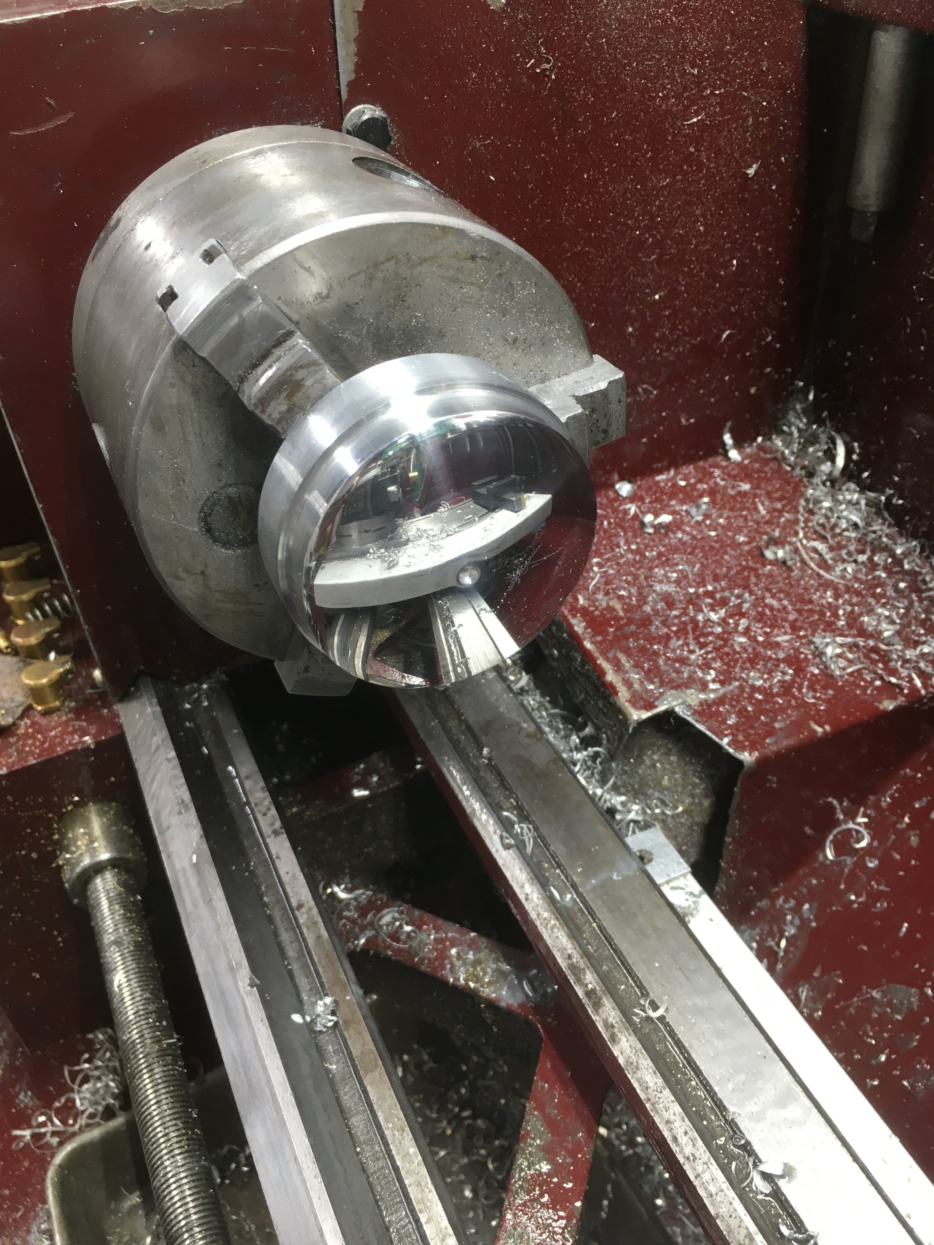

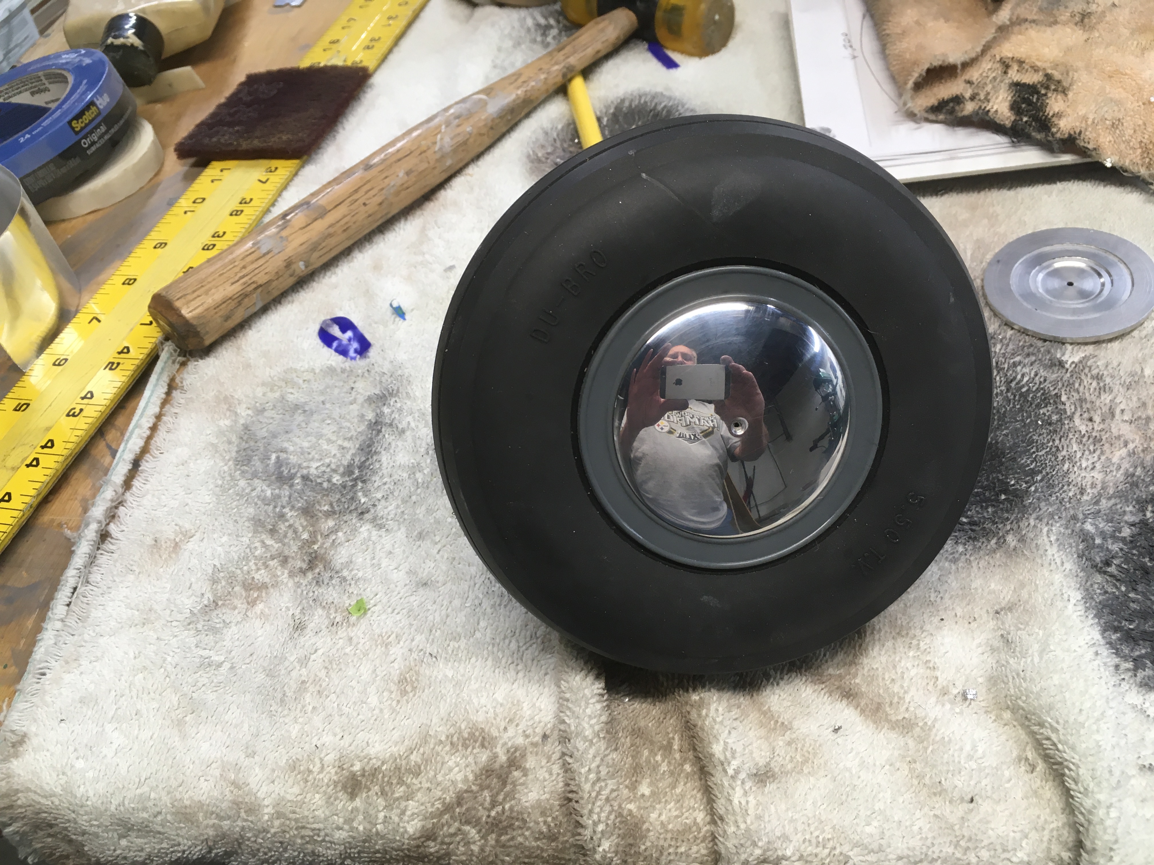

Did a little lathe work tonight. Going to put the first hub cap I made a while ago in the prototype bucket, this one is much better, I bought 1" long disc this time around and it worked out better because the part was held better and I learned from the mistakes made on the first one. I started with 1/2" long disc before. The tire is still holding air so I'm happy with it now. Pretty sure two Monoeject tubes of Slime was excessive but it's too late now. Orange paint tomorrow, if all goes well can begin the final assembly.
