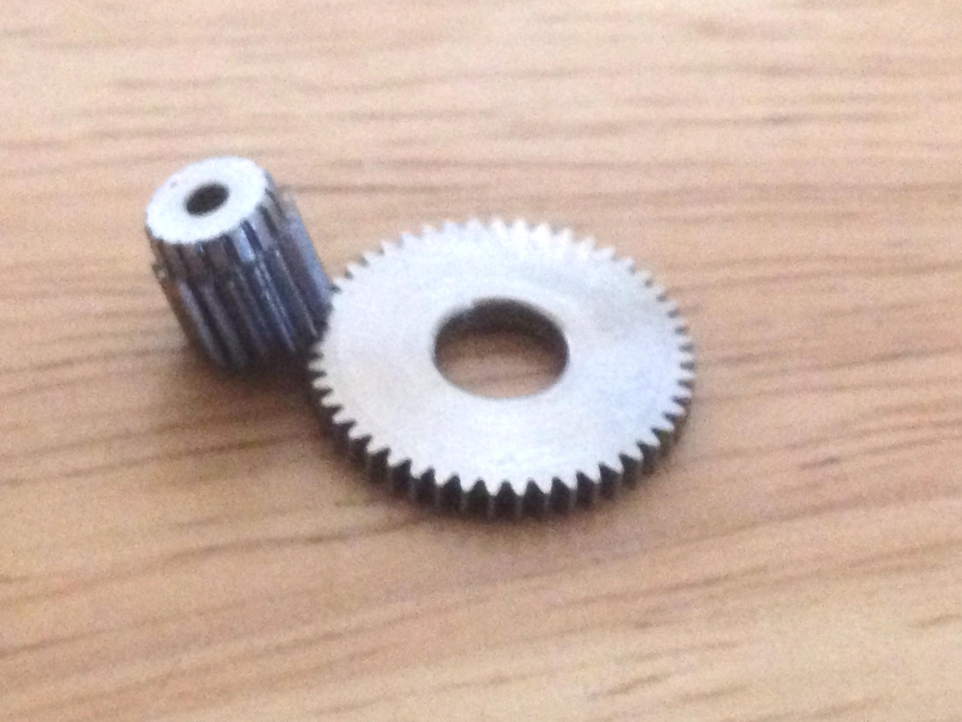

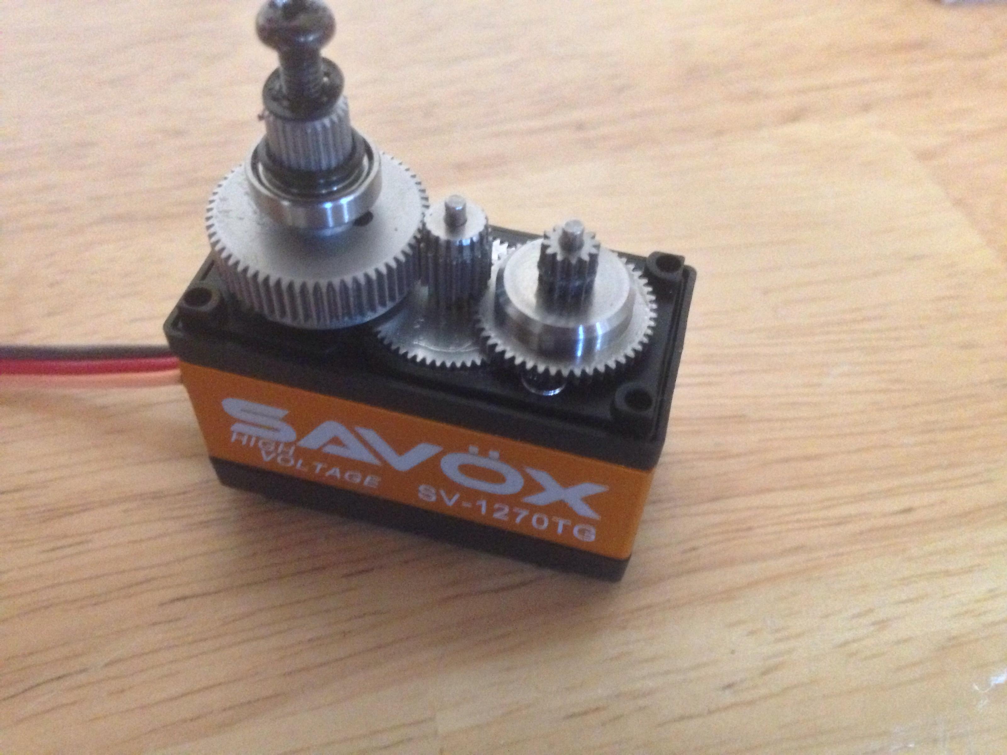

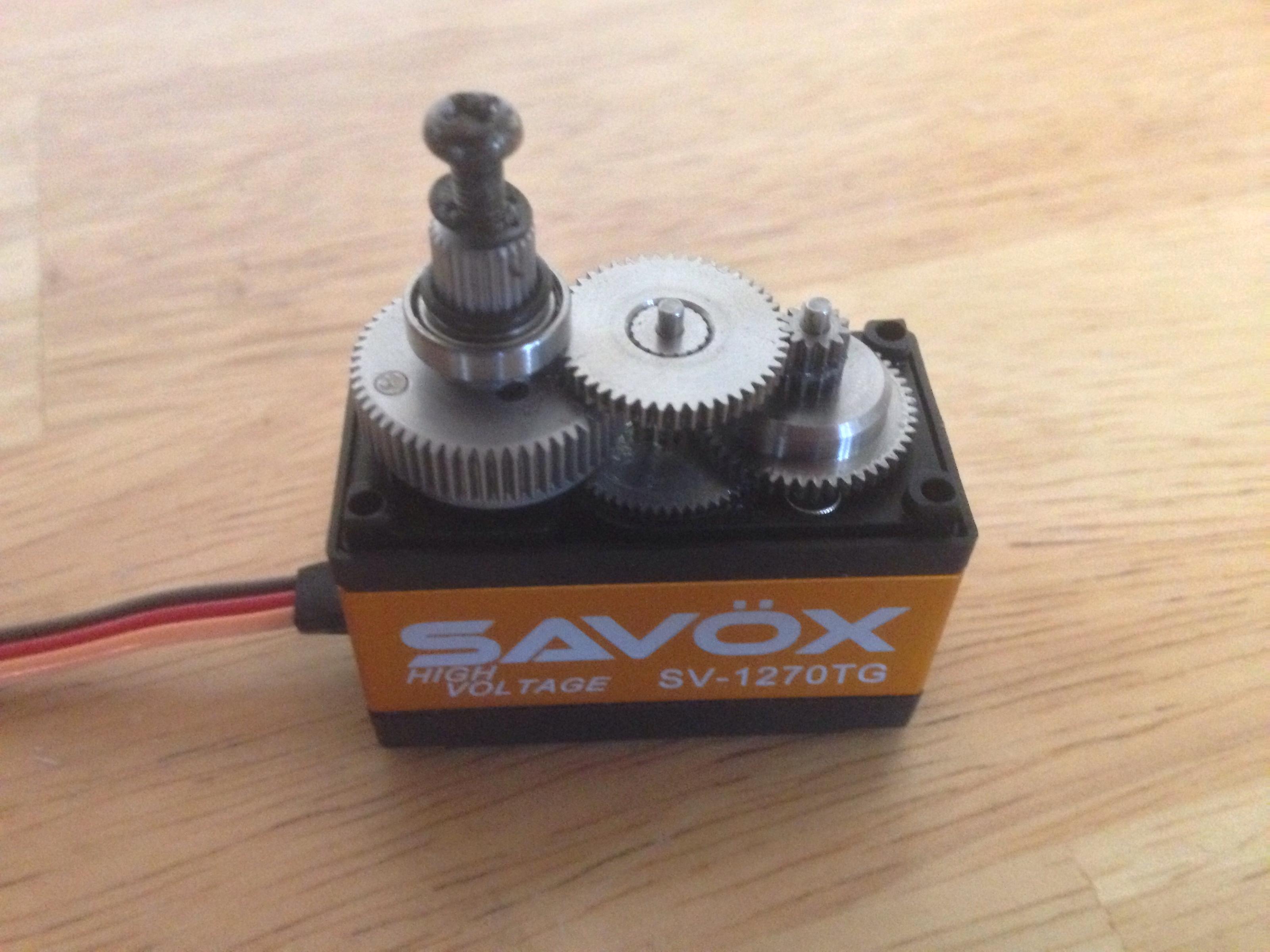

Xpress
The Savox 1270TG has a known issue where one of the gear is 2 pieces pressed together.
This may be your issue.
If you don't want to use Savox servos anymore but want to keep your SWB hardware then I suggest checking out the Hitec HSB9380 servo. 25t spline (same as Futaba) but ultra efficient and more powerful than any digital coreless servo.
