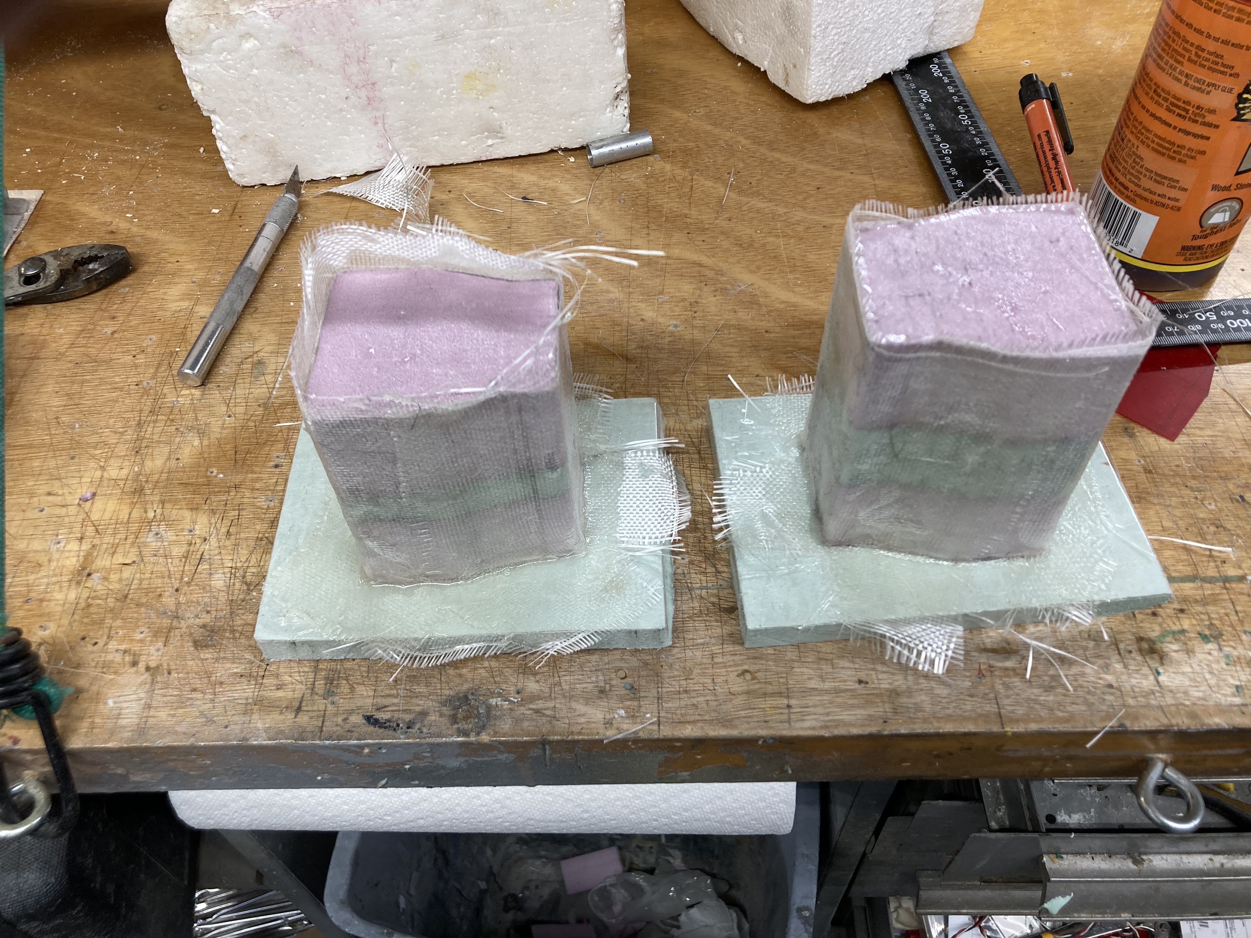

Made the cooling ducts for the cylinders today. The foam was band sawed out and covered with packing tape, will see how much trouble I have getting the foam out. These will be mounted to the firewall and cover about 70% of the cylinders.

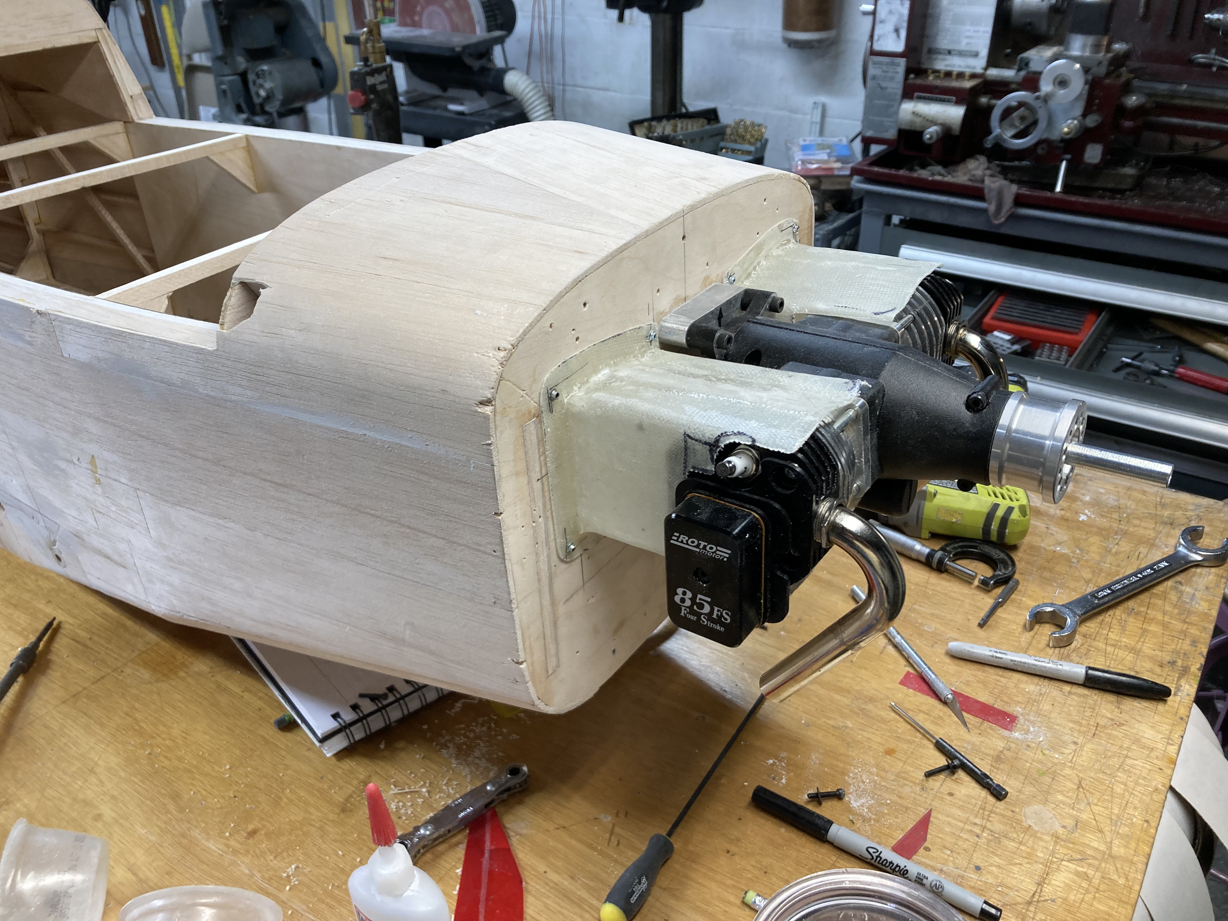

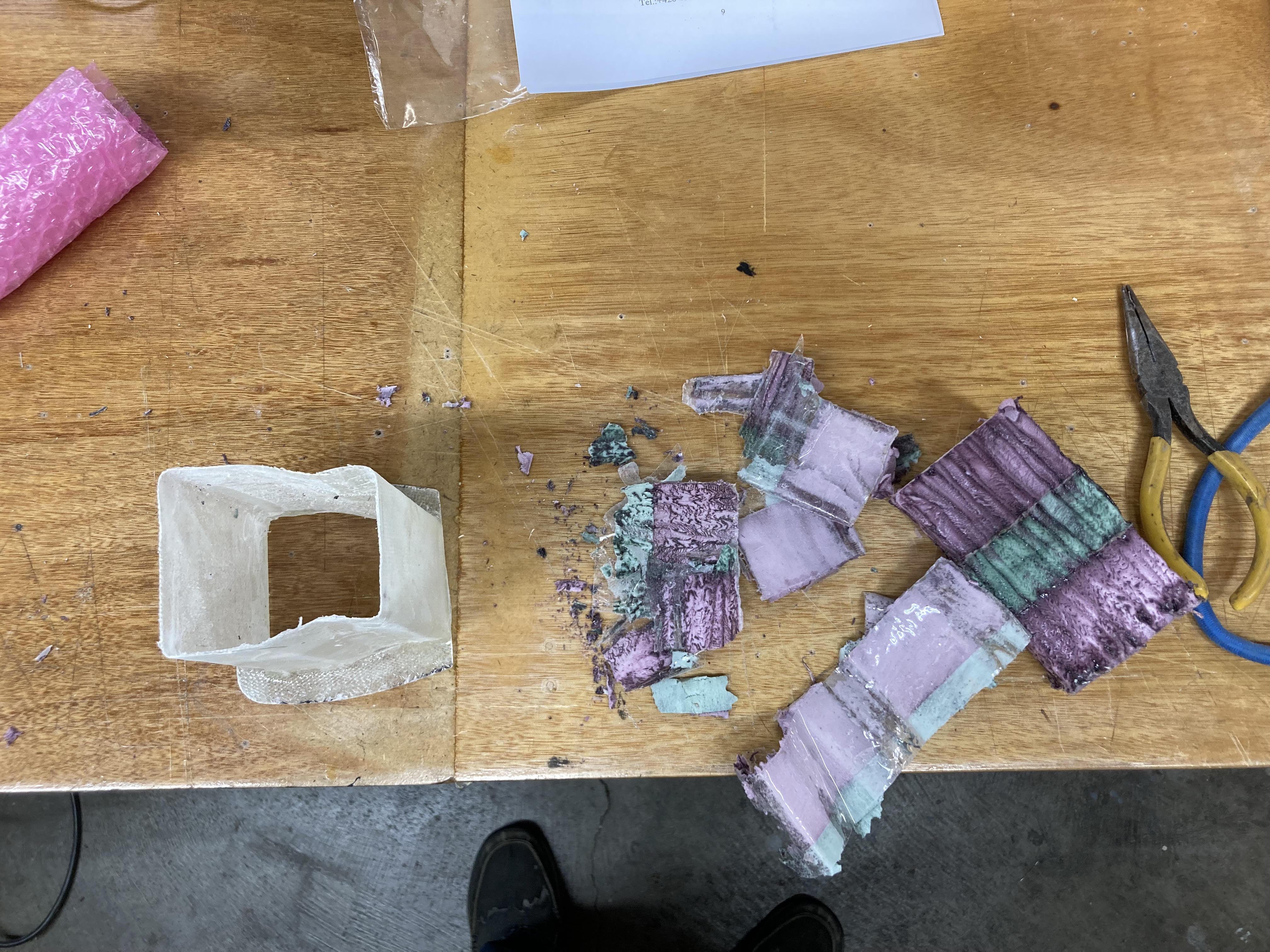

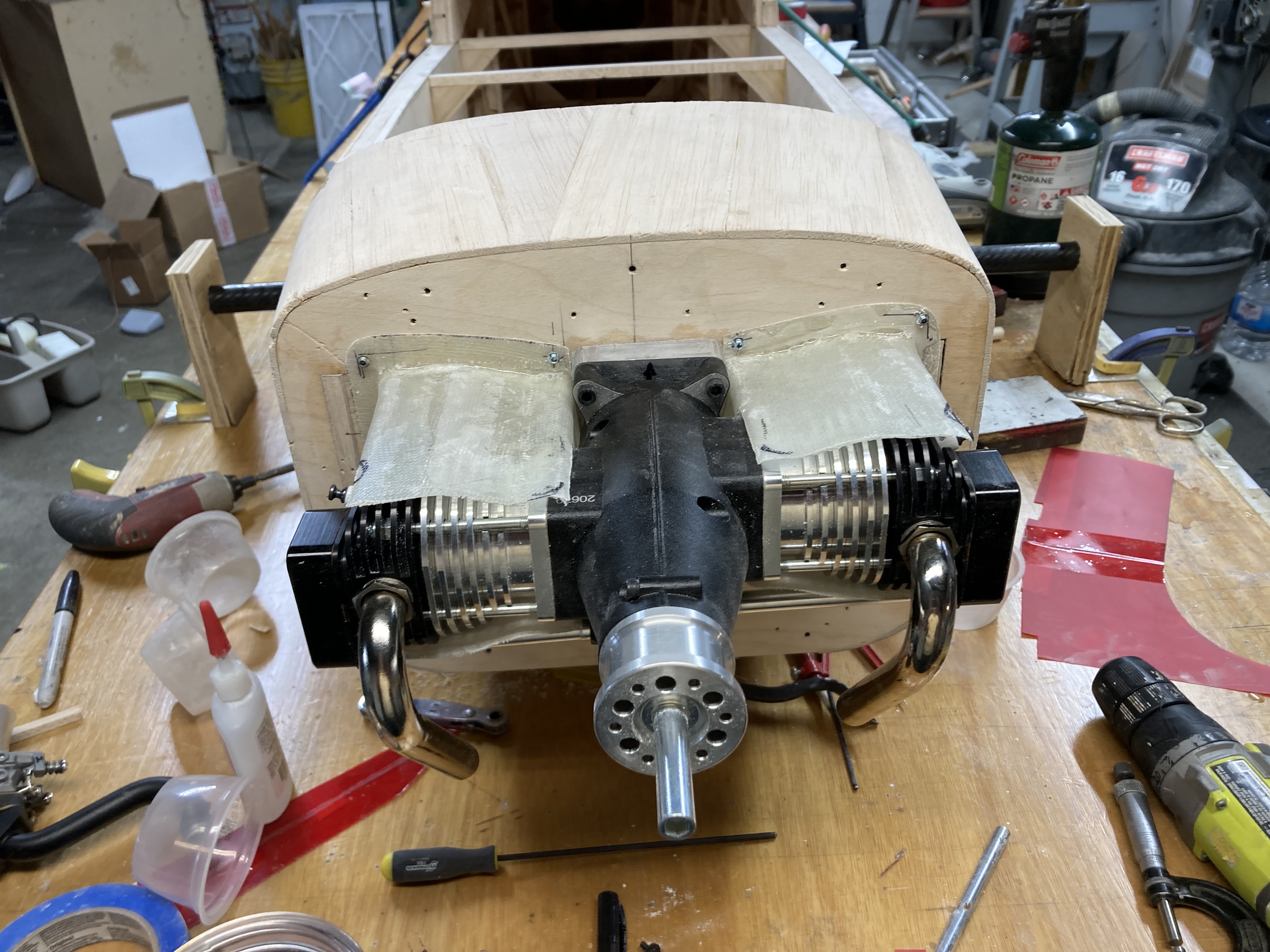

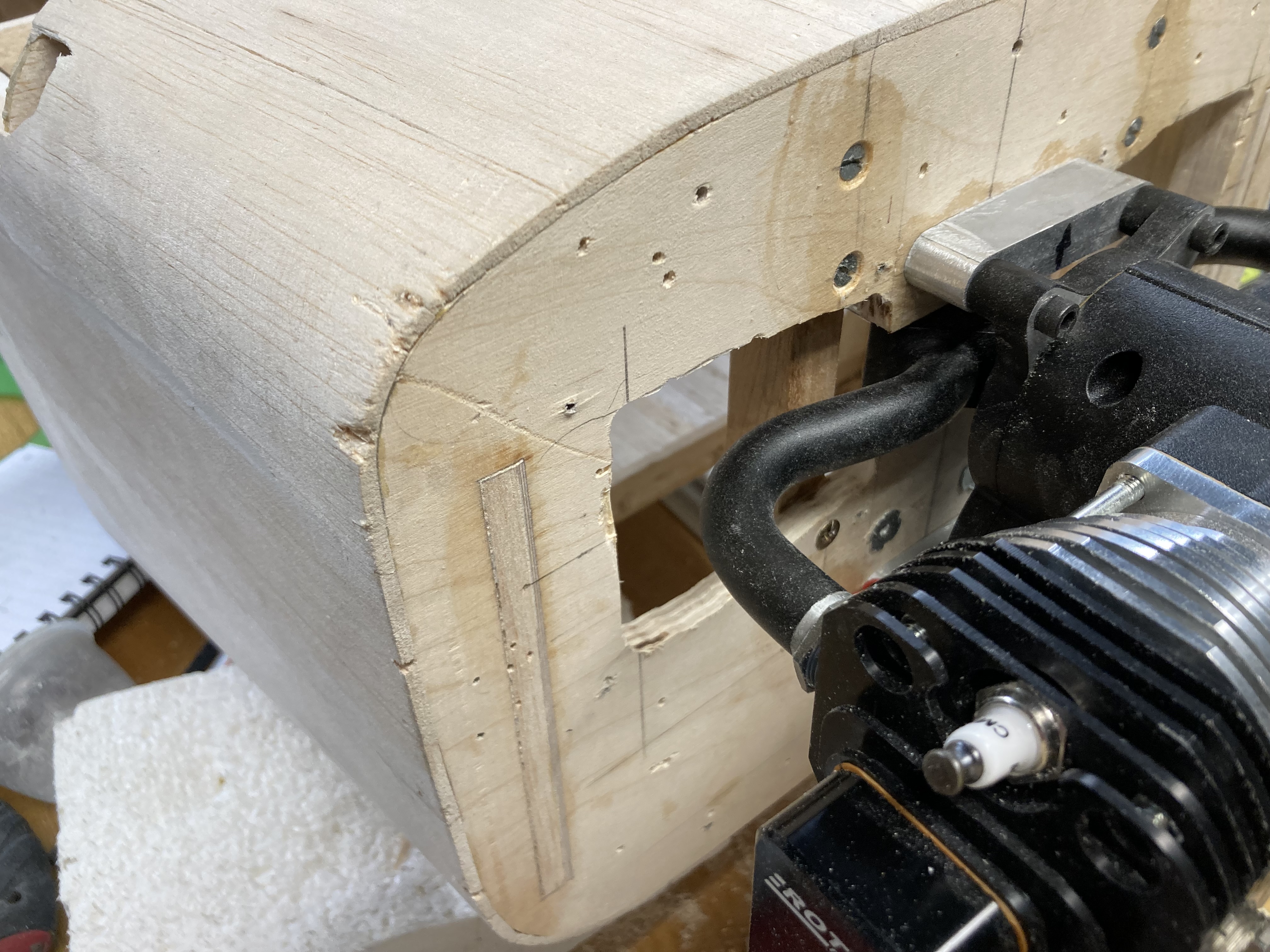

Worked on the engine cooling today. Heated a 1/4" rod with a propane torch and melted out most of the form. Then picked the tape off. I had attached the glass cloth to the form with contact cement so it took a little effort to remove all the tape. Marked the firewall where the ducts land an next I need to cut the openings. Should be fun since the firewall is 3/8" thick. The carburetor will need to be removed to insert the engine through the firewall.

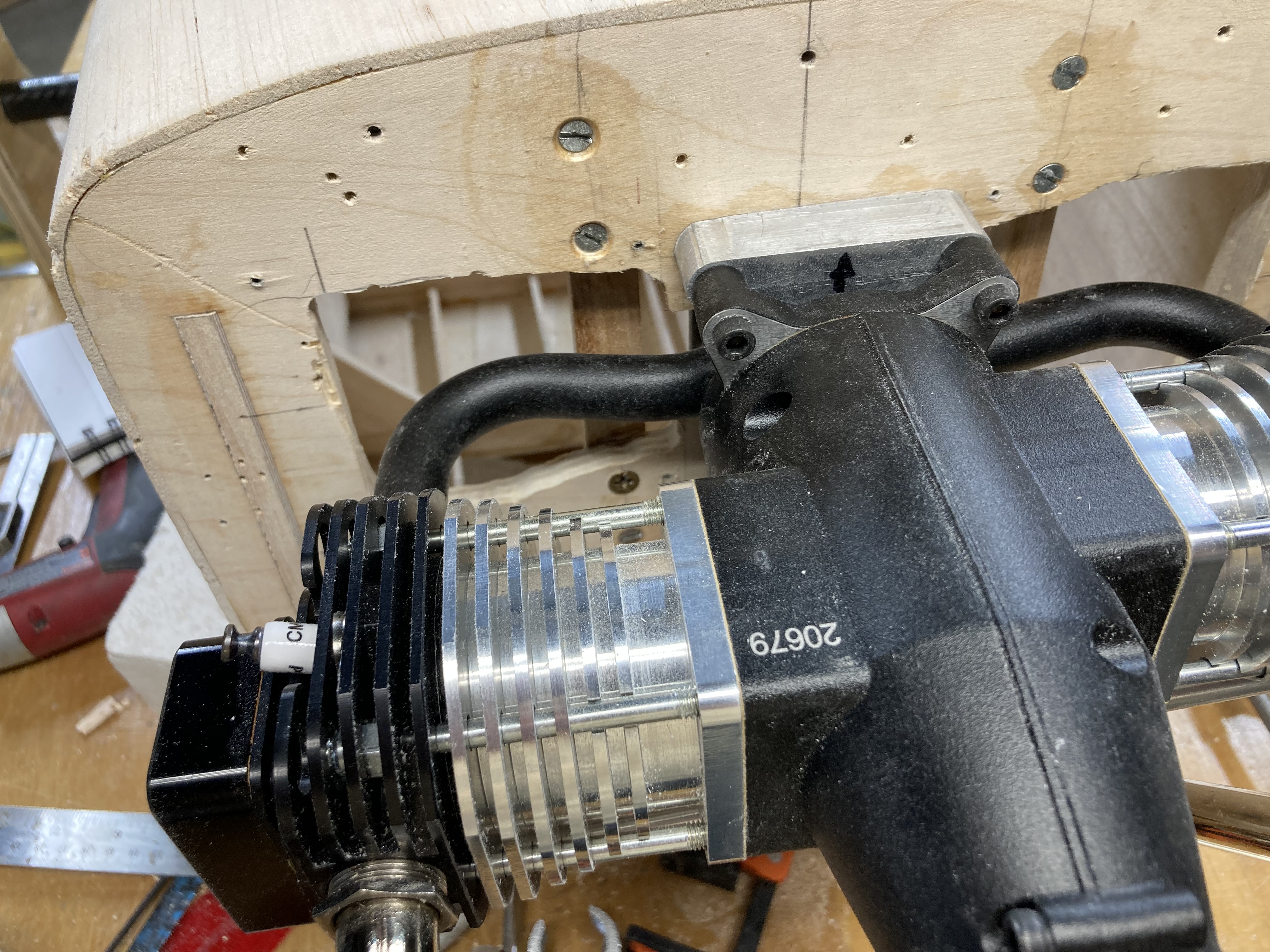

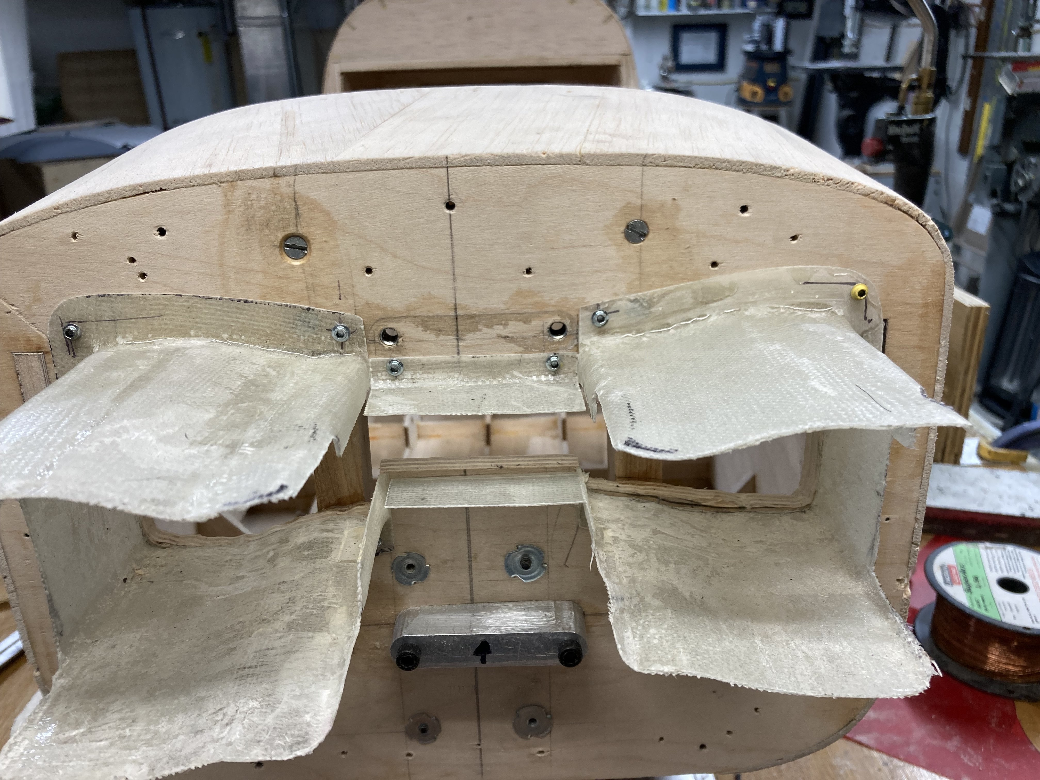

Decided to put in 2 back braces to restore some rigidity to the firewall after cutting the hole for cooling and intake manifold clearance. Used 5/8" x 3/4" maple motor mount stock for the braces, these are screwed and epoxied in place on each side of the carburetor. Also laid up some glass angle that will form a "sneak by" baffle between the two ducts. Time to start thinking about linkage.

The final baffles are installed.
