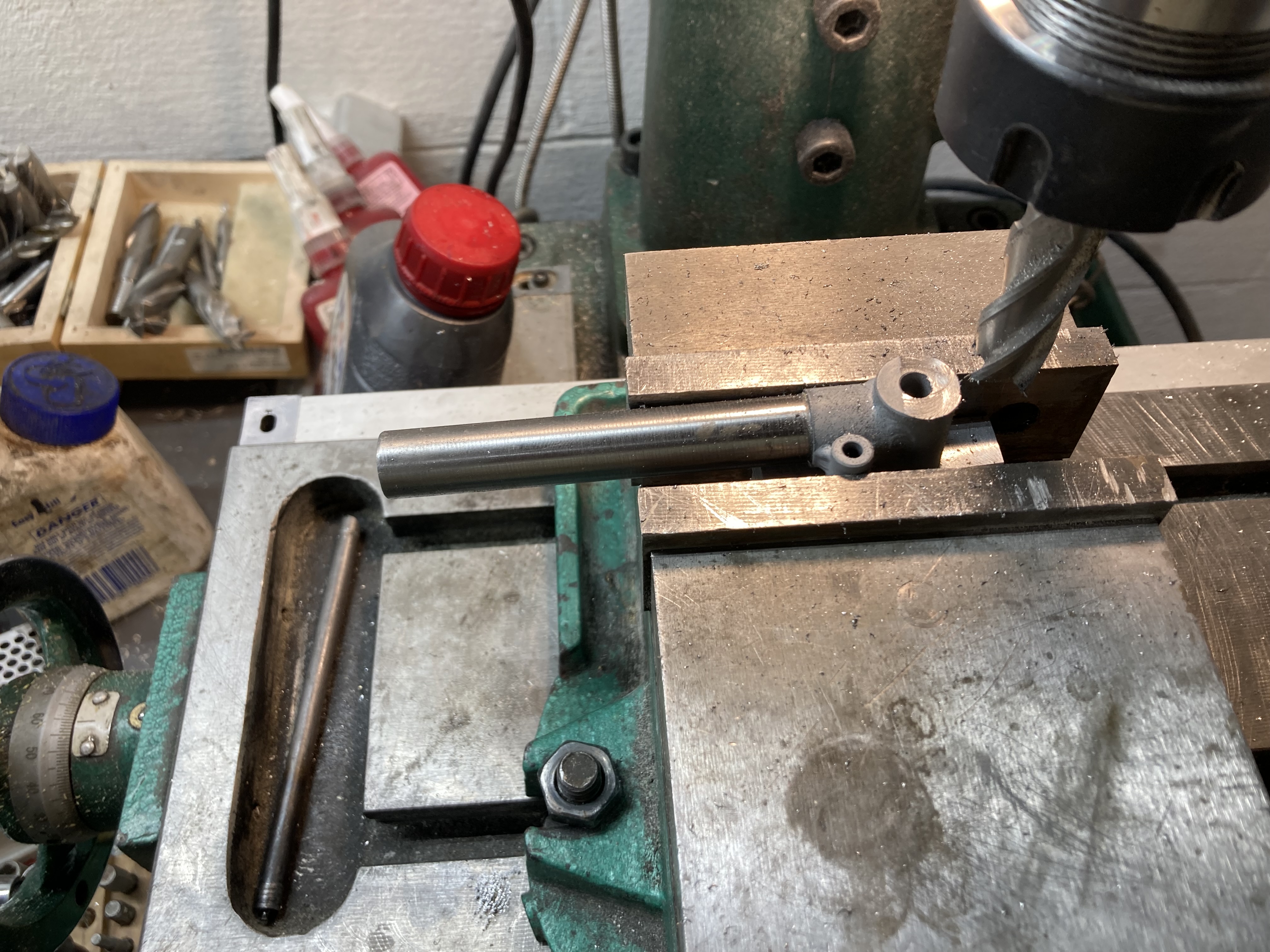

No problem, it was time for some mill work anyway. Working on the main gear struts. The struts are angled outward 3 degrees off the vertical and I wanted the wheel pants to look right. While studying the Robart site I came across these struts for a GP Chipmunk, I thought the mounting flanges would be the way to mount the pants on the Cherokee. Milled a piece of 1/2" aluminum scrap on a 3 degree angle to setup the Oleo ram on the correct angle and then milled the angle on the ram. I plan to use a 1/4" fender washer as the flange.

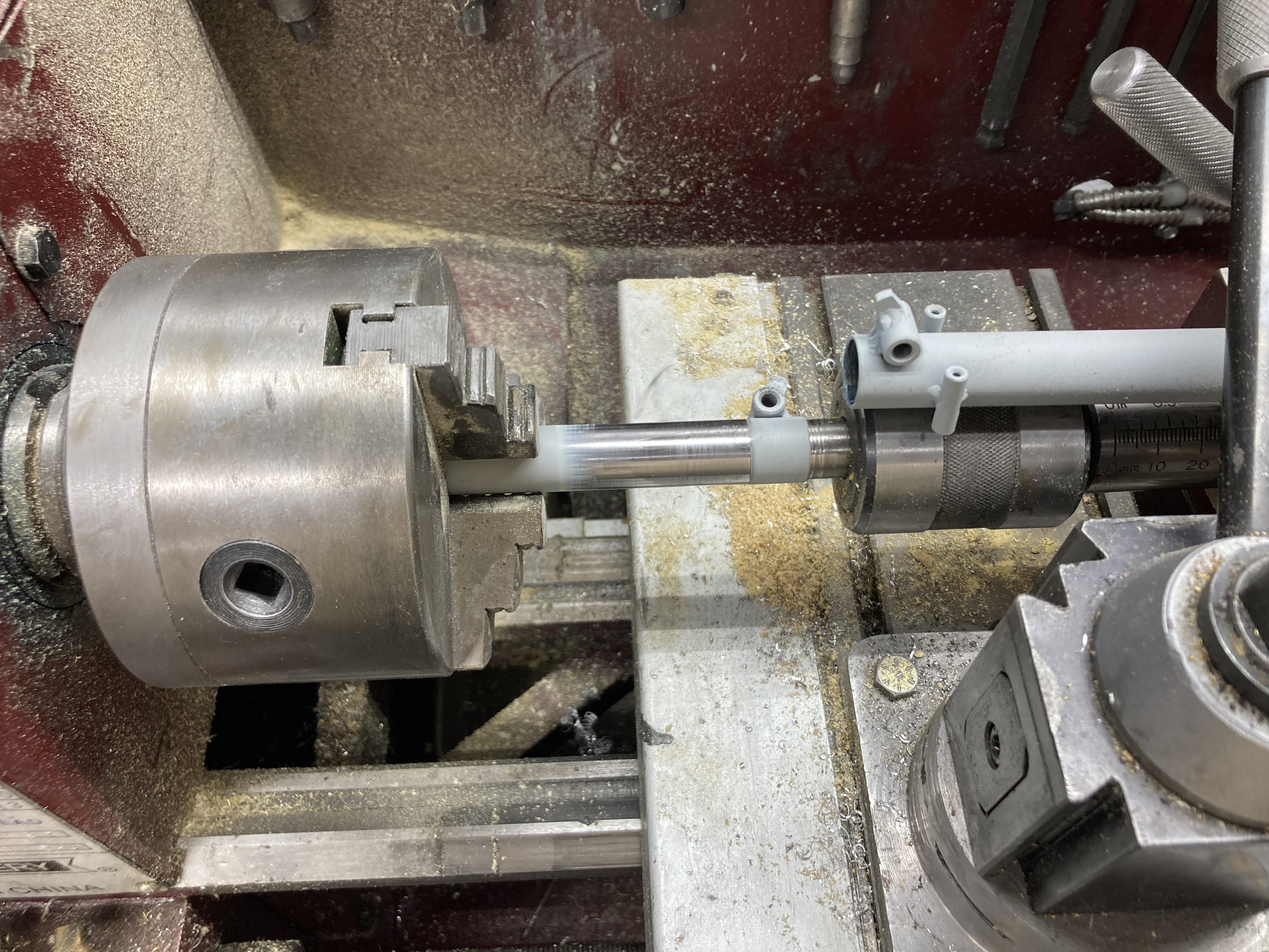

Had to remove pesky little tubes welded to the strut tube as well. Never did determine what they are used for.
