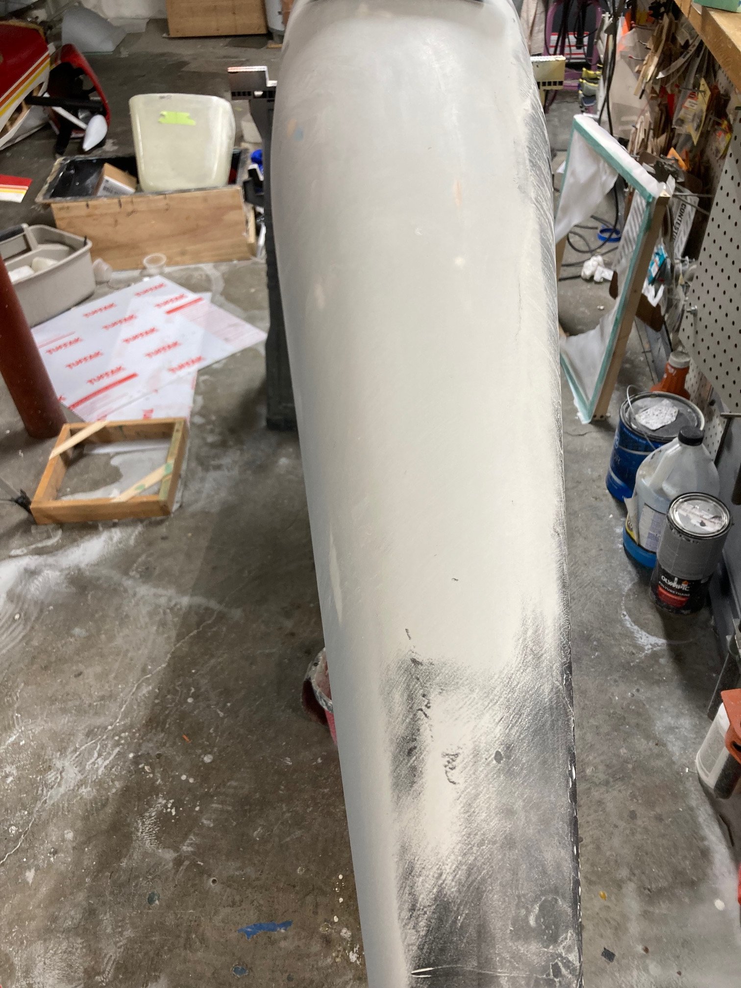

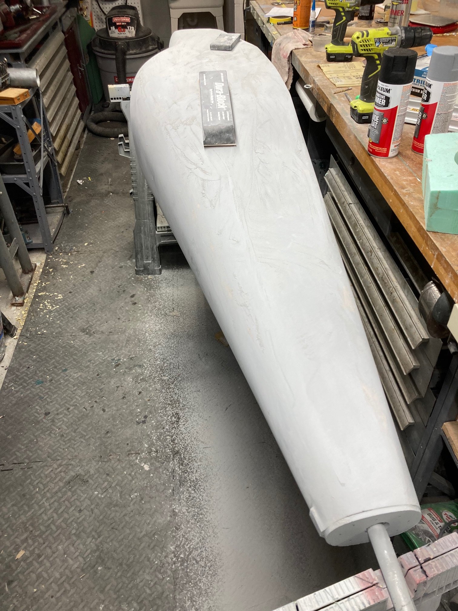

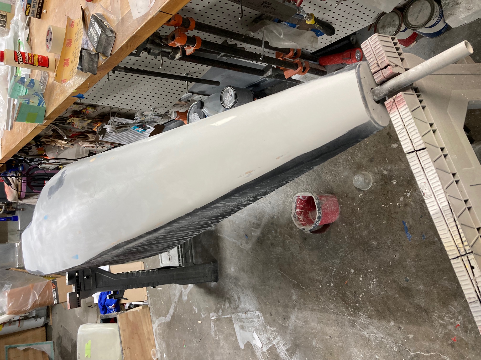

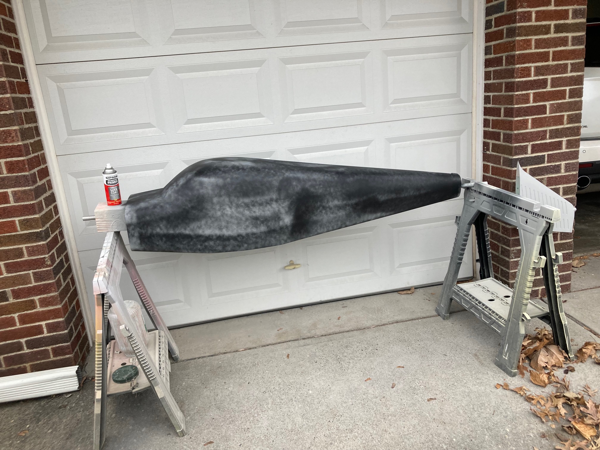

Block sanded the fuselage this morning with Durablocks and 220 dry paper. I'm thinking it is about 95% at the point. Most of the areas where the glass cloth overlapped are gone. A couple of low areas still exist that should be filled with the primer. I'll hit those first before priming the entire fuselage. Funny thing this primer is Rustoleum automobile primer out of a gallon can, it sands so much better than the rattle can automobile primer.
Rain until 1300 today, hope to lay down three more coats after the rain quits.

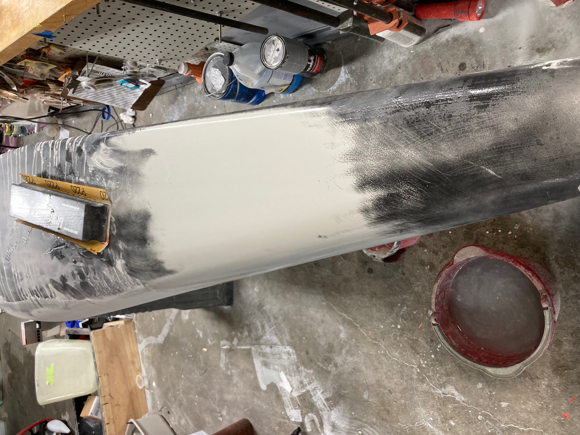

What do you use as a guid coat. I have all ways used grey and white primer over one another.
Ok question do you just keep sanding till the black is gone. Or just sand enough to show all the imperfections, spot putty sand and then another coat of primer and start again.
TonyHallo

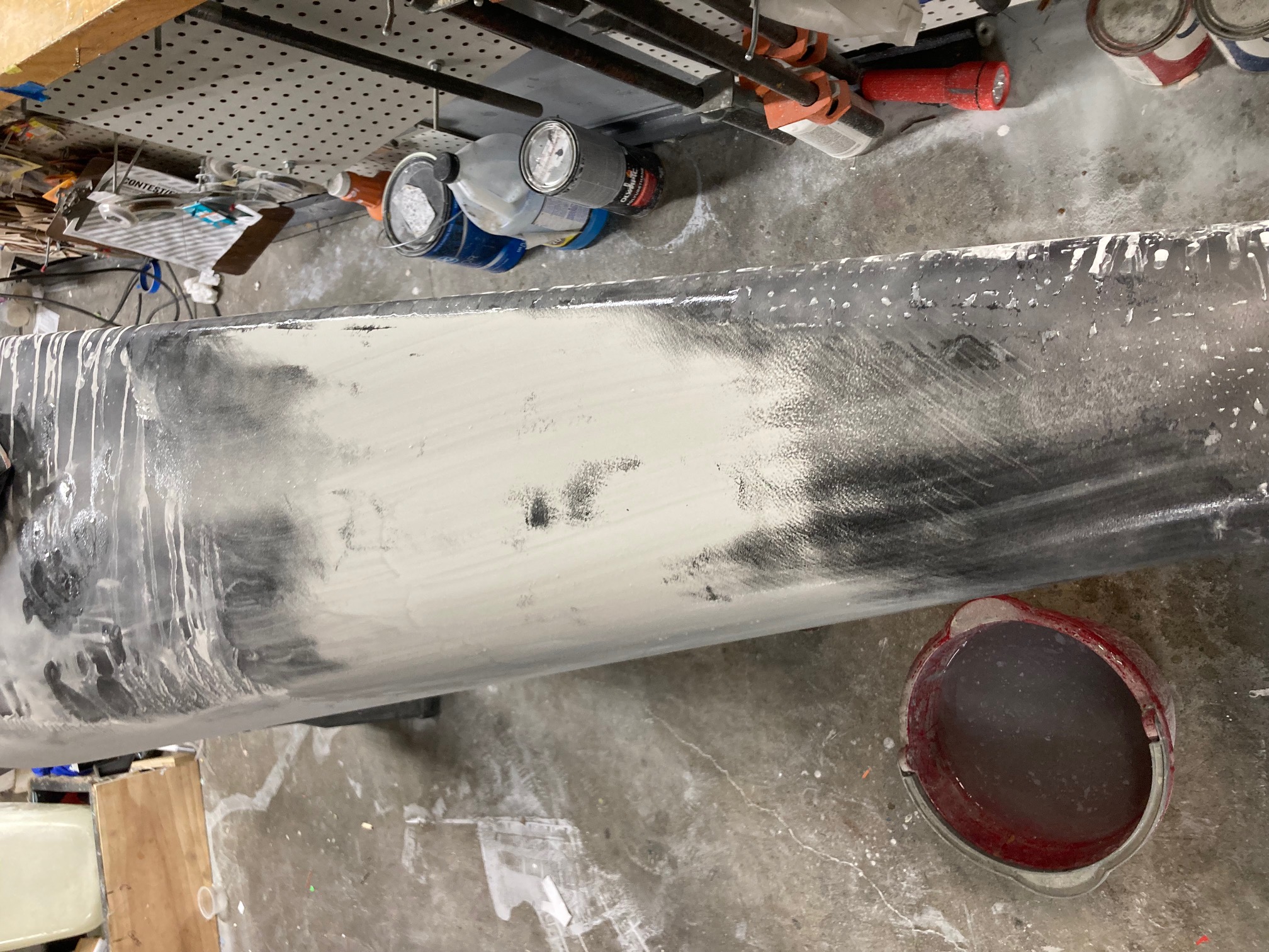

Yes, that is ideal. Here's a quick patch this morning, you can see the low spots in the middle of the area and the black line in the upper left side where the cloth overlapped. More sanding and they both disappear On the large areas I'm using 1/2 sheet size Durabloc with 220 wet paper. So far the not need for spot putty but I still need to do the right side and the bottom
Ok you and I do the same thing just keep sanding until it is all smooth and flat with out going into the glass.
How do you like the DuraBlock is it worth money and does it work well. Always looking at them but always think for the round shapes of a cowl and contours that we have that it is to stiff, is my impression right or wrong.
