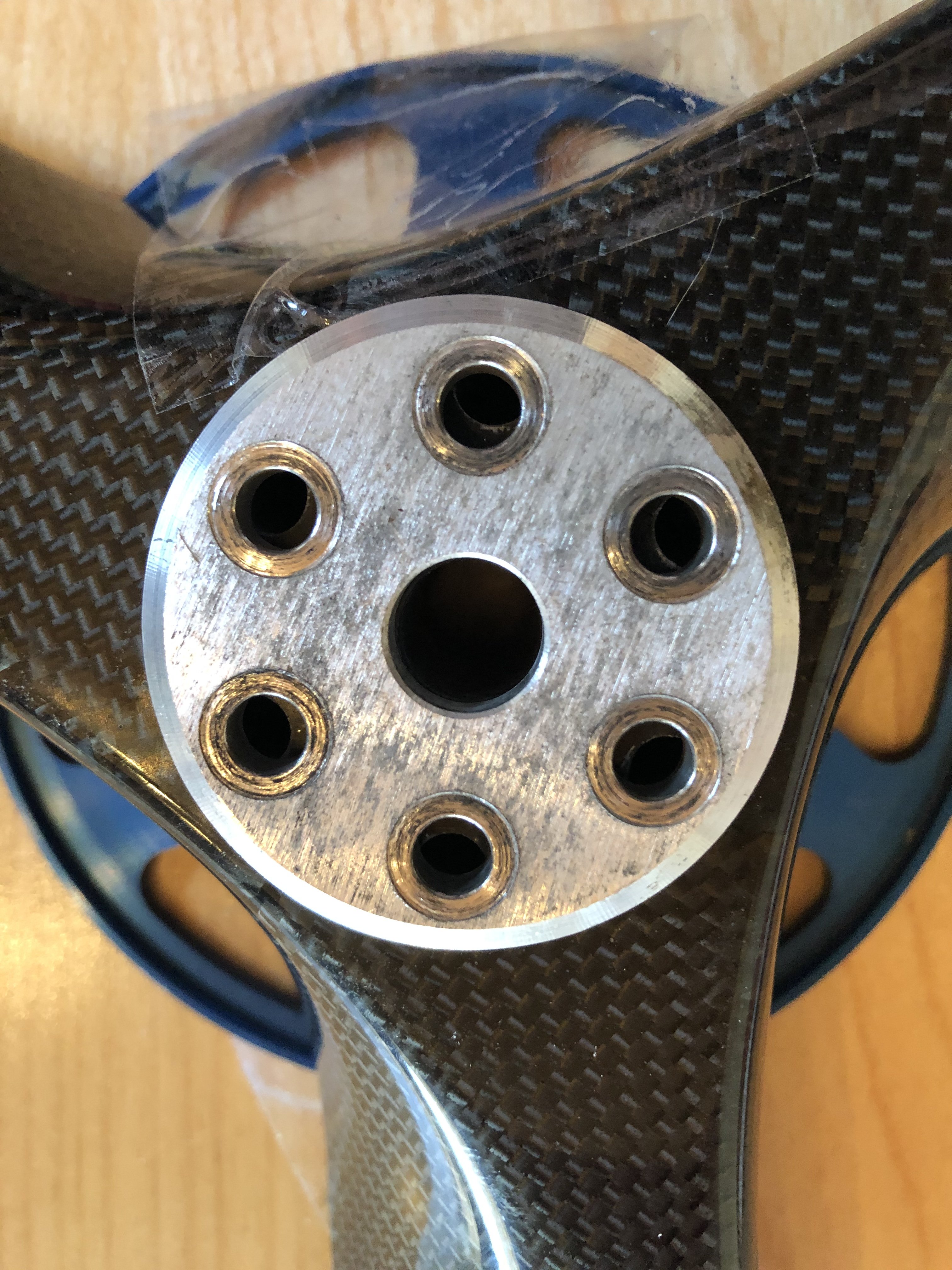

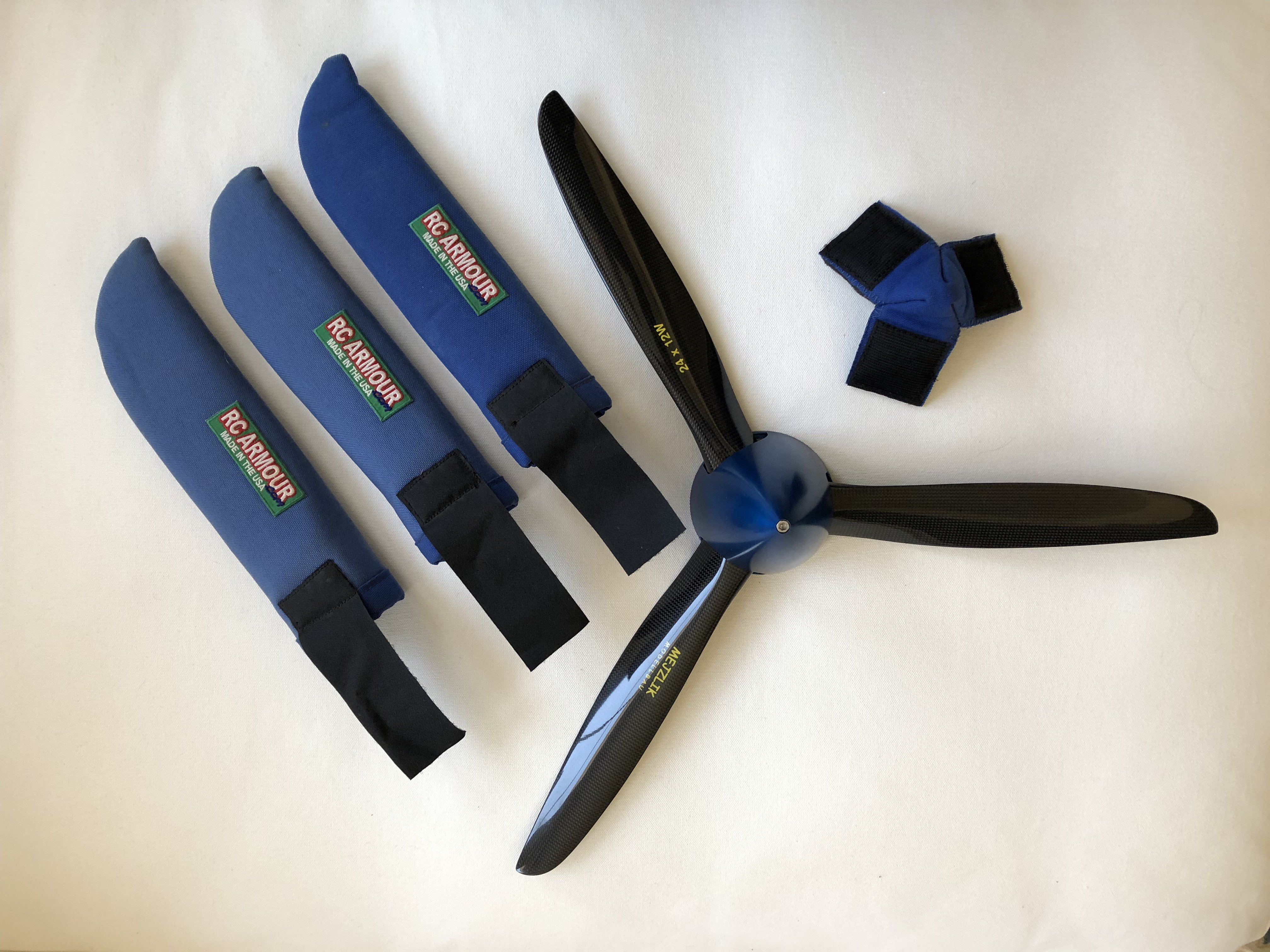

Do know what it does fit. Man that is unfortunate.Unfortunately, the excitement was short lived. Good news is the prop and spinner are gorgeous. Bad news is that they won’t fit the DA-100 on the Python. Hole circle diameter is too large. Anyone need a Mejzlik 24 x 12W and a spinner to match?

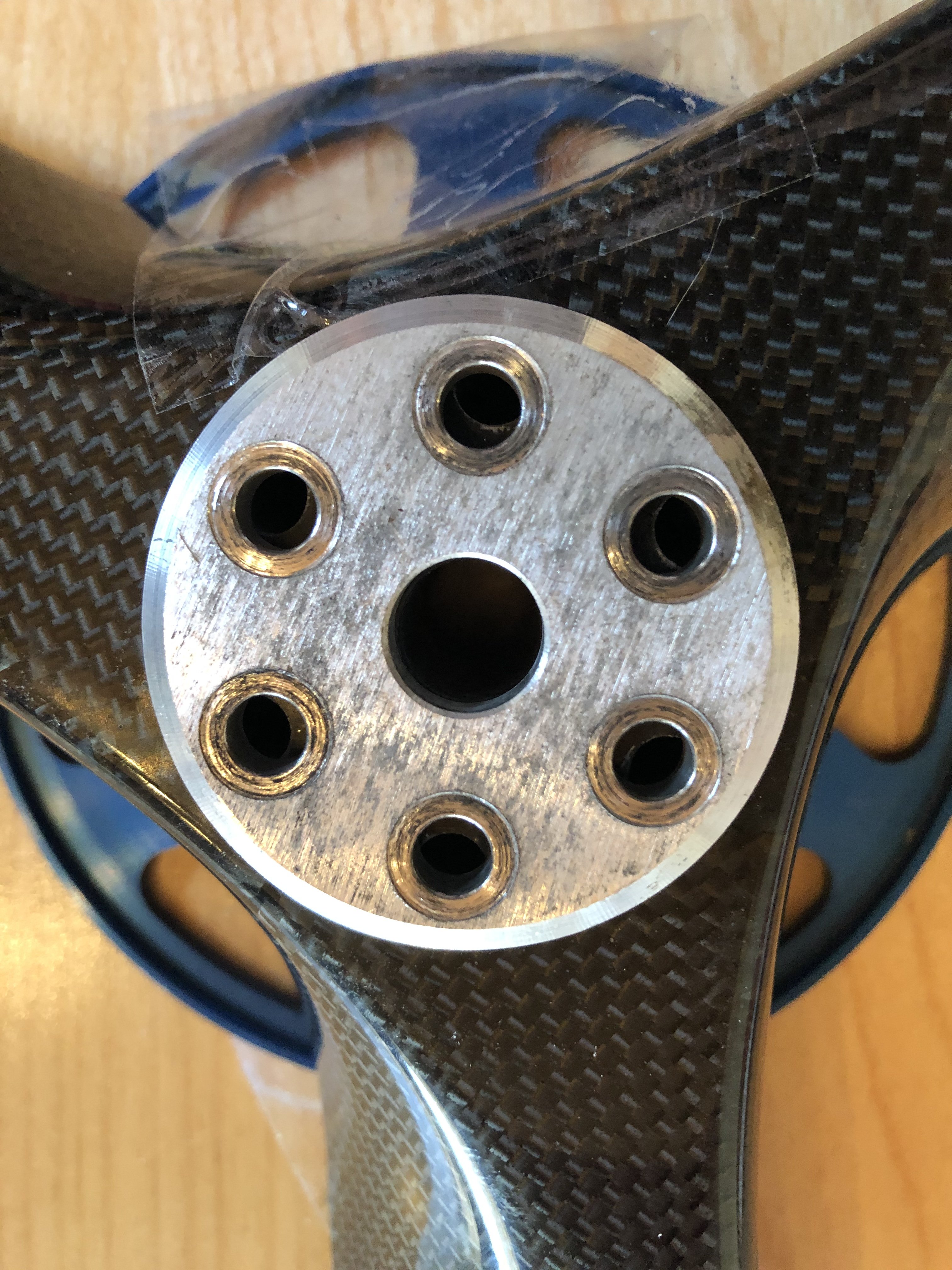

Bolt circle measures 34mm. The DA-100 is 29mm.Do know what it does fit. Man that is unfortunate.
Being that bolt hole offset is only about 2.5mm from respective centers why couldn't you just fill the existing holes with epoxy and drill to the DA pattern? Do the same thing to the spinner back plate but use "JB weld" instead of epoxy. I know many would rather not but it really wont weaken the prop or backplate. Just make sure when you drill the new holes they line up with the old holes.
I have done this a time or two but used dowels on the prop. JB Weld makes an aluminum epoxy, it does work rather well and when assembled the prop hub and prop sandwich the backplate so it is even more secured.Being that bolt hole offset is only about 2.5mm from respective centers why couldn't you just fill the existing holes with epoxy and drill to the DA pattern? Do the same thing to the spinner back plate but use "JB weld" instead of epoxy. I know many would rather not but it really wont weaken the prop or backplate. Just make sure when you drill the new holes they line up with the old holes.
