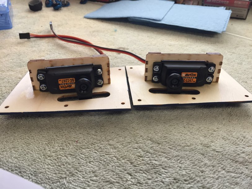

Based on [MENTION=3]GYRO[/MENTION] and others I changed up my rudder servo setup to a single HS-M7790TH with a Seacraft servo tray. This monster has 610in-oz. But have seen a test on TBM that shows it pulling a little less than 500in-oz. Regardless for a single rudder servo on this plane it should be good enough.
Nice plan! Those servos are monsters, but you should be able to mount nicely on the huge double rudder tray without much work.
Please take a few pics of it and how you install it :)
Yowzilla
List is almost as much as 2 good servos at $175 with the single servo tray all in it is around $300, but this time of year I did not pay that exactly.
Madinpensacola
Cool. I've resisted those purely because of the extra weight behind the usual CG point versus 2 servos. Will look at that one and continue my comparisons. :)
Yowzilla
Not sure I get your logic. The HS-M7990TH is only 10 more grams or 10% heavier than a 2270. Two 2270s at 140 grams are heavier than the 79 grams of the Hitec.
I think the Hitec may be a negative because of the lack of weight if you like to hover around and generate good tail inertia for pop tops. But in a plane of this size a few grams here and there most likely will not impact CG that much.
