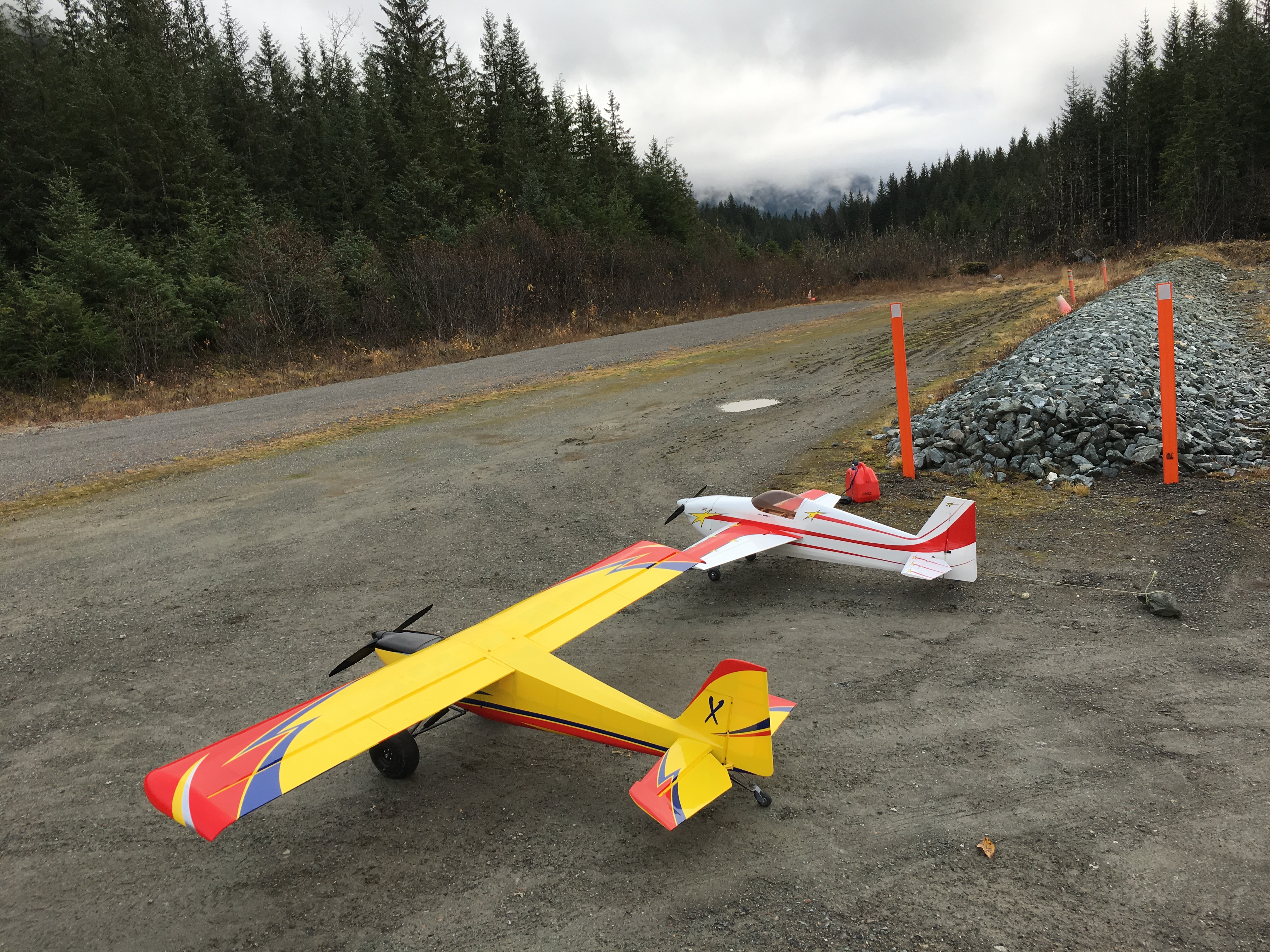

Logged a couple more flights on the timber this afternoon.
Flew inverted and one of my wing MPX connectors popped loose. Not crazy flying either. This is the second time, so I’ll need to take it out of the hard mount or figure something else out. Noticed it when I was coming in for a landing and the left flap didn’t come down, luckily I figured it out quickly and landed without any issues.

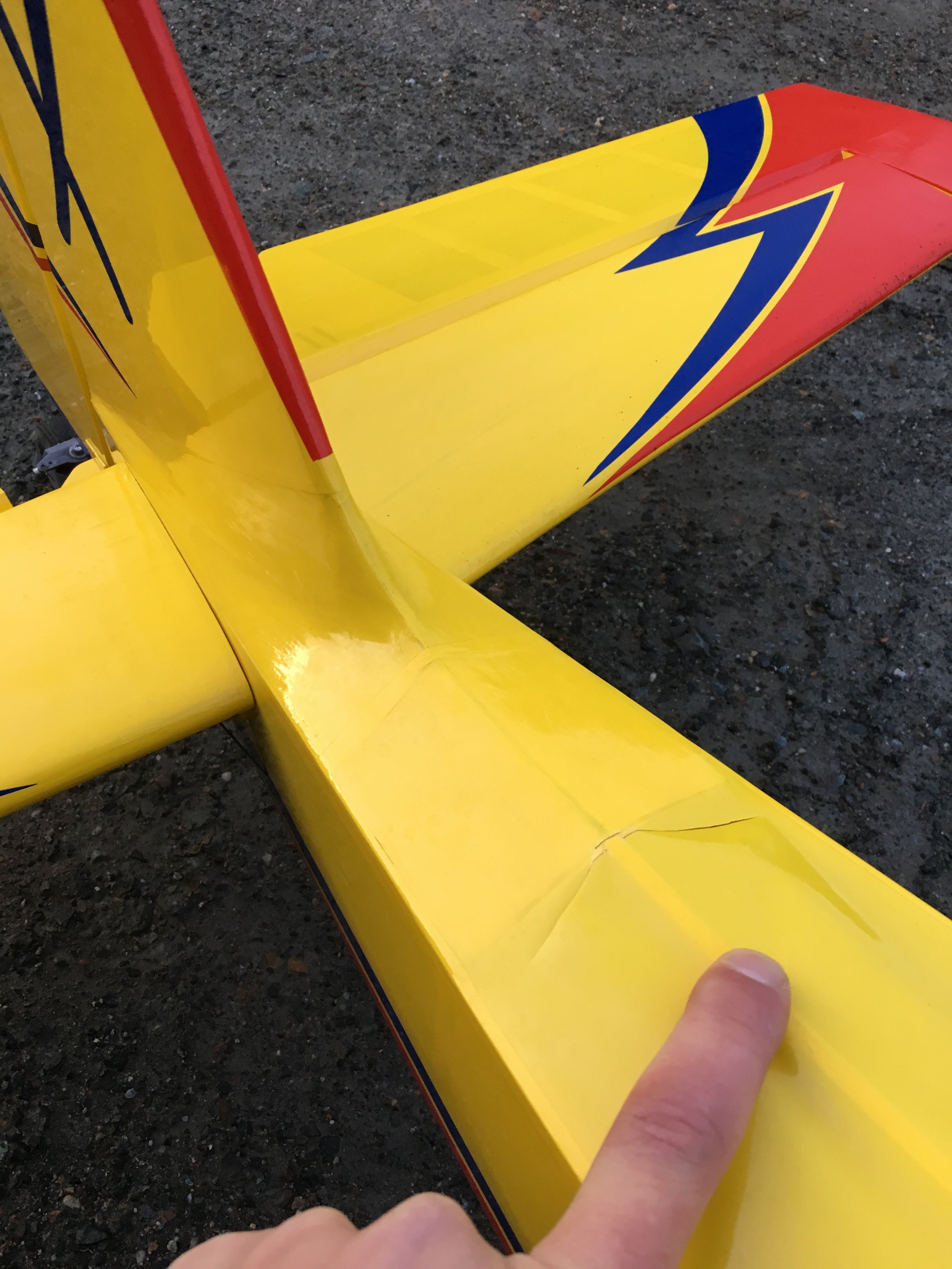

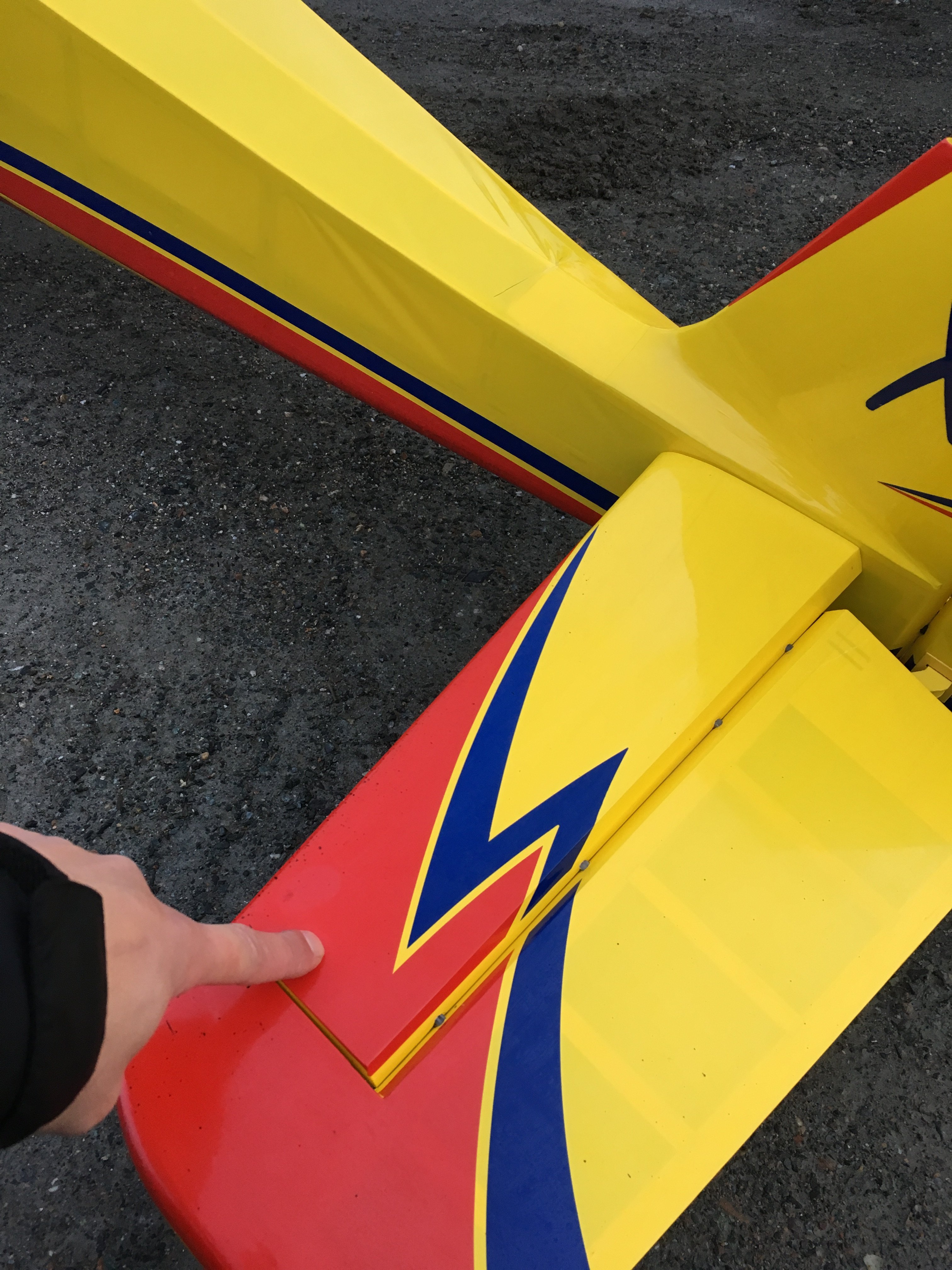

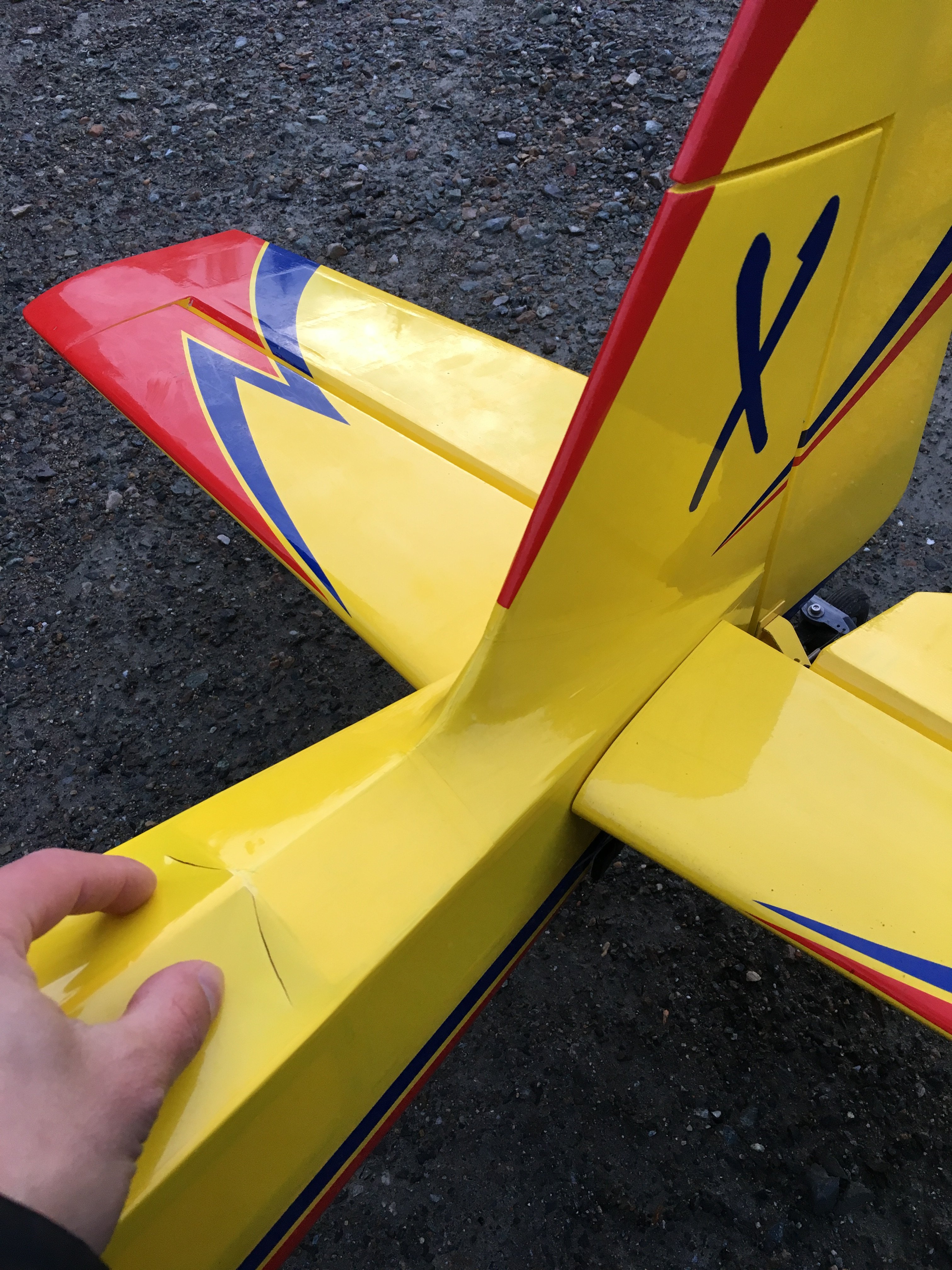

I’ve been noticing there is a lot of flex in the empennage in front of the stabs, the covering wrinkles a bit when you press down on the elevator. I did some slow full span rolls (no wing struts) landed and saw this.
I’ll have to investigate, and attempt to beef this area up a bit. Might be an interesting repair....

Wow @AKNick that tail does not look good. Something is going on in there, something is broken and needs to be fixed. Must say that does not say much for the design. It is falling apart. Keep us informed depending what you find it looks like I maybe pulling mine apart to fix what ever you find.
