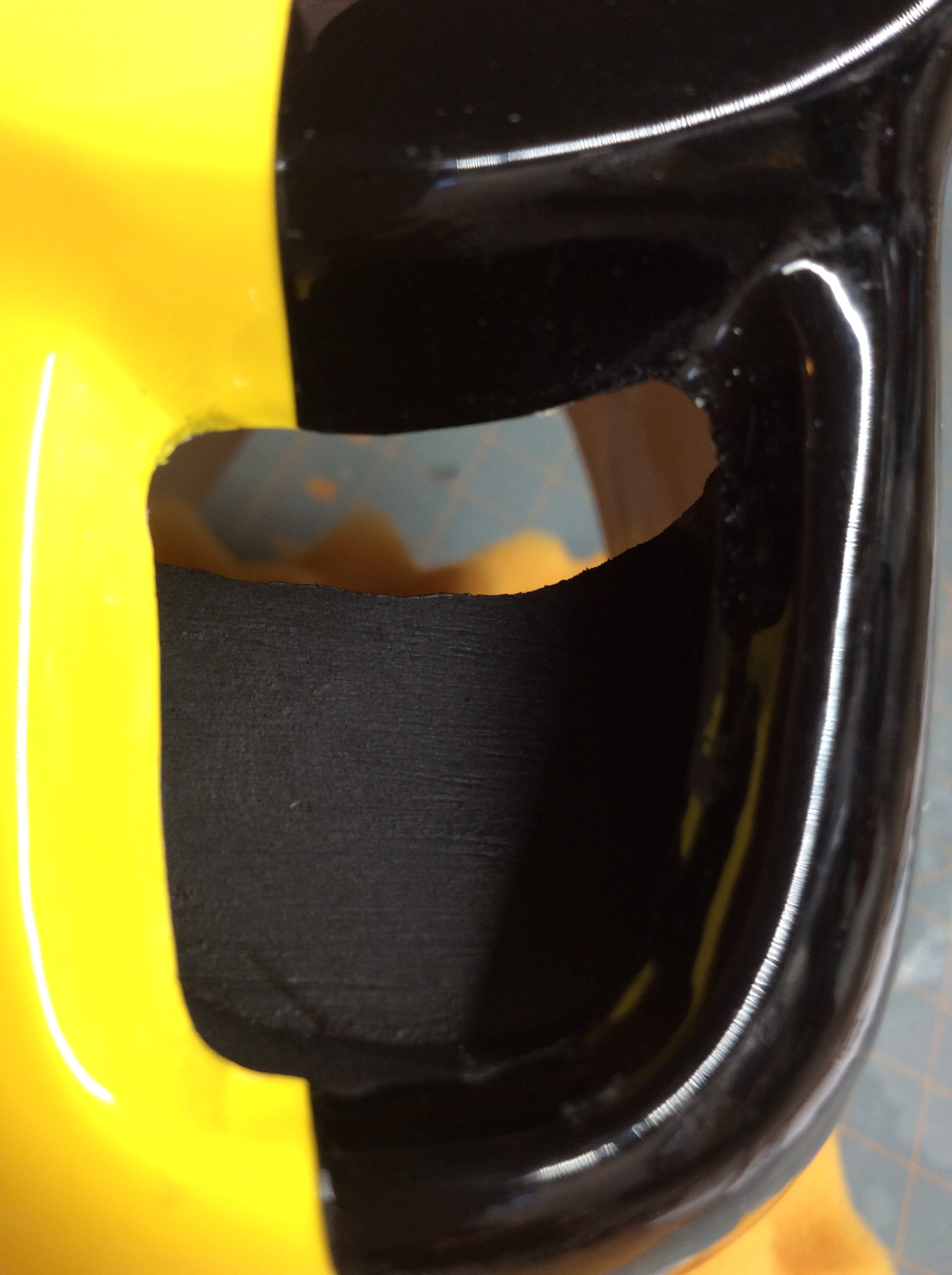

Did some work on the Timber today. The ESC is mounted and nicely in the path of the passing air. Got the bottom cutout and added a wind deflector and also filled in the sides so that air cannot Wrap around the ends and tuck back into the opening.

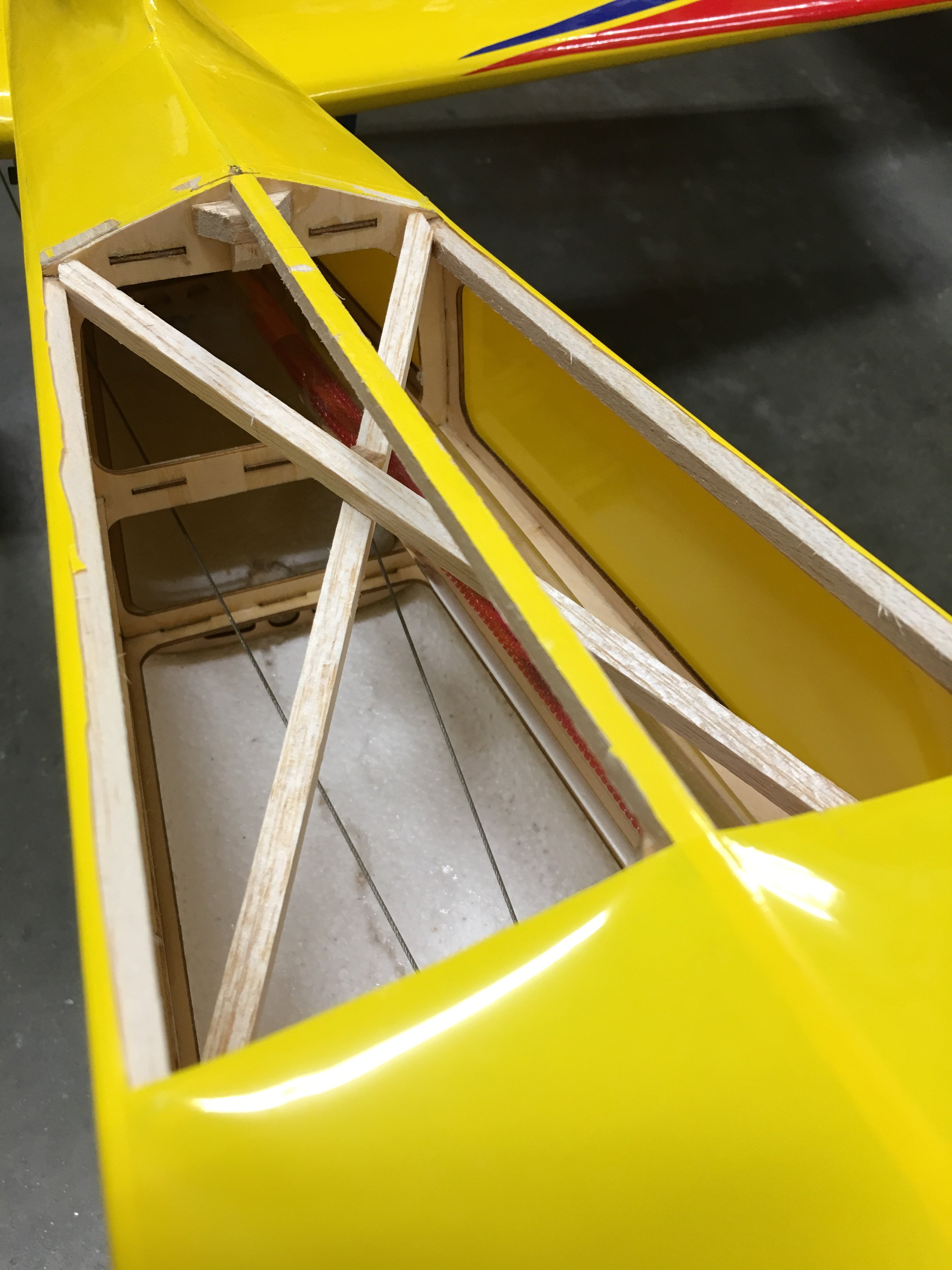

You have not done much for the brace across the top to stop it from pulling out again. Can you not glue a stick on the bottom of it and extend it in the rear and some get it glued further back?

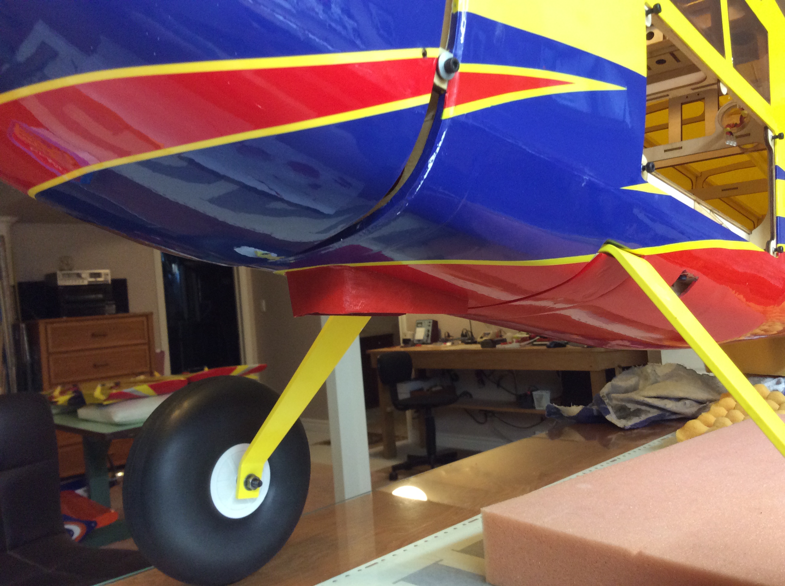

What’s with the Velcro is that just to stop the wheel spinning while you are in the air.
That wasn’t a picture of the full repair. Showing the interlocking frame that wasn’t bonded very well creating flex.
Here is a better picture:
The Velcro is the hook and loop tape, it’s tough, and won’t rip apart. I sandwiched it between a couple light washers. This should give a little bit of tension all the time... in my theory.

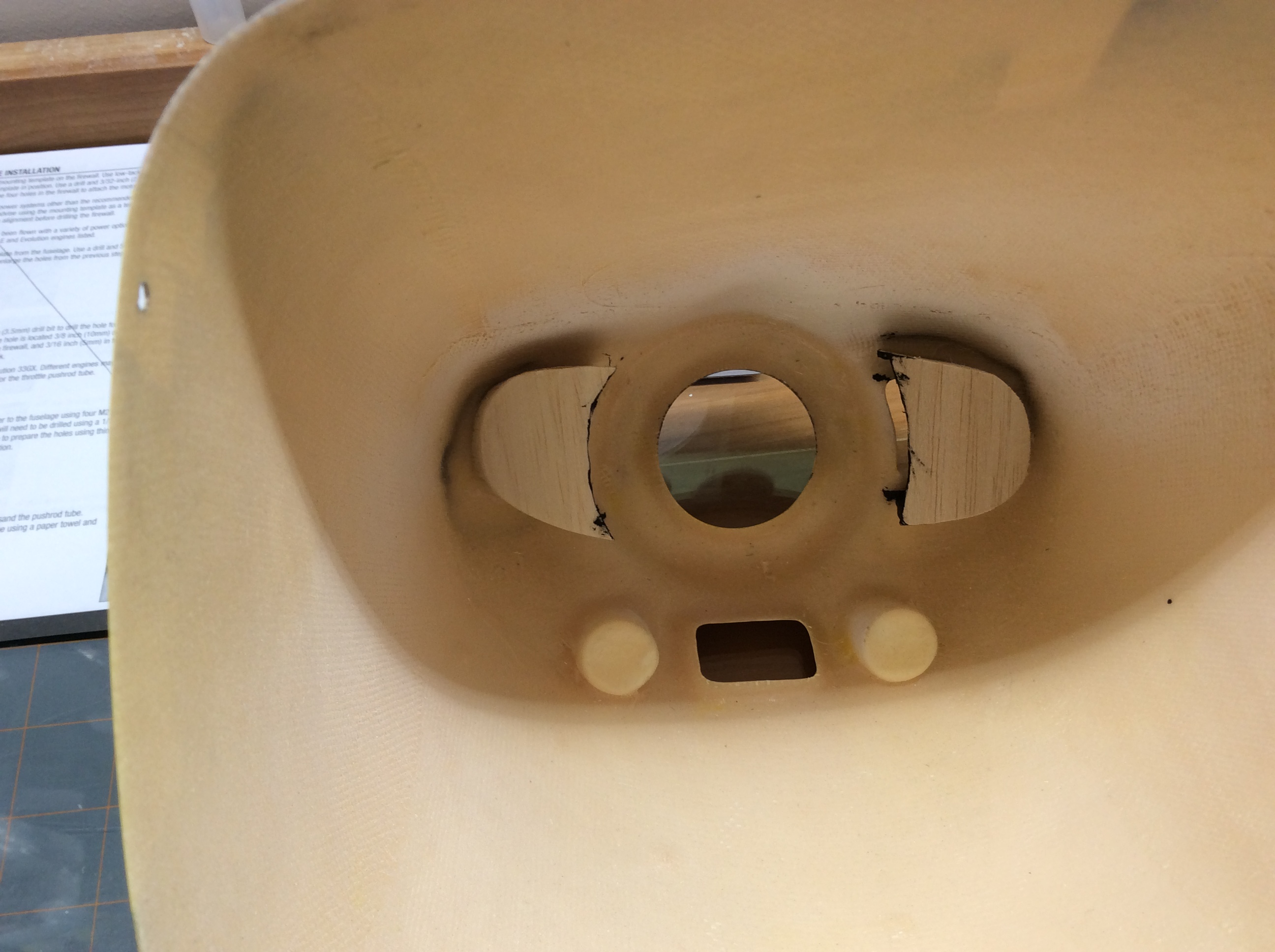

Got the two air ducks in place, tried to make it out of foam but did not work so ended up using balsa wood and it worked out good. The air is deflected inwards so that inters in to the front of the motor and travels through it. Hopefully it works.

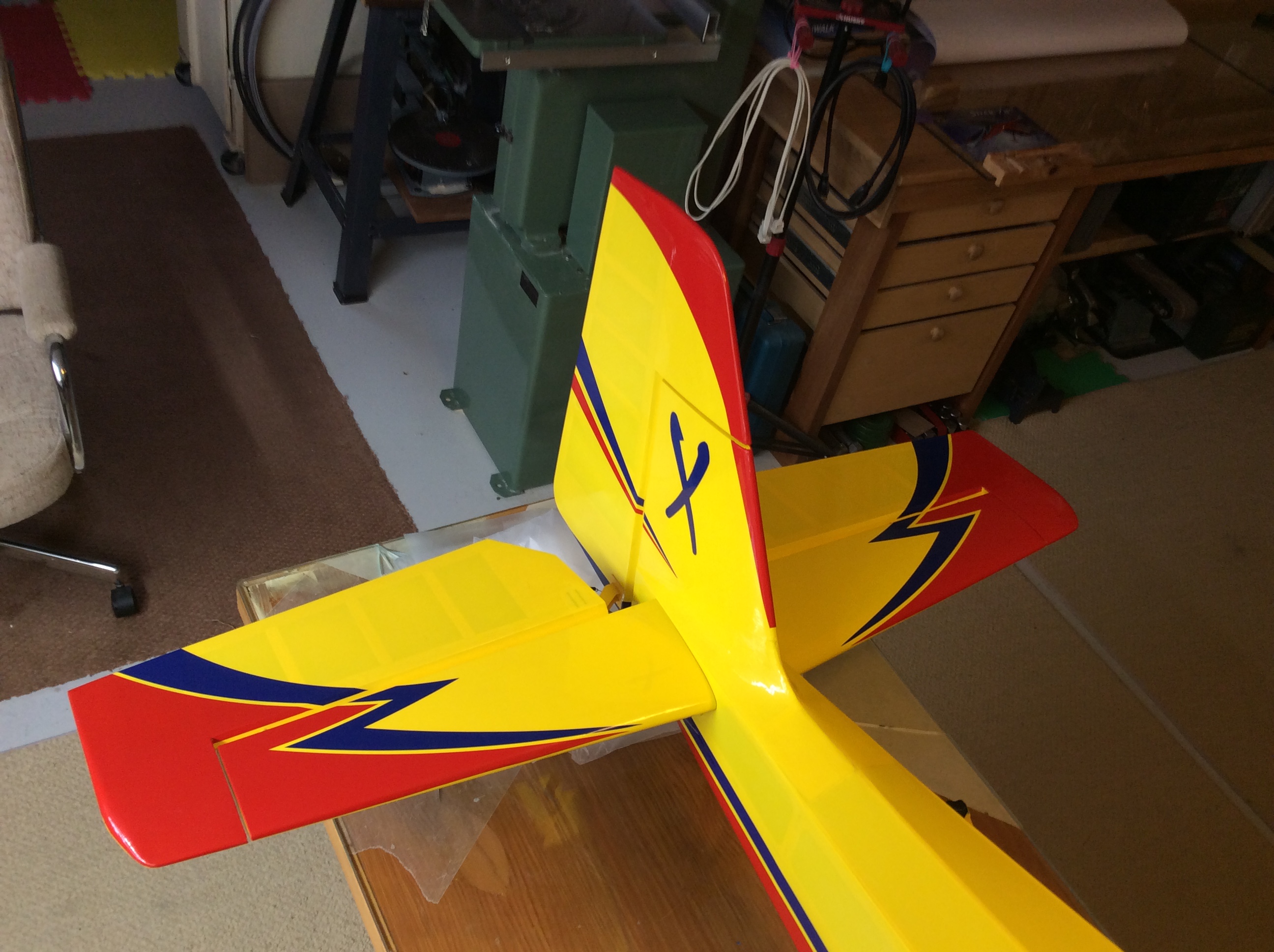

Got the tail installed and the two servos connected. Boy that was a tight fit had file out ever single hole to get to fit. But it is on right now and hopefully does not need to be removed in the near future.
