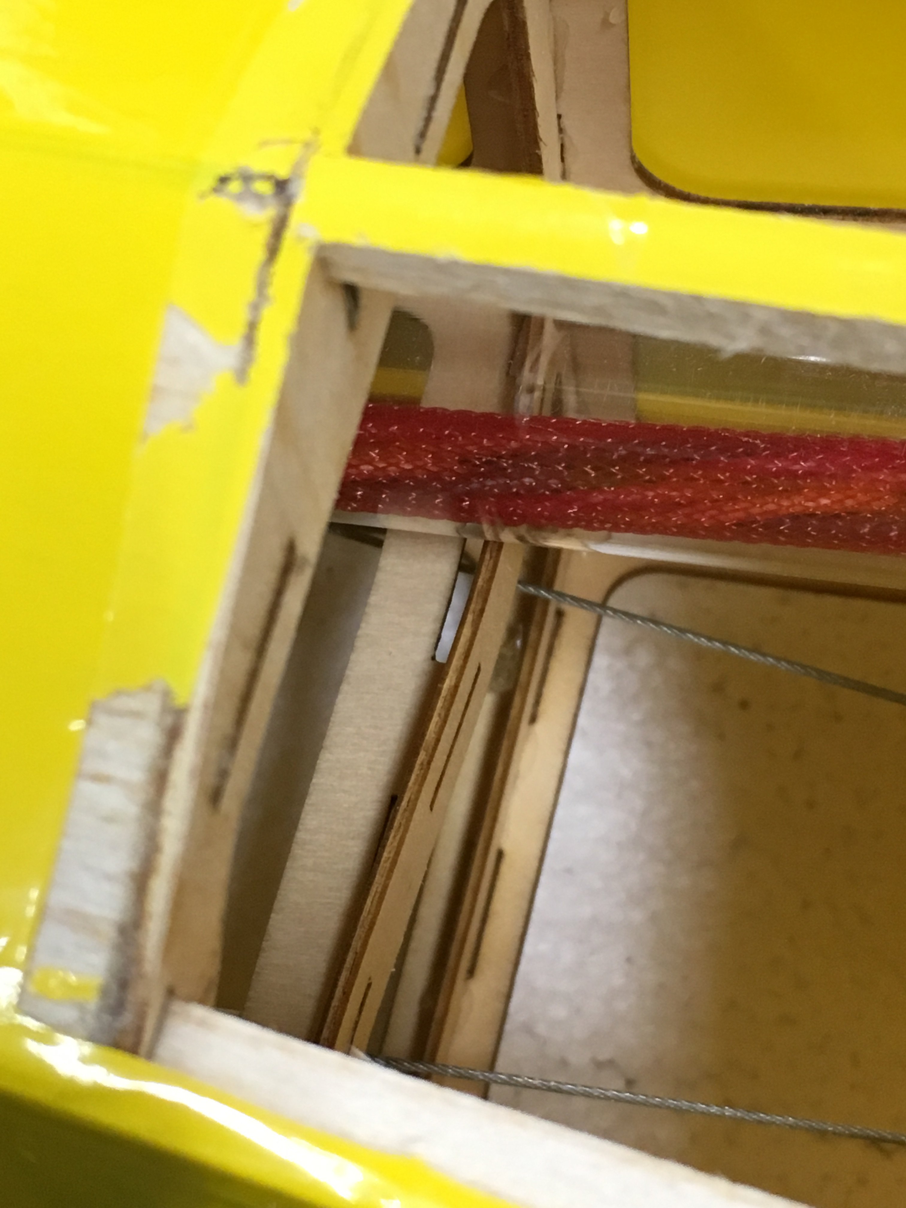

Wow @AKNick that tail does not look good. Something is going on in there, something is broken and needs to be fixed. Must say that does not say much for the design. It is falling apart. Keep us informed depending what you find it looks like I maybe pulling mine apart to fix what ever you find.

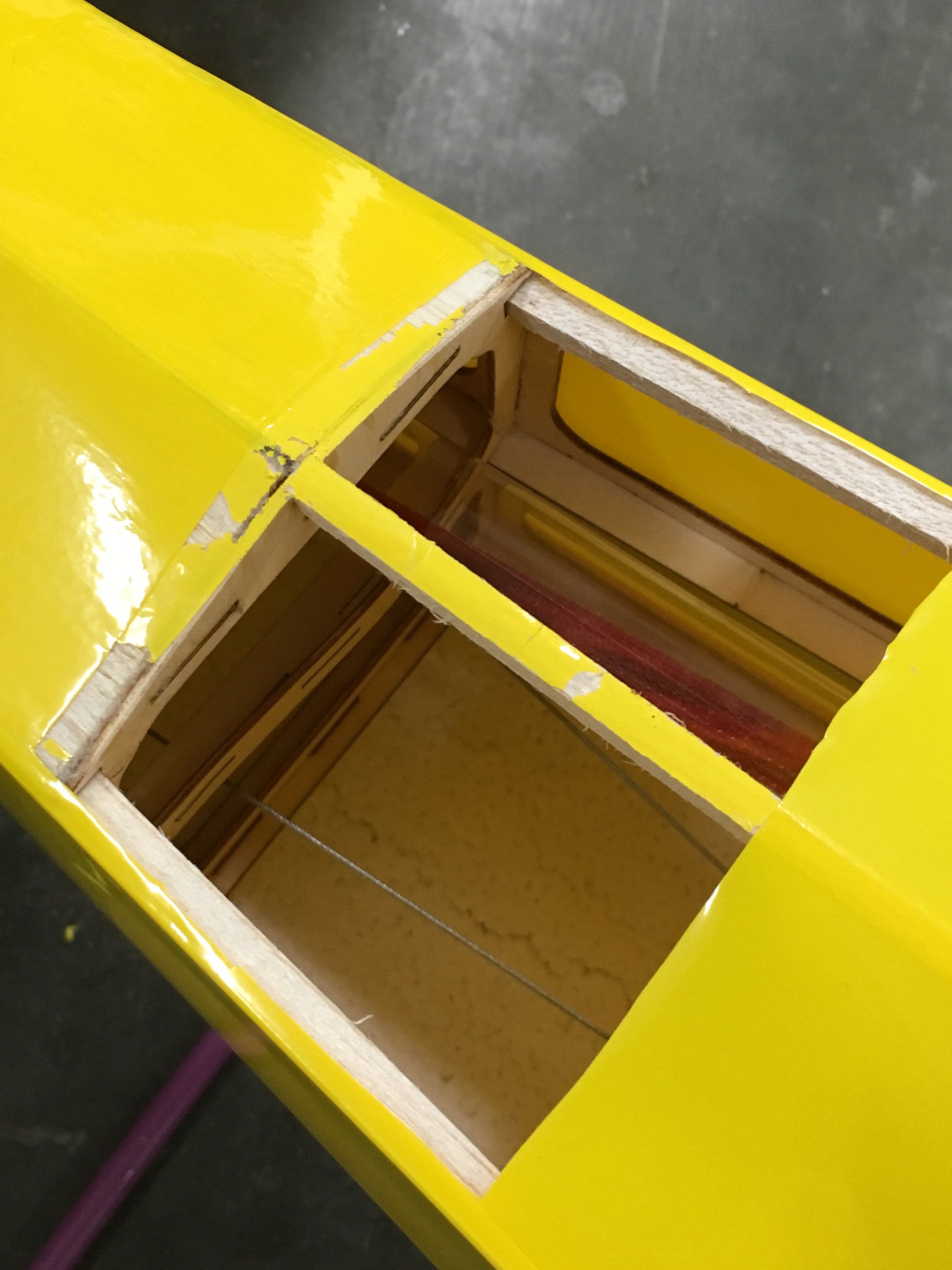

Looks like the top longeron glue joint failed because it was subject to a torsion load in which it is not designed for. It will probably end up with some cross bracing between formers to alleviate this.

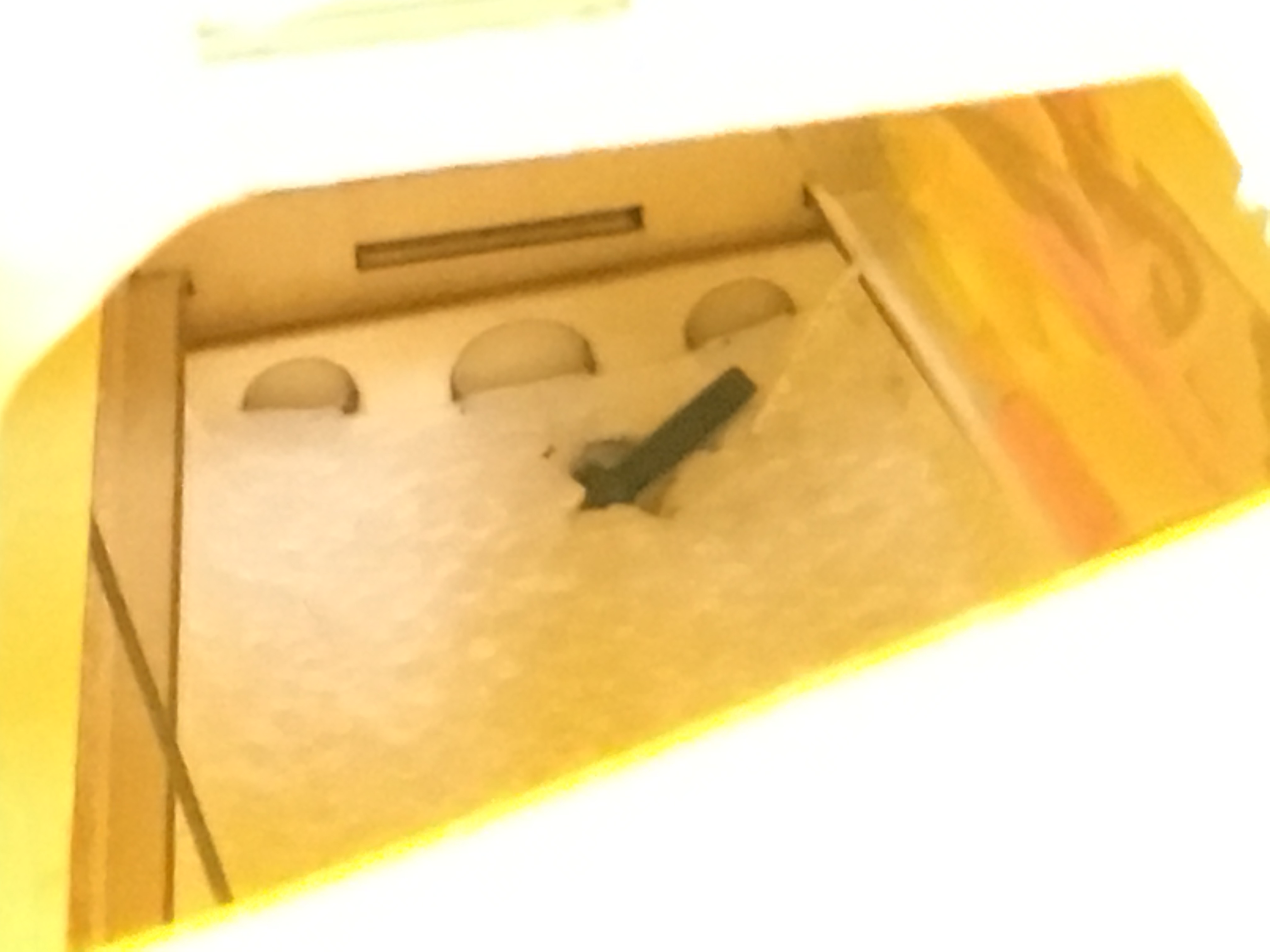

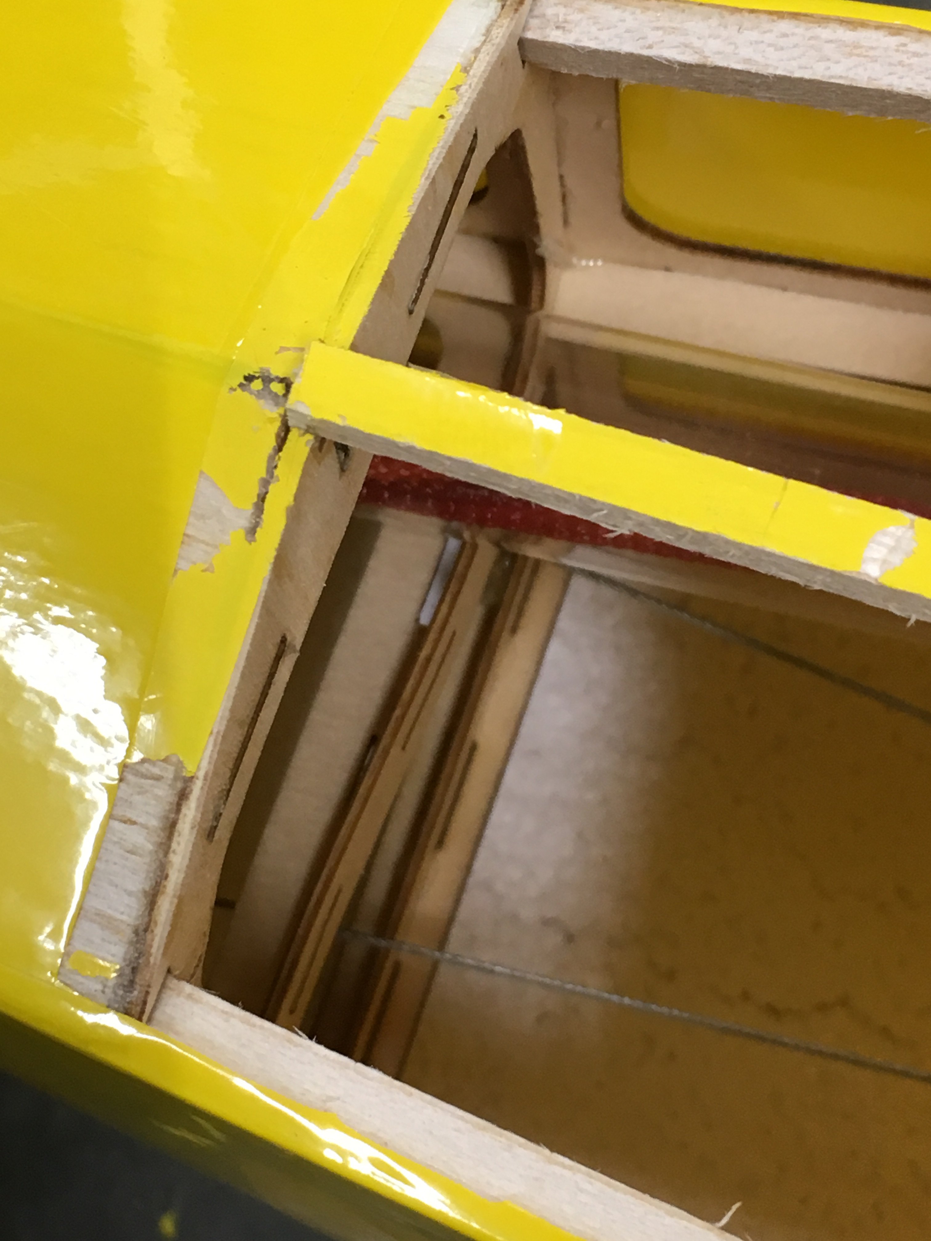

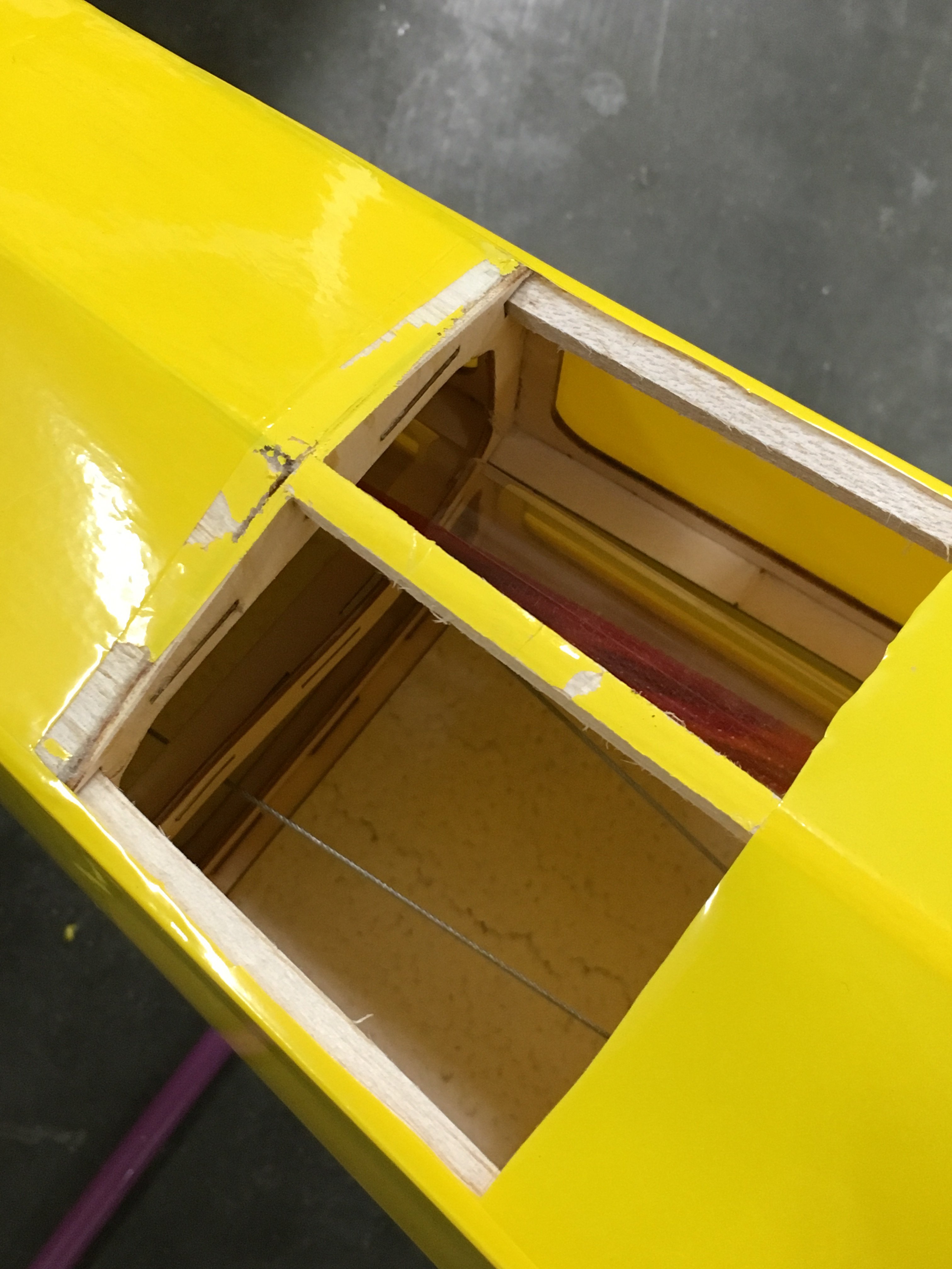

Did a little digging. Top longeron popped loose from the former.
There was another interlinking ply that had never seen glue and was popped out a bit.

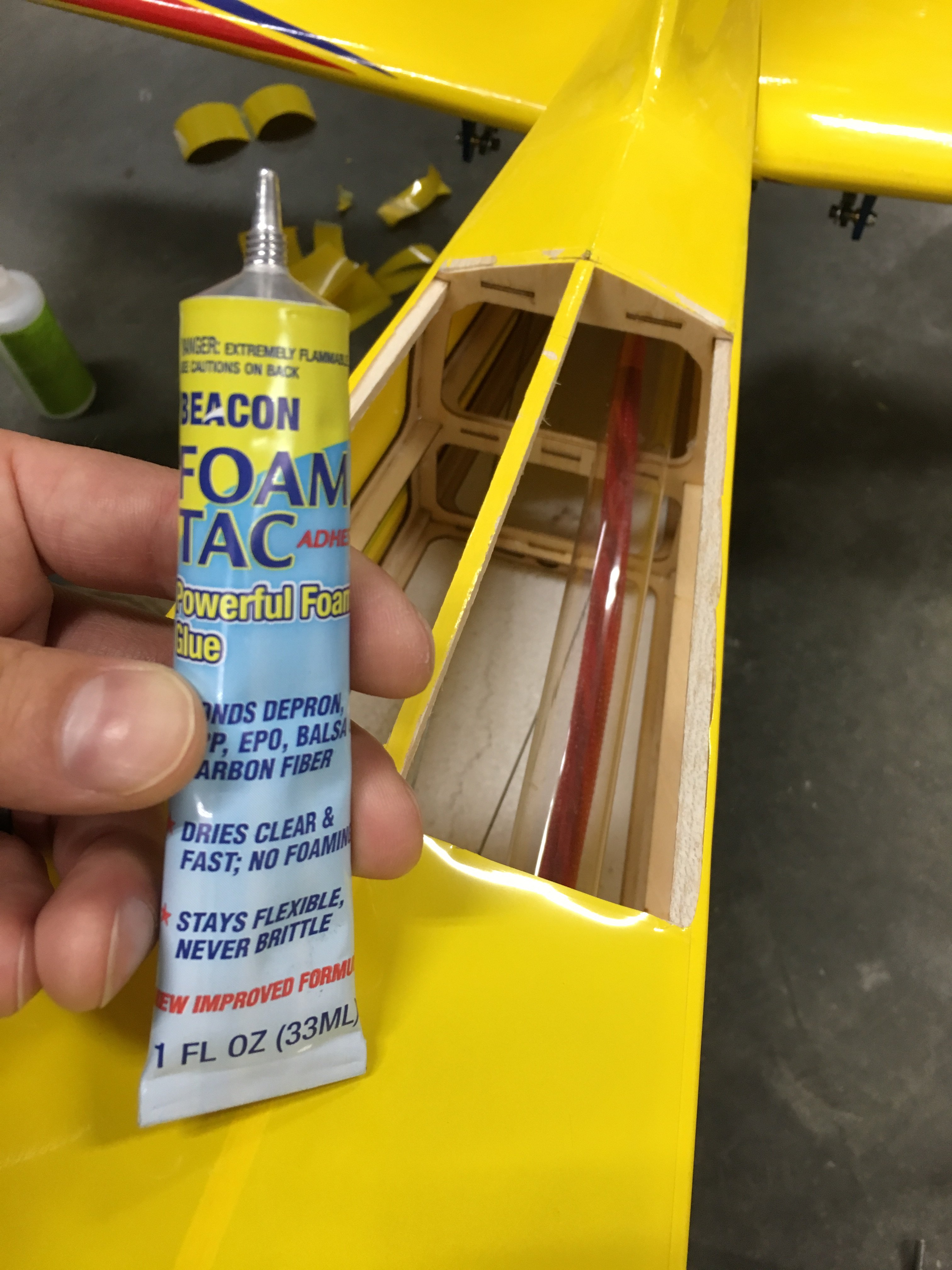

Lower belly foam cracked. I never did repair the other one I found. So busted out some foam tack.
I’m going to add some cross bracing.
Not sure what to think about this random screw. I also had one fall out only a wing. ???
Foam tac to the rescue.

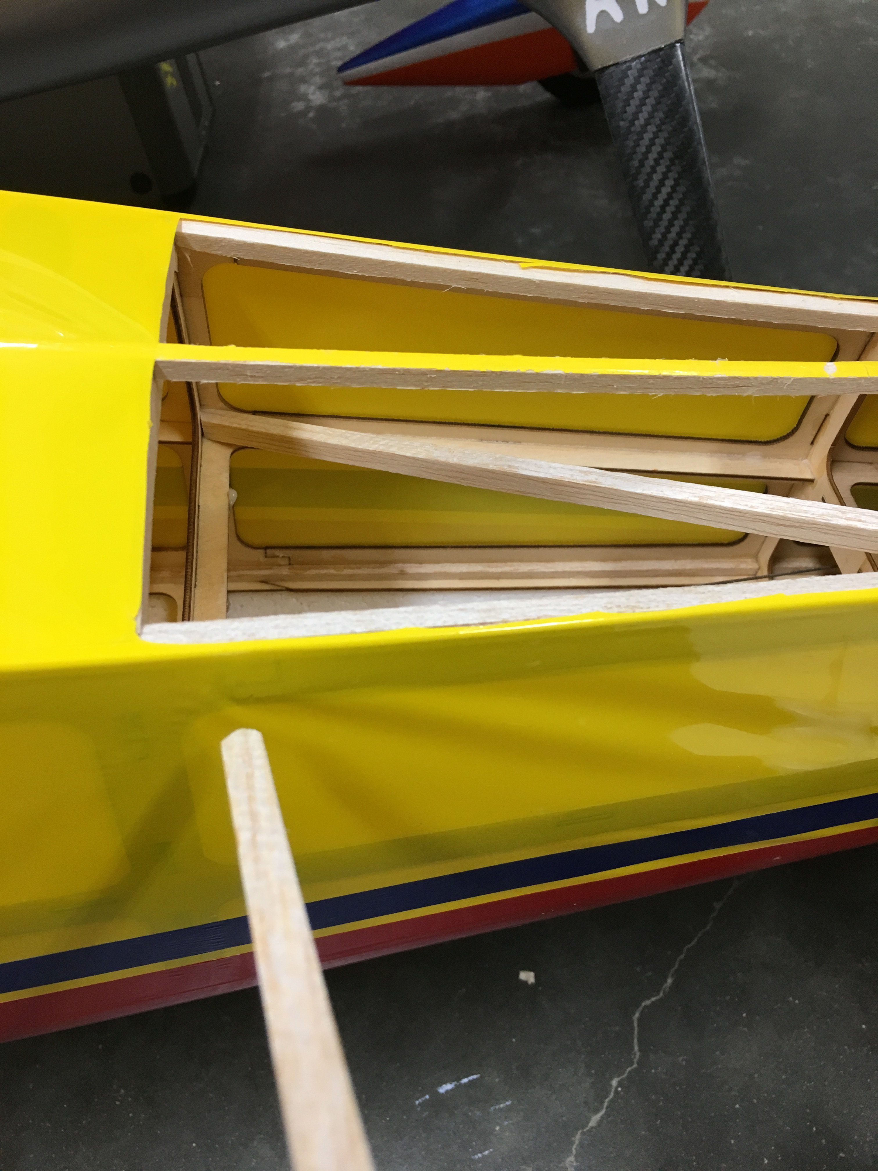

So all fixed hopefully it all stays in one piece from now on.
I'm still trying to determine what needs to be repaired or not. The foam has multiple cracks and it's very hard to get to everything. As far as bracing goes, a cross (X) bracing seemed to help a bit. the structure and design itself allows some torsion in the tail section. I put some balsa support chunks under the piece that popped off so it wont happen again. It's hard to do symmetric bracing due to pull pull wires, and the elevator servo wire tube. I added a lot of extra glue in all the joints as there are gaps and even some of the jigsaw joints were a little loose.

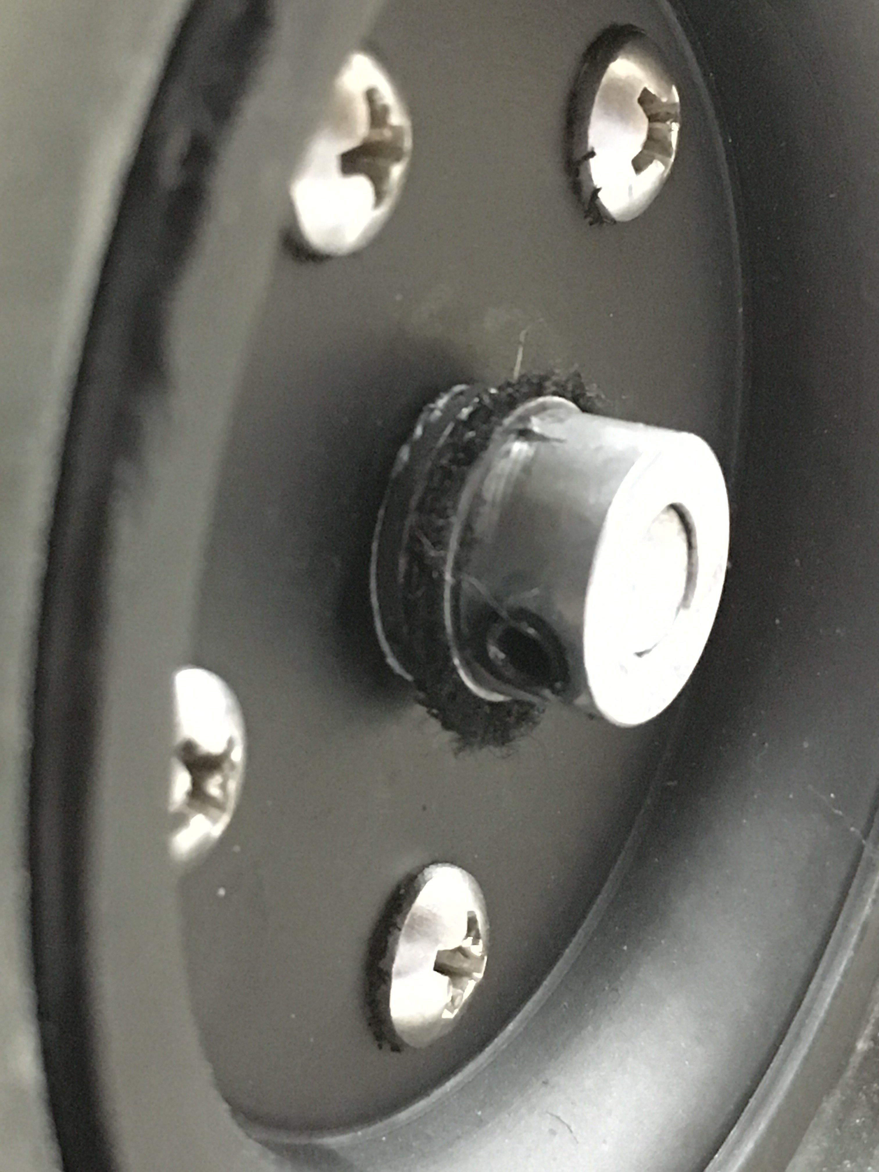

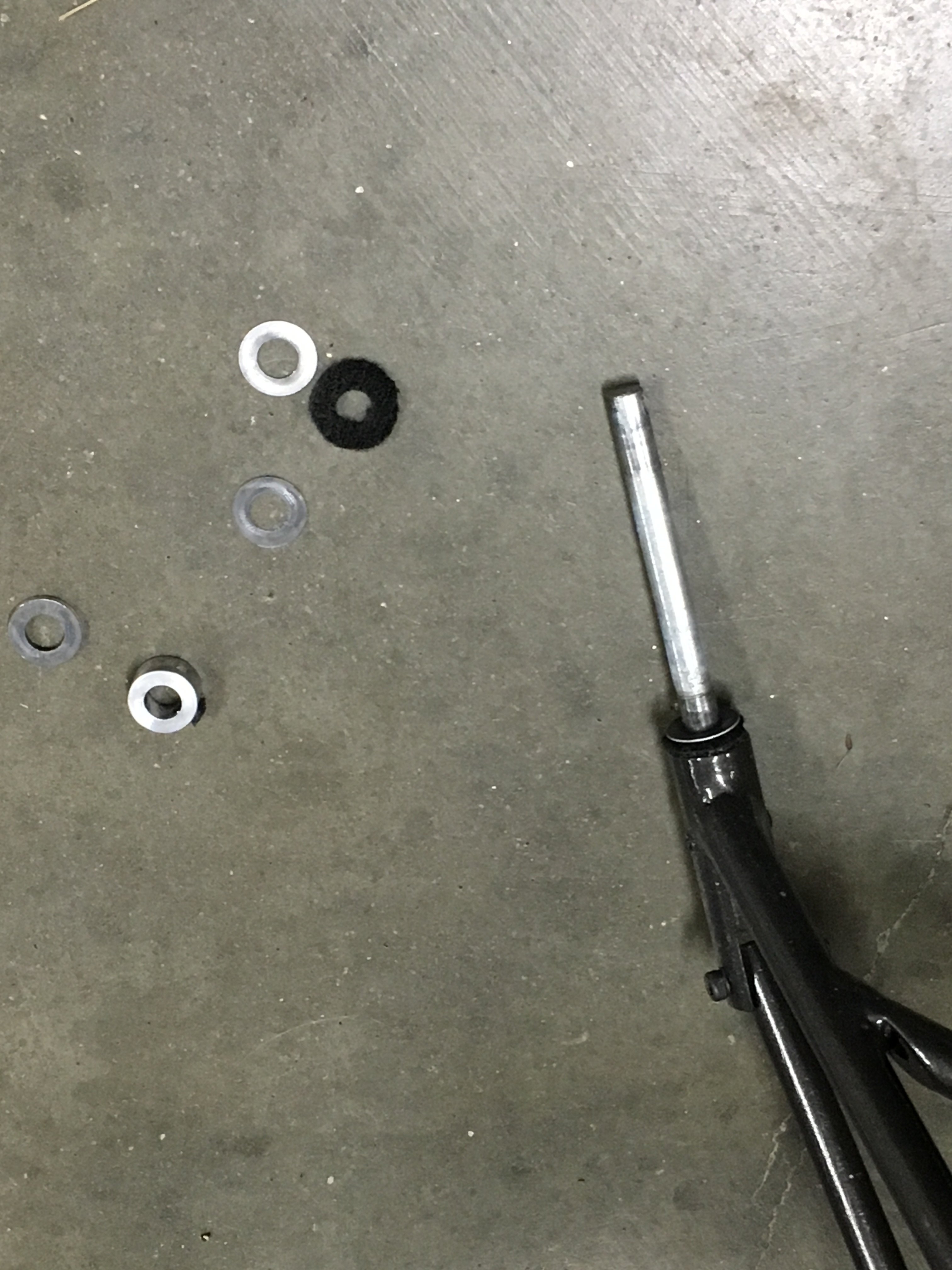

I also made some Velcro washers to help give a little tension with my wheels. They work pretty good right now, we’ll see how it works in the long run.
You have not done much for the brace across the top to stop it from pulling out again. Can you not glue a stick on the bottom of it and extend it in the rear and some get it glued further back?
What’s with the Velcro is that just to stop the wheel spinning while you are in the air.
