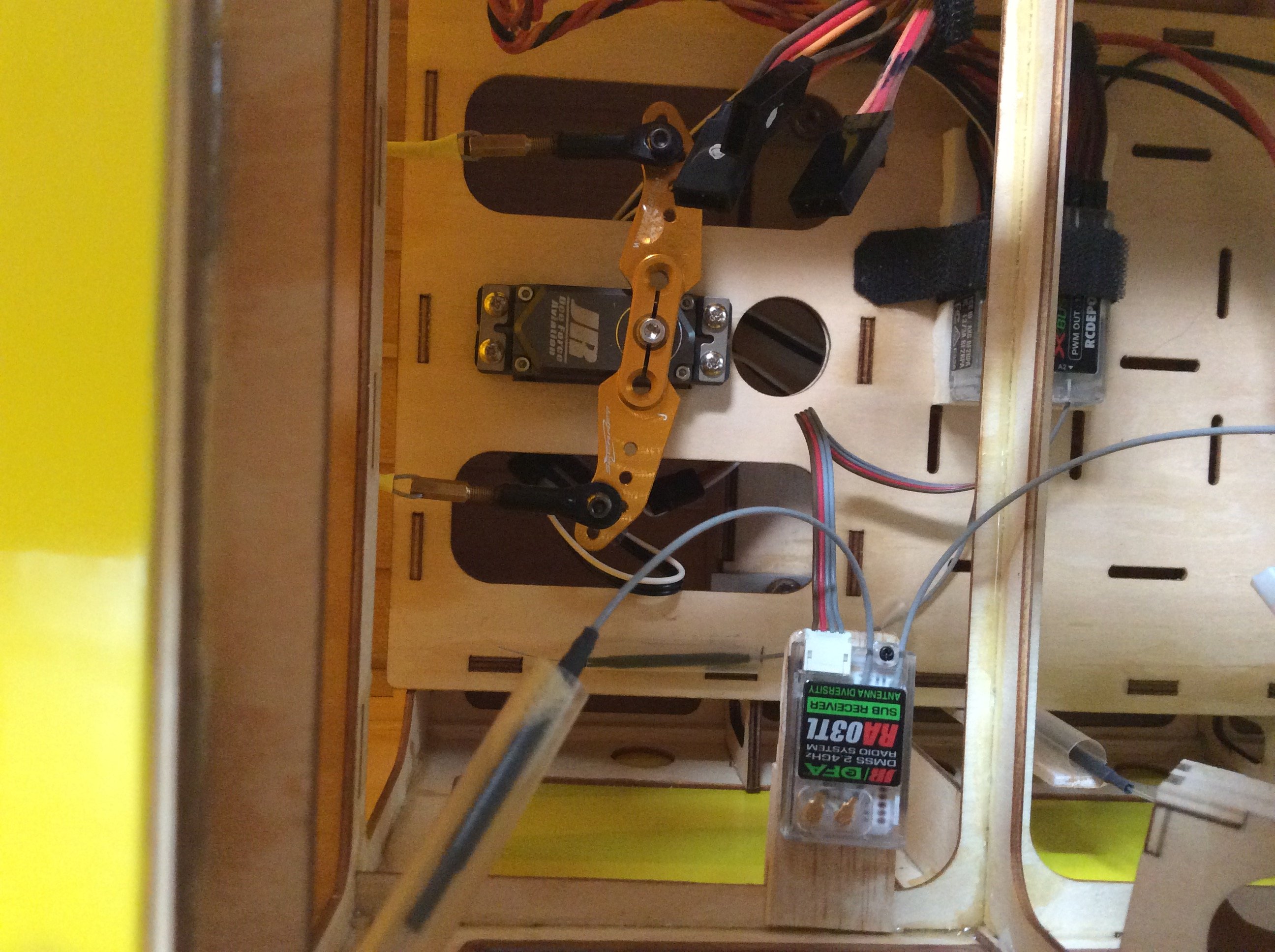

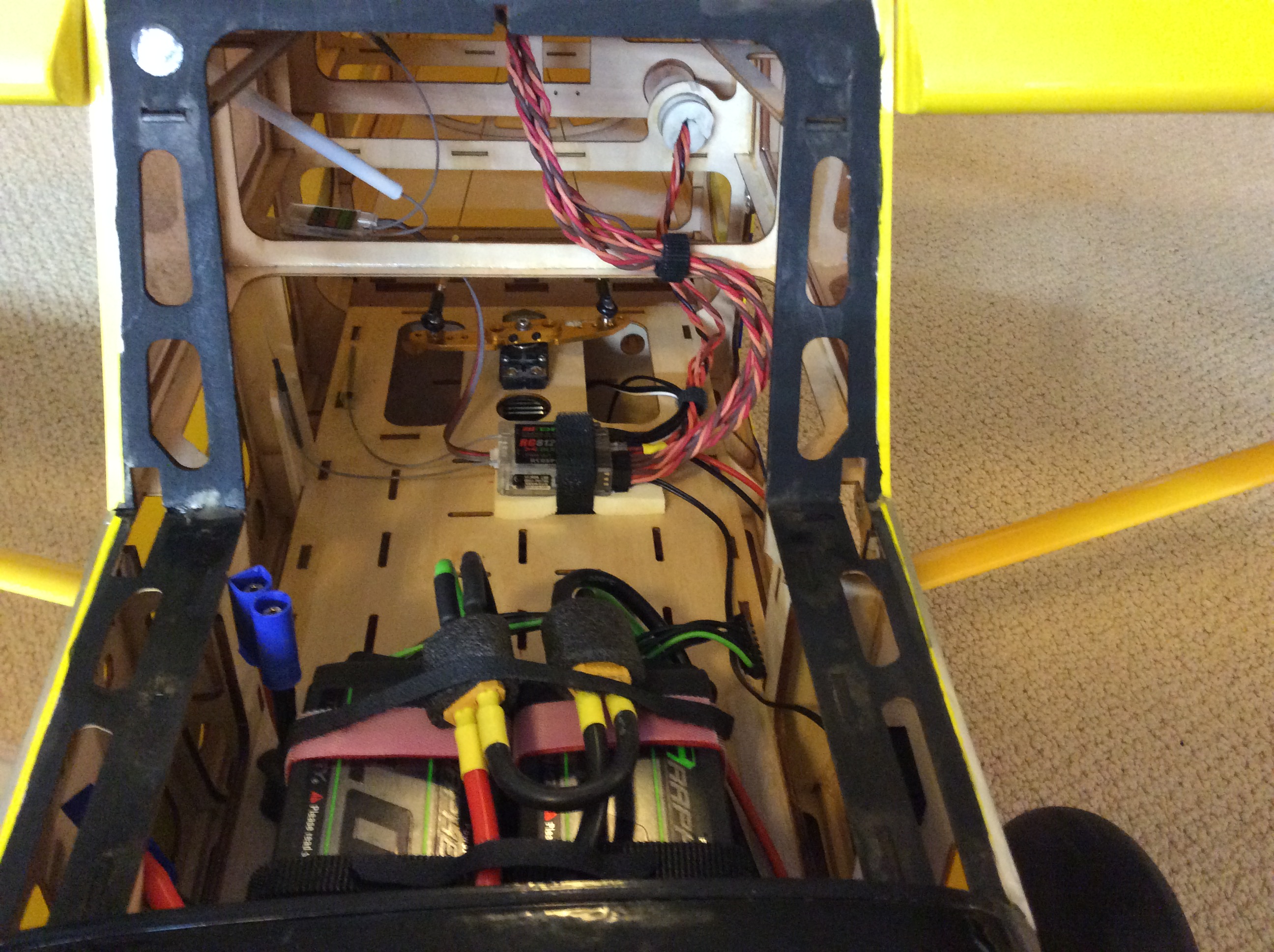

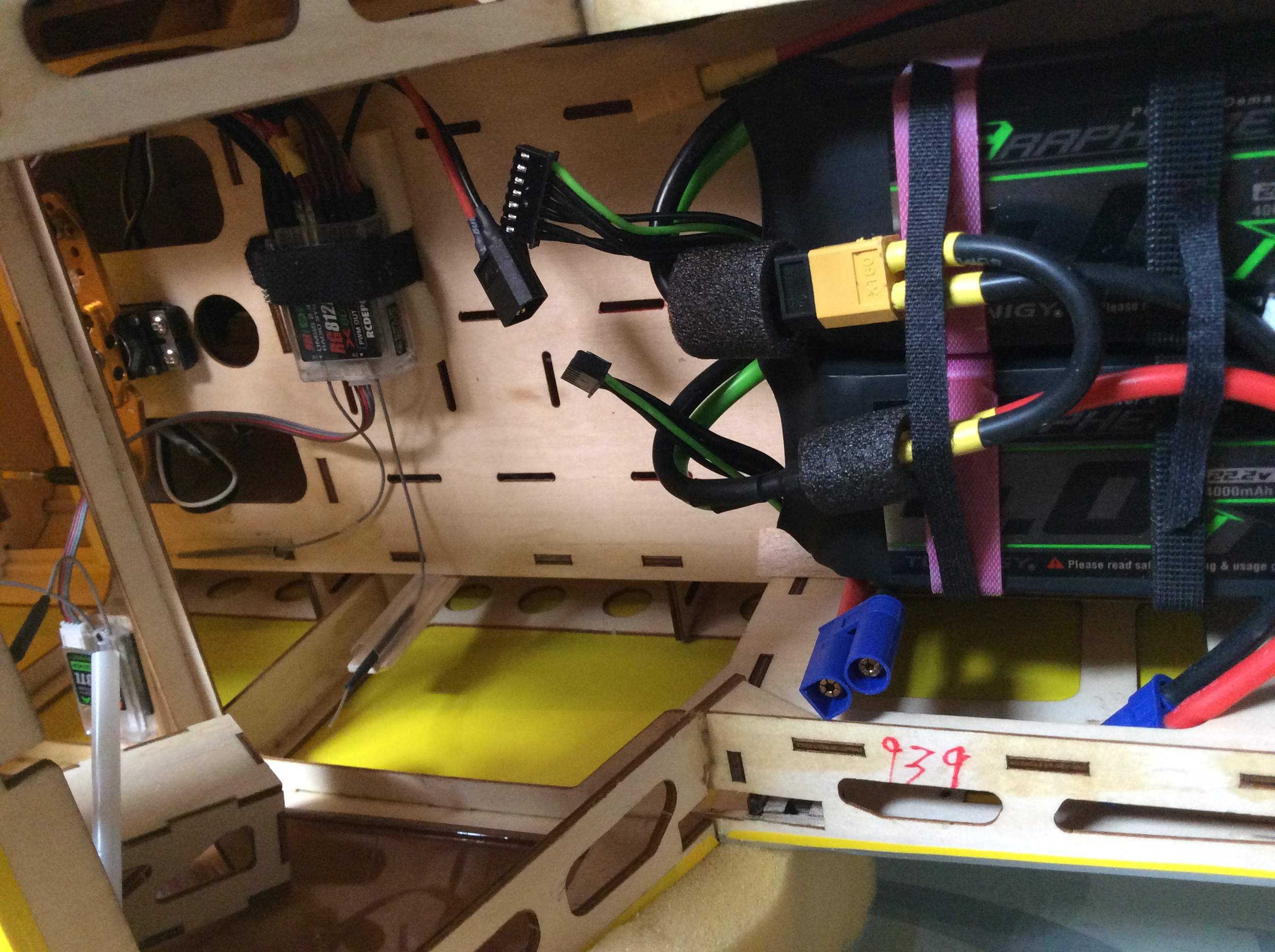

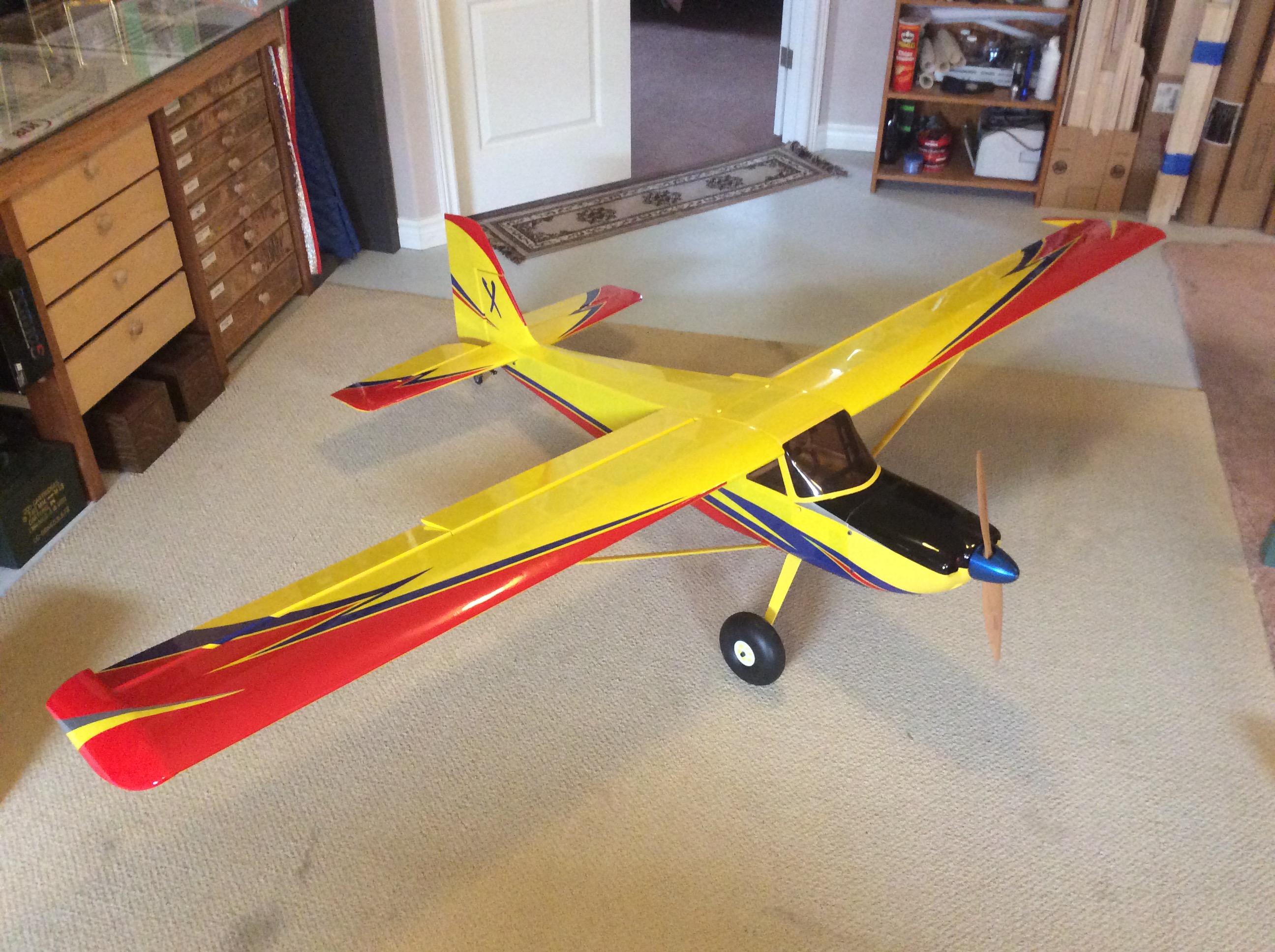

Everything is done had to make four new wing extensions to reach the wing properly. Photo add to show it all done. Just have to wait for a 3 inch TT spinner and program the radio this will be done tomorrow. And then wait for the spinner and next year flying season.
Yes they are the latest type of grapheme batteries as you I am very interested to see how they perform. The one reason I bought them is that you can supposedly recharge them all day . Land charge and fly agin, time will tell.
