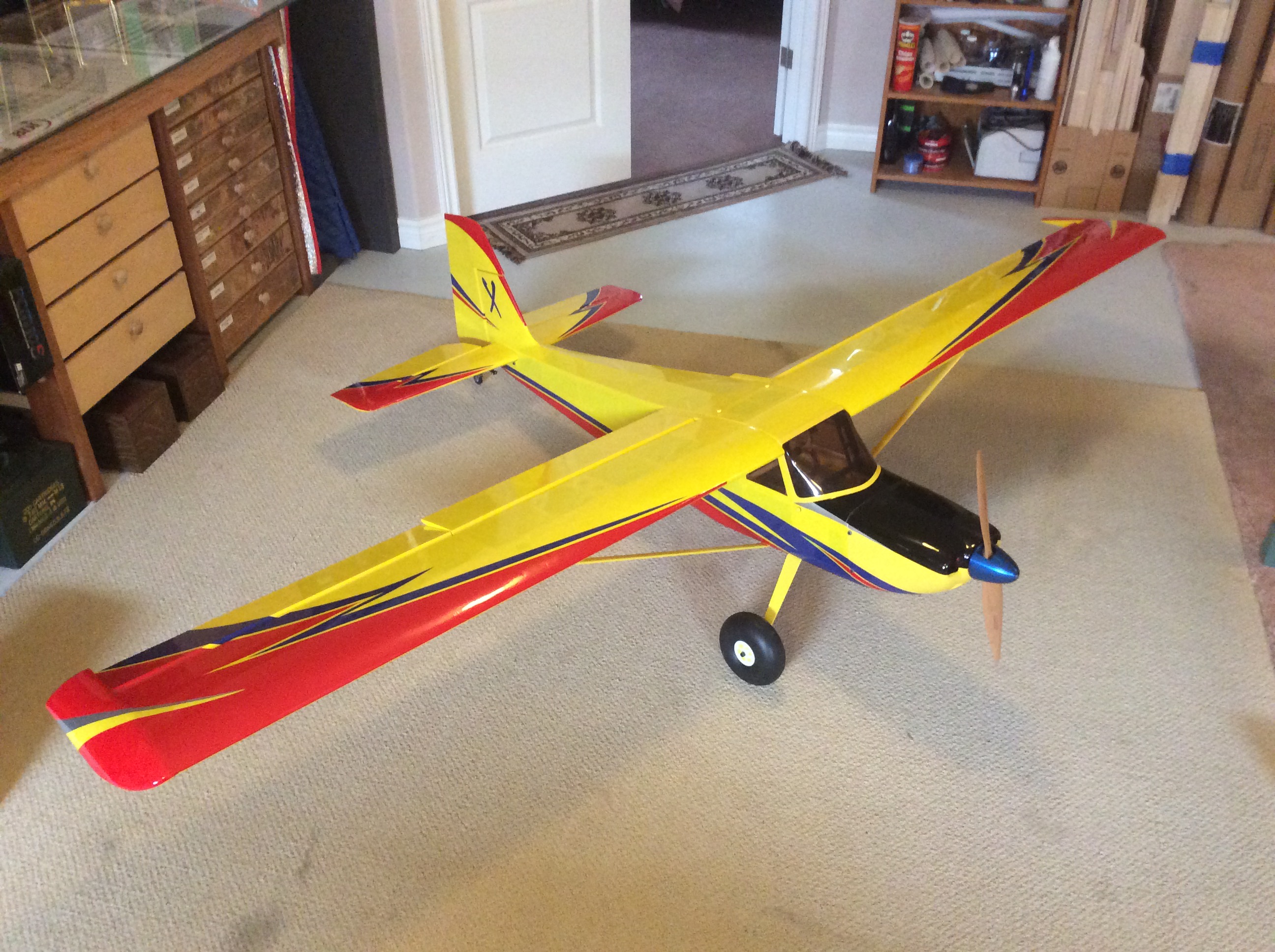

Can someone please let me know if a canister will work on this plane, preferably with a DA. I questioned HH about a canister, not engine specific, and this is their reponse:
Robert,
We're unable to confirm or deny the possibility of that being something that will work. It is not something we have tested or the ability to test.
You might see if anyone else from the RC forum community has tried that and if it was successful.
This would be a great winter project, however, I really need to run a canister.
Thank you,
Robert
Everything is possible depending on how much work and how much you are willing to cut and change. This is my opinion the plane was not built for a canister and it will take a lot of work to get it in. Also remember the plane is building a little nose heavy with the larger gas engines so a canister will just add to that problem.
Why do you need a canister. Is it is for the noise. If so if it were me I would determine the header and the drop then measure everything and have JTec build a muffler that fits the opening in the fuselage.
Snoopy1 - Thank you for the reply. I need a canister for my flying field. I'm not sure why HH didn't just tell me when I emailed them. I love the plane, just not sure yet if I want to go thru all that work. I've had my eyes on some other planes canister ready. Thanks again.
Well going make a set of wing bags for the plane just not sure where to do it. And after some difficulties I have managed to figure out how to program a kill switch for the electrical motor, just have to set the final trim but that will be set at the field some time from now.
AKNick
Whose using the airtops? How rigid is the material they use? Is there much give to them?
Not sure if anyone has them here. 8" AirTop Wheels, They appear to be similar in weight like my 8.75" PR's, which are similar to 6" Dubros. I bet they are... similar in function. LOL.
The Treetop Flyer
I haven't flown my Timber w/Airtops yet. However the 8.5 Air Tops seem to be a good tire. A bit heavy but well built. If you can find (Fastrax 8mm X 12mm X 4mm Bearing FTBB23) they will fit the axel with a little shaving it down to <8mm . Or do like I did and find some 8mm round stock/bar and cut to length with 8mm collars on the outside.
