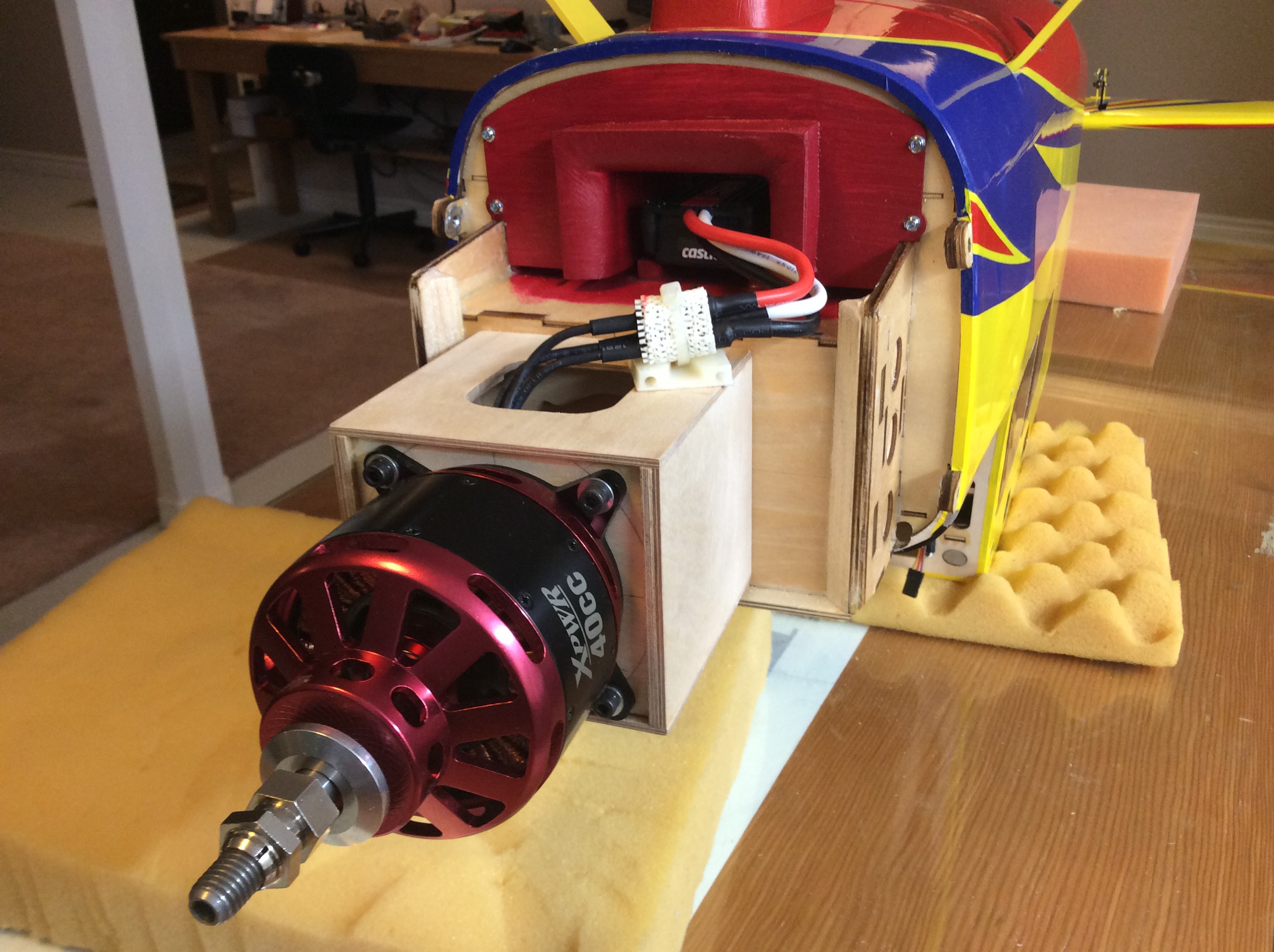

All the joints have been epoxied and looks good. So installed the ESC and the motor. Put all the air ducting in place and now it is ready to install the rest. Curious how the weight will be and the balance. Just put the two power batteries on the scale and the two weighed in at 52 oz. more than I expected.
Well put the plane together with everything in all the batteries ready to take off 20 lbs 10 oz. that is not to bad but still almost 2 pounds over the maximum advertised weight, and I have not add a thing the plane is stock.

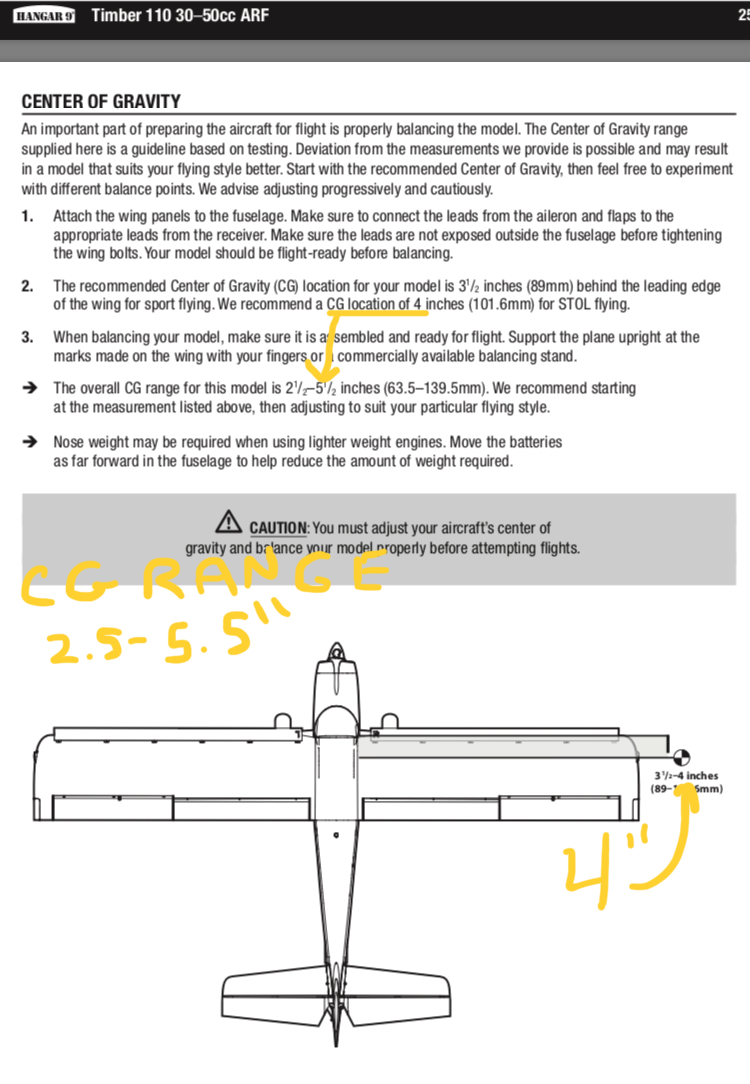

Anyway have a question to the people that are flying the plane it came out a little tail heavy. The max CG in the book is 4 inches but mine balances perfectly at 5 inch. Is this flyable or do I need to get it back to 4 inches, your help is appreciated thanks.
5” is perfect, I moved my CG aft to get to 5”.
Going to strip everything off the front and see if I can mount the two RX batteries on the motor box and that everything clears . Will have to come up with some way to charge and discharge the batteries with out removing the cowl. So that means making some new wiring harnesses from under the cowl into the plane.

There isn’t that much room in the motor box. I’d just mount it aft. 5” CG is good, but a little further back would be better I think.
