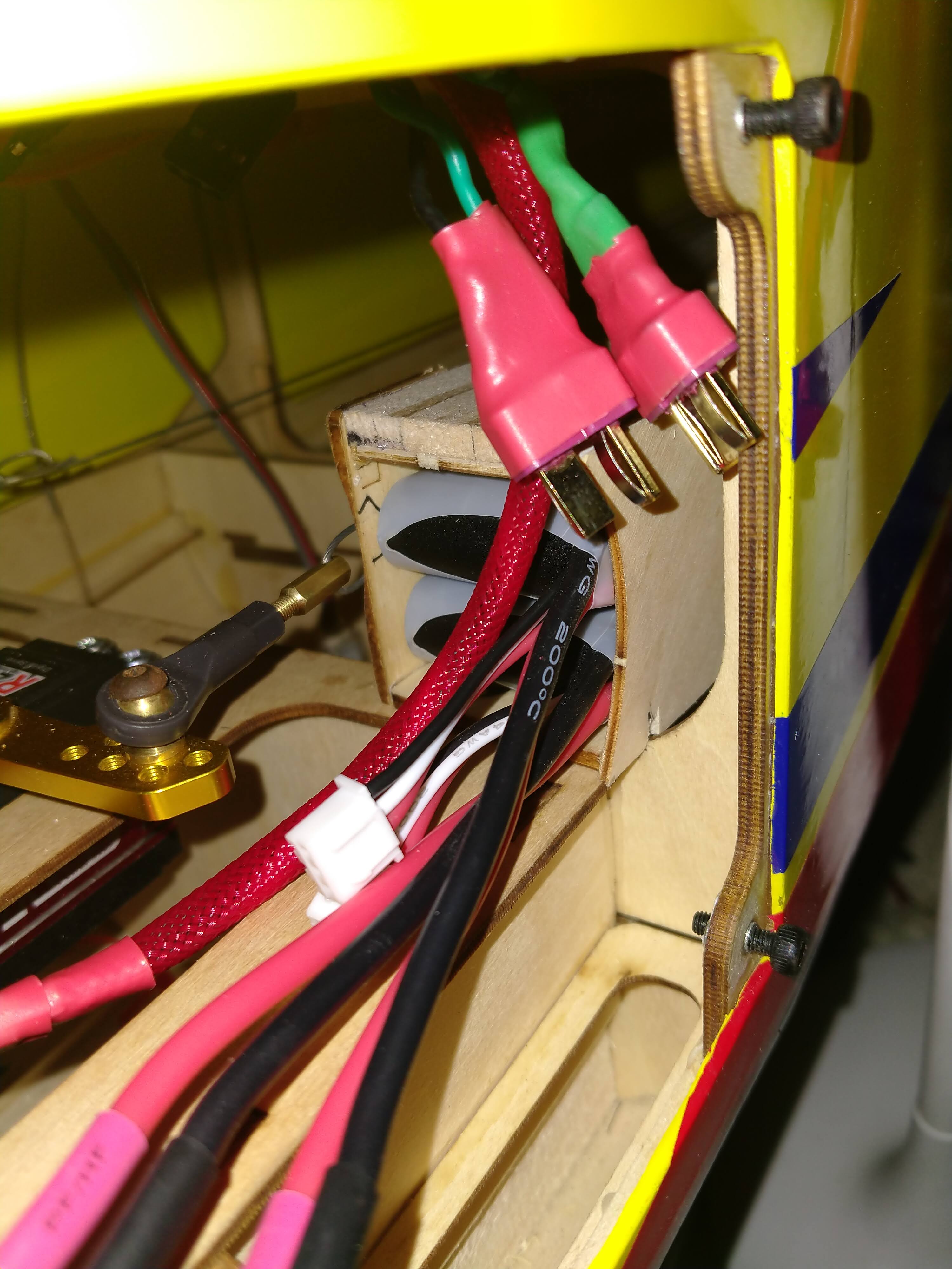

Hi, I recently start to use a Timber 110 for sport flying and aerotowing. I prefer to go electric so this is my setup:
Dualsky GA4000.7 180Kv
ESC Hobbywing FlyFun 110A HV V5 SBEC
Servos Dualsky DS8611 18kg.cm@7.4V (250oz.in@7.4V)
Propeller 22x10
Batteries 12s 4000 mAh
Flying weight 8.3kg (18.3lb)
Regards.

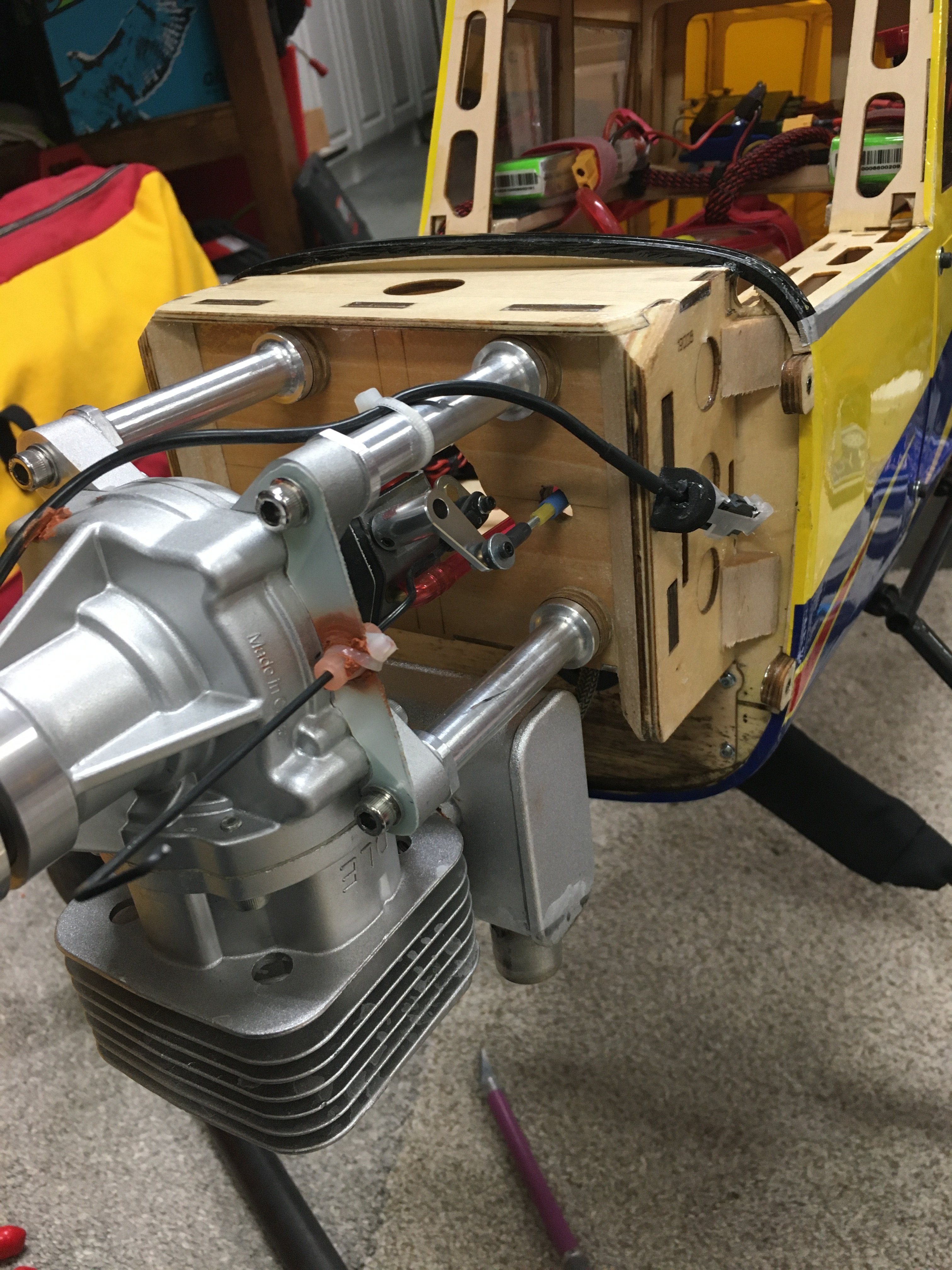

very nice, this was exactly the combo I was considering when I was thinking of making my Timber electric powered. But I didn't think that huge motor would fit inside the cowl, wasn't it a very tight fit at 80mm? I'd love to do some towing with mine, but alas no glider pilots where I live now. Yours is very impressive, great power under tow, how many tows per charge?
