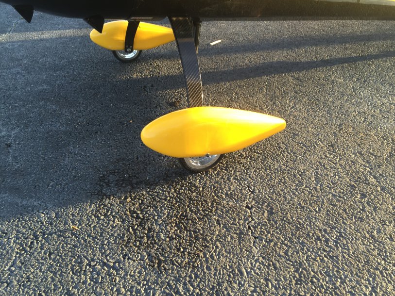

CG. Push your CG back using your batteries about 1" at a time. Also too, when you get wheel panties on it, (should be a law against flying without them)it will add a bit more nose weight, therefore making it more nose heavy. So, you will need more tail weight. If you run out of battery lead, you could always stick , dare I say, dead weight in on the tailwheel block in the rear of the airplane. For every 3 ounces of nose weight, you will need ~1 oz in the tail to counteract.

I actually like the cg where it is. but you are right, when i add the wheel pants (before the police come and get me), it will make it more nose heavy.

i forgot to mention, wheel pants were on!!
