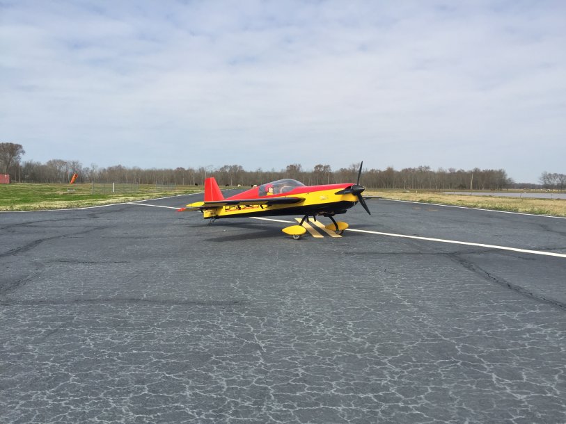

flew this baby 8 times today!! wow is all i can say. got it mostly all trimmed out. i am still on the fence on whether she needs a slight amount of right thrust, but otherwise, she tracks on money! sometimes, without any rudder, it will fly straight up, other times, i need to add right rudder to keep her straight.
ok, when i go to take her off, she will pull to the left each time, i always have to give her right rudder on take off.
