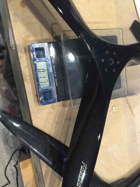

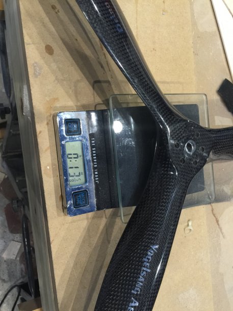

Got the new prop installed. Before i did that, I weighed both of them, and the Falcon prop is 2 ounces lighter than the Delro prop.
this is a Falcon 3 blade 29 x 13 carbon.

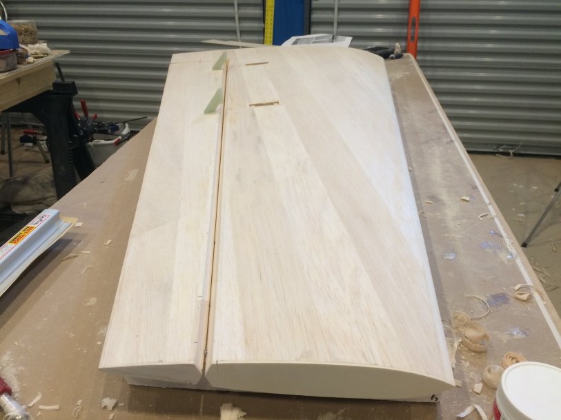

Cam, any tips for sanding the curves on the Leading Edge of the wings?
I sanded one of my down this weekend but I have not rounded it off. Naturally there is less material to round off on the wing tips so I'm thinking of knocking some of the root down carefully and then finishing as one by laying out some sandpaper on my work bench and carefully moving the leading edge back and forth across it until I get the desired shape.

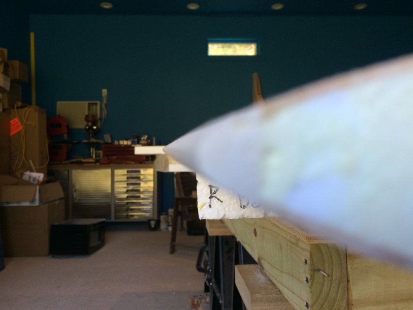

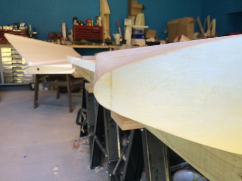

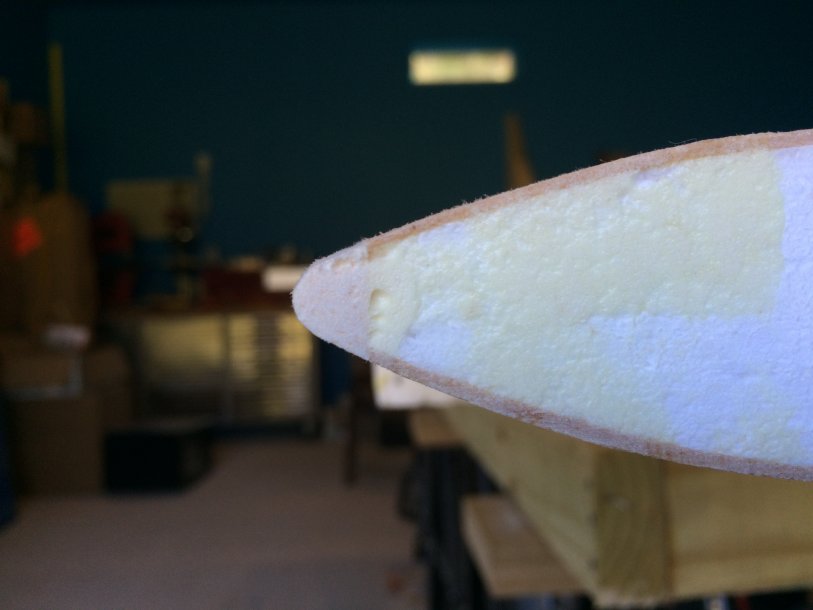

During this step, Tony advised me to make the root area of the LE blunt and on the tip, to be sharp.
this is the tip side before sanding it sharp.
this is after sanding down the tip to be sharp.
this is the root side. make it blunt.
for the sanding, i used a very long great planes sanding block. it is about 33" long. with this block, i used the 280 or so grain, and very few light strokes will sand the tip to be sharp like this. Go very slow and check after each stroke. on the root side, i obtained a sheet of the sand paper, again, in 200 range, and very light strokes back and forth, with the paper in the palm of my hand while i cupped the LE.

on this image, you can see how sharp the LE of the tip is.
