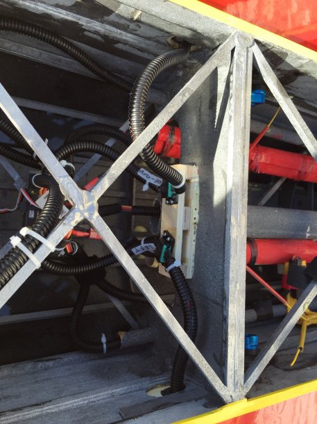

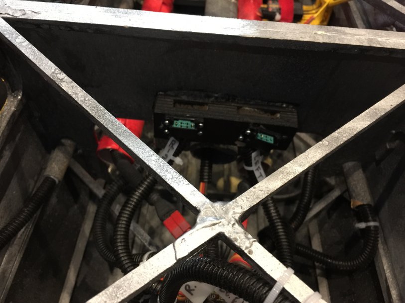

One last modification I made was for the plug ins to the wing. I am using the Taildragger RC 2 in 1 servo leads, where you can connect two wing servos and use a single MPX plug. Before, I would connect the wing servos to the adaptor, and velcro them in.
Now, these plug into the frame, and they have a clip to prevent them from backing out. They are quite firm inside there.
All I have to do now is paint the block they are installed on.
