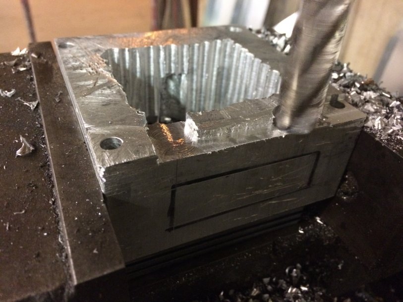

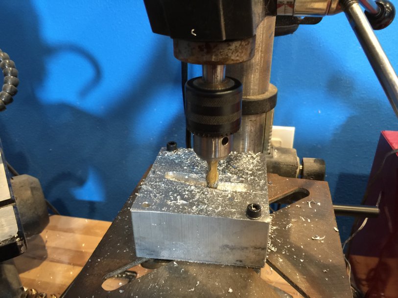

then I drilled out the center. this took a long long time!!
it is far from finished. My buddy will finish it off for me.
Hopefully by tomorrow night, it will be ready.

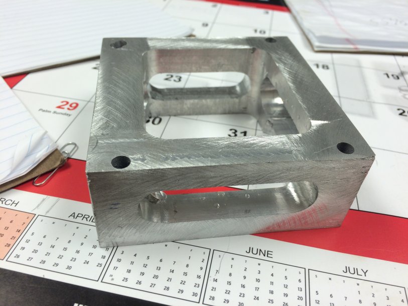

14 ounces!! way too much!
i just sent my buddy a text, to see how we can cut it down some more. I need it to be in 6 ounce range.
Wow...cant you move your batteries back a 1/16 0f an inch to balance...LOL.... dang Cam that aluminum mount is awesome. You ought to mass produce them...I'm sure plenty of people would choose them over plywood...looks good

Every one of those cross braces can be machined down to about 1/8 of what they are now! No need for that much metal, there's not really that much stress in the mount other than front to back.
A buddy of mine runs CNC lathe and prototrak style mills. He can do about anything you can dream up. We did a 2.625" mount for my crap ass BME 116 a few years back, when Kyle couldn't. We even did a 3"for a DA85 for a guy in Cali.
No need to reinvent the wheel. There are people out there who do this for a living and on the side, like me. Only thing is......... I'm laid up for the next 3 mo with a broken pelvis. I could have done the exact same
thing for you even with you supplying the material for nothing, just cover shipping each way. But I'm out of commission for 2.5 mo.
Just some info........ The one I made out of ply was WAY lighter than the one ou
t of alum. Like half the weight. As long as you have used a good HQ grade of aircraft ply, the corners will not cave in like cheap crap ass ply.
