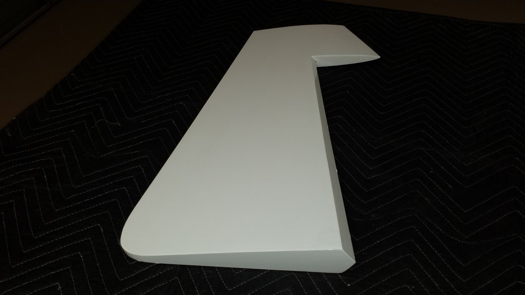

Well I've started. I completely vacuumed and use the air hose to clean the shop. Picked up some tack clothe on the way home today and cleaned all the wood. I have an idea of a scheme in my head but I am no good at drawing so I just have to wing it. I guess we'll see how it goes. I have covered numerous planes with monokote years ago but this one I am going to use Ultracote. I hope I don't regret it.

Well I've started. I completely vacuumed and use the air hose to clean the shop. Picked up some tack clothe on the way home today and cleaned all the wood. I have an idea of a scheme in my head but I am no good at drawing so I just have to wing it. I guess we'll see how it goes. I have covered numerous planes with monokote years ago but this one I am going to use Ultracote. I hope I don't regret it.View attachment 14913
Spats, I use ultracote to cover and I find that it is a lot easier to use than monokote. I'm looking forward to seeing the scheme you are going to use.
