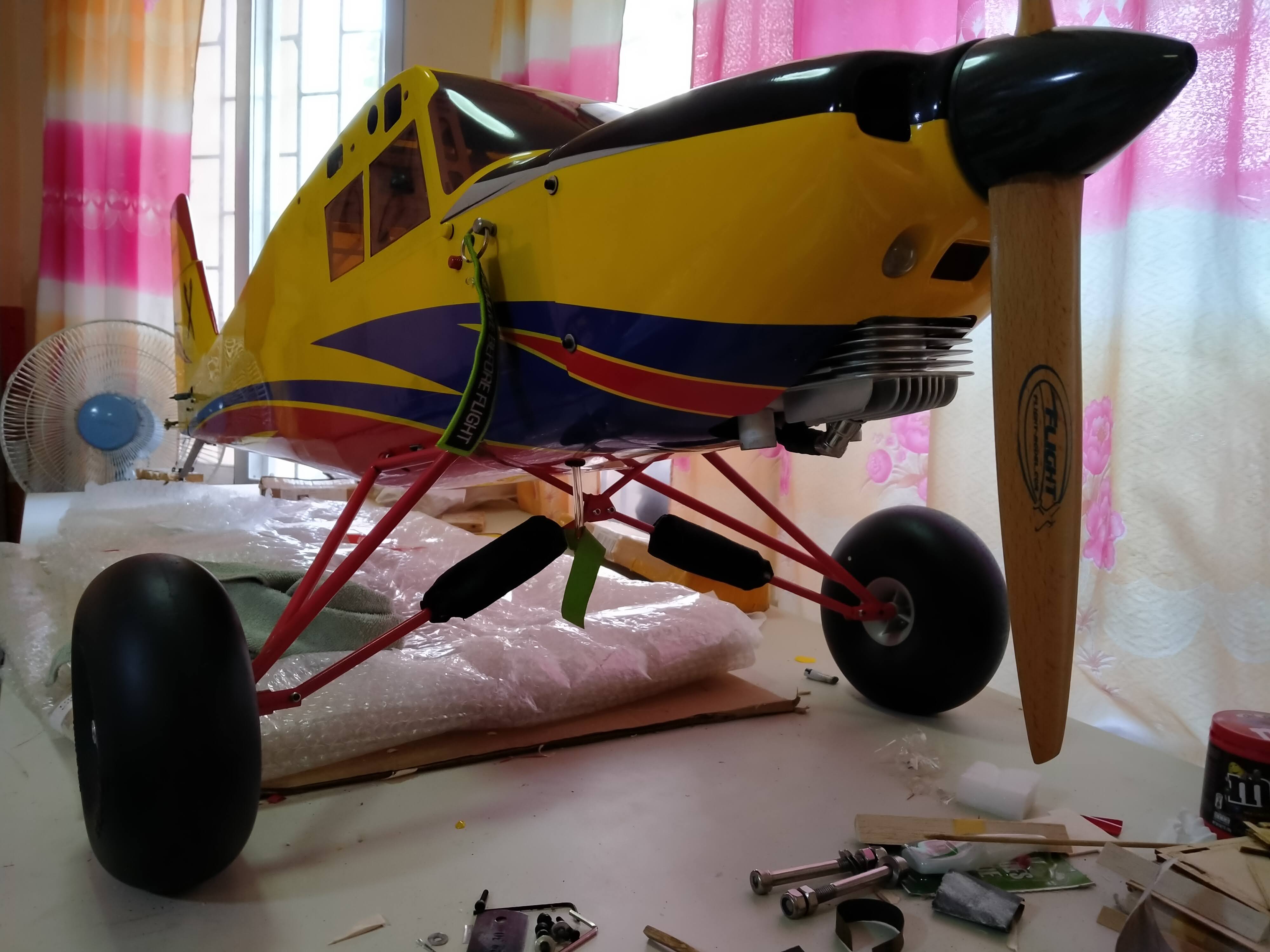

Hey, After watching your video, I am puzzled by something.

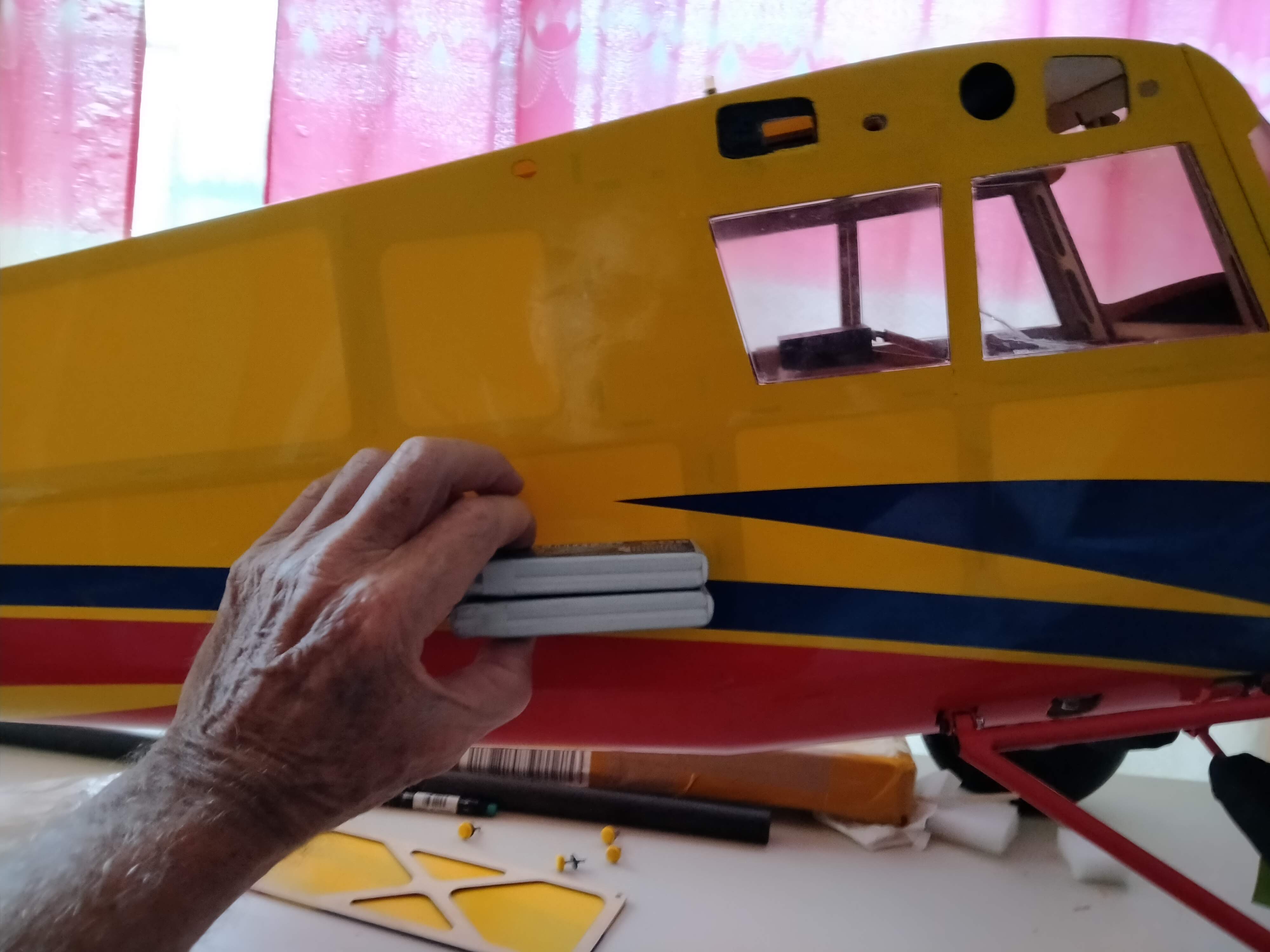

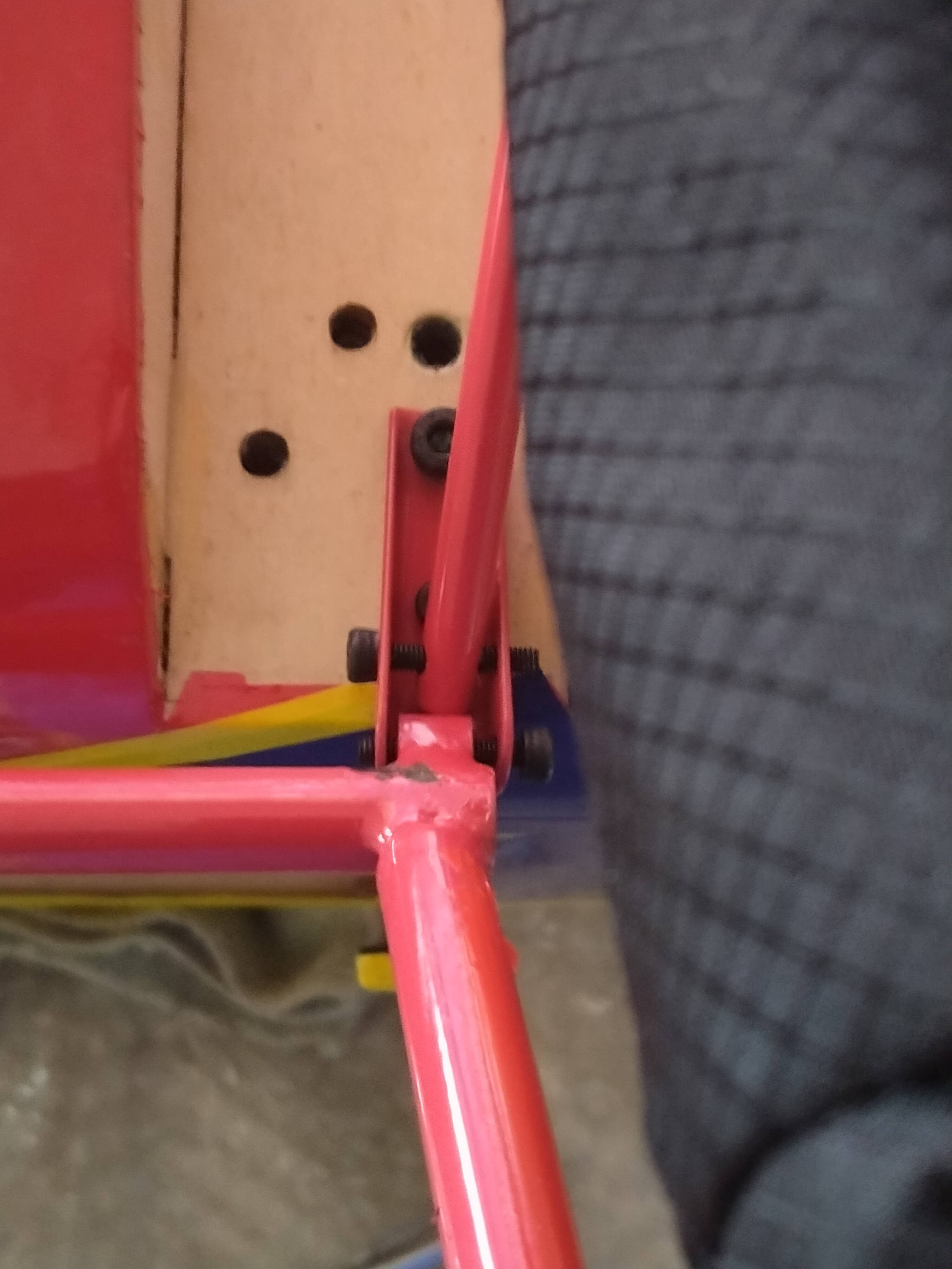

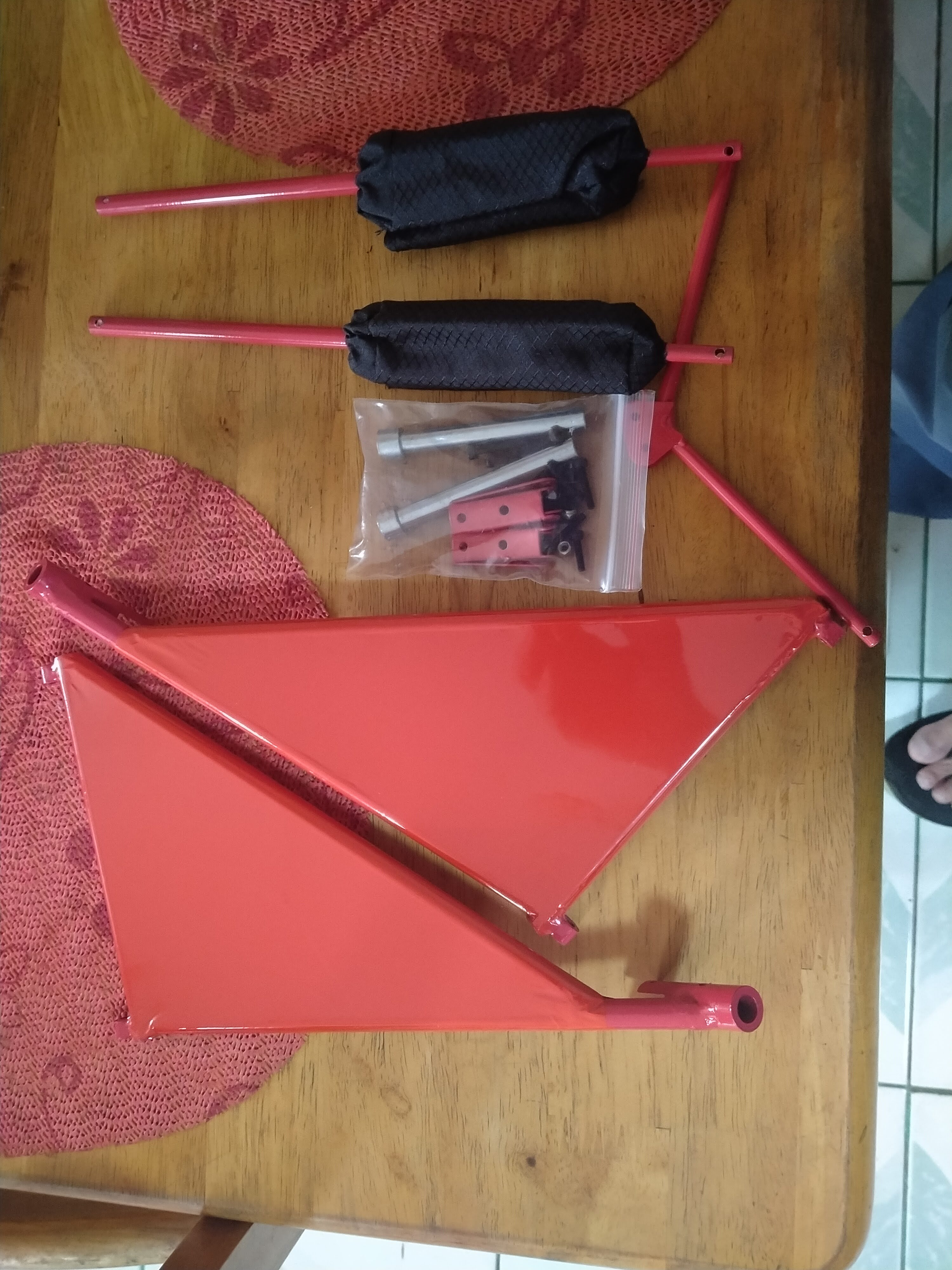

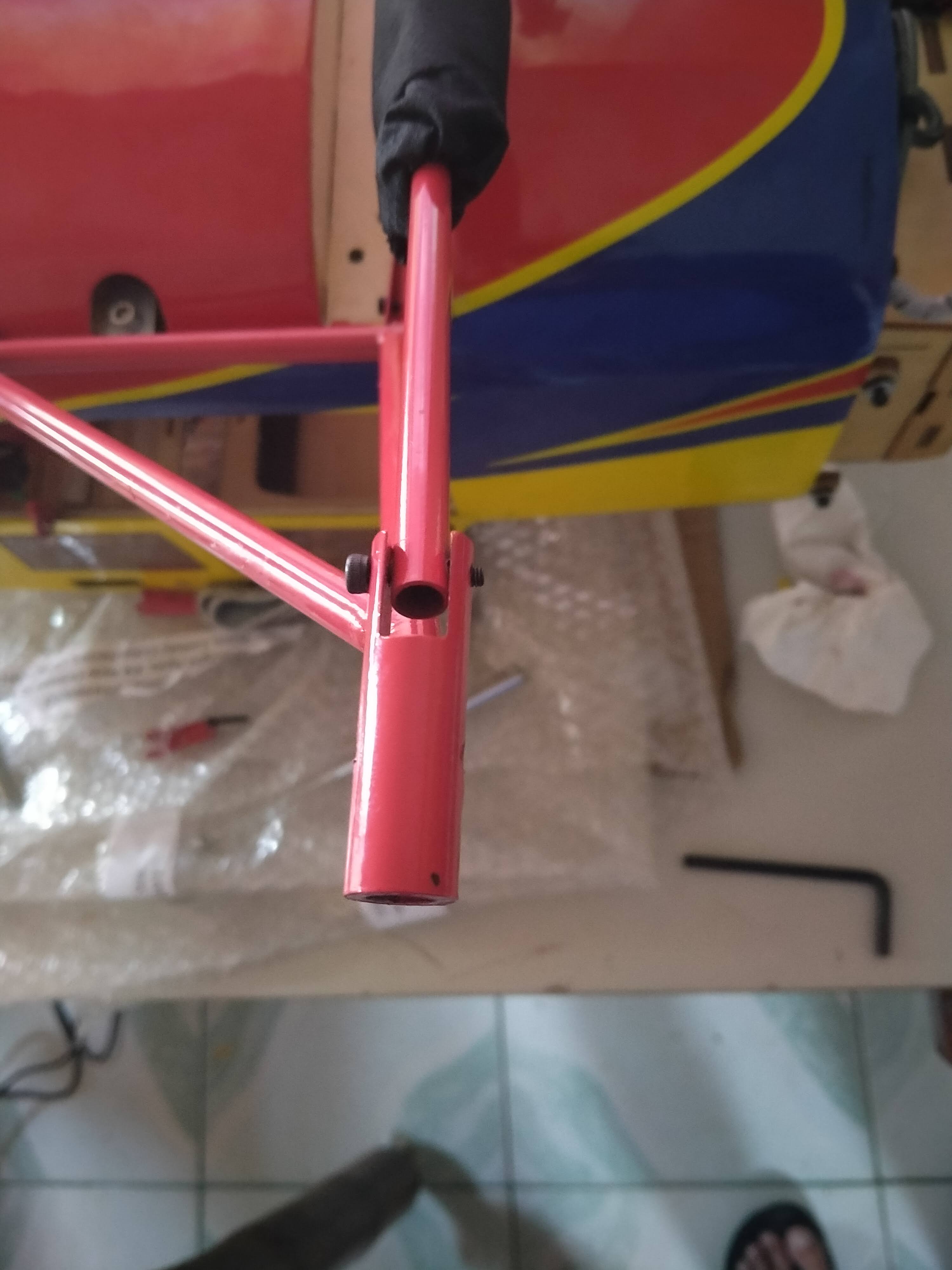

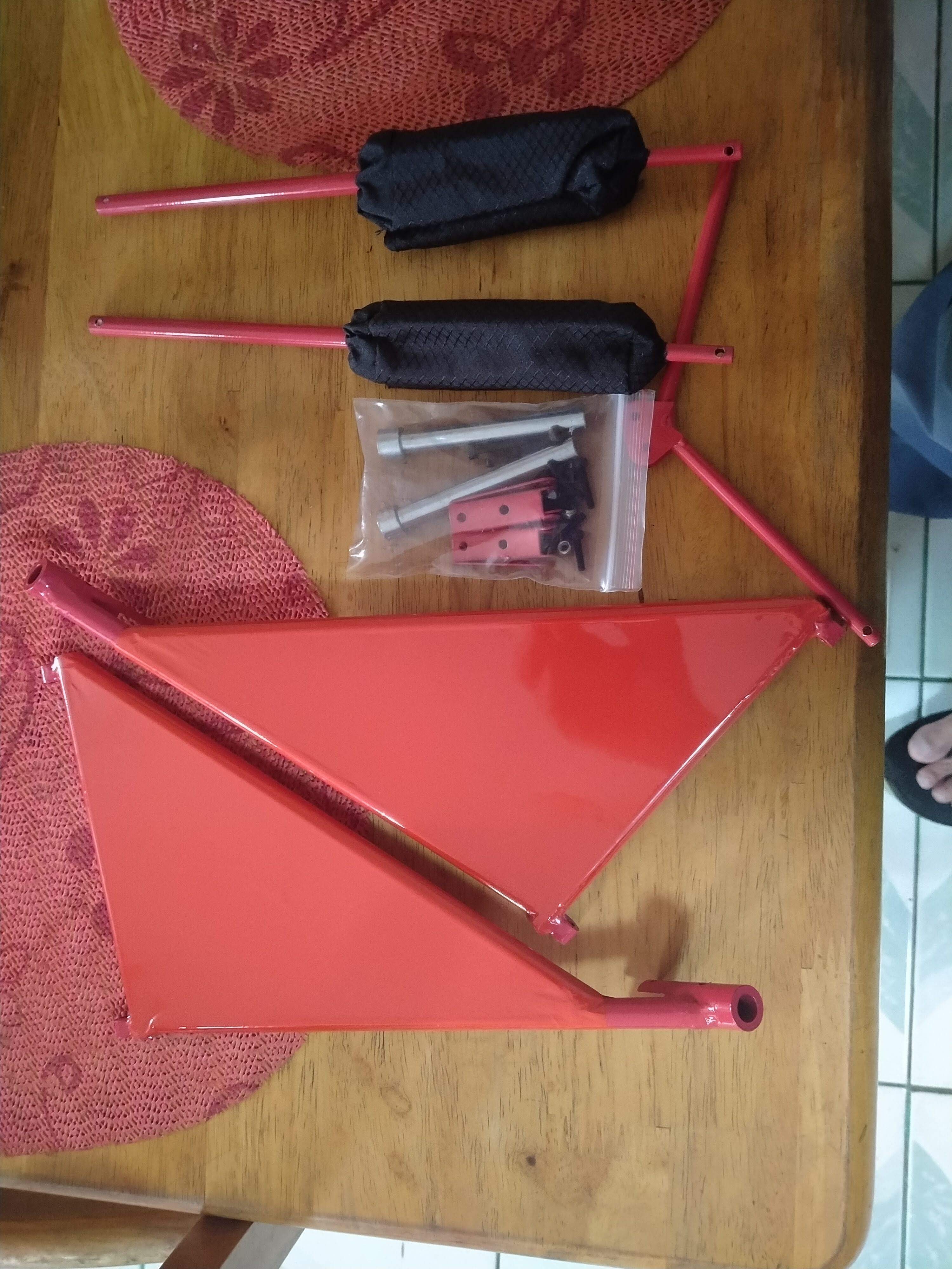

You added a ton of weight to the back of your Timber. I have the exact same set up now, but my batteries are located just behind the left side hatch opening and mine balances at 5", just a hair more nose heavy with the new gear. The airtops are quite heavy as well. so wondering why yours needed so much tail weight?
BTW had the re-maiden today in pretty windy conditions and it flies great with the new gear and repairs made. dropped it it a little hard and the gear didn't flex a lot which is the way it is supposed to be, as I see it. but it does move. I switched to a 22x10 prop and have 5" of ground clearance as is. Too early to tell much, but the performance is nearly the same with that prop. bites a lot more on initial acceleration it seems. have to wait and do more flights.
