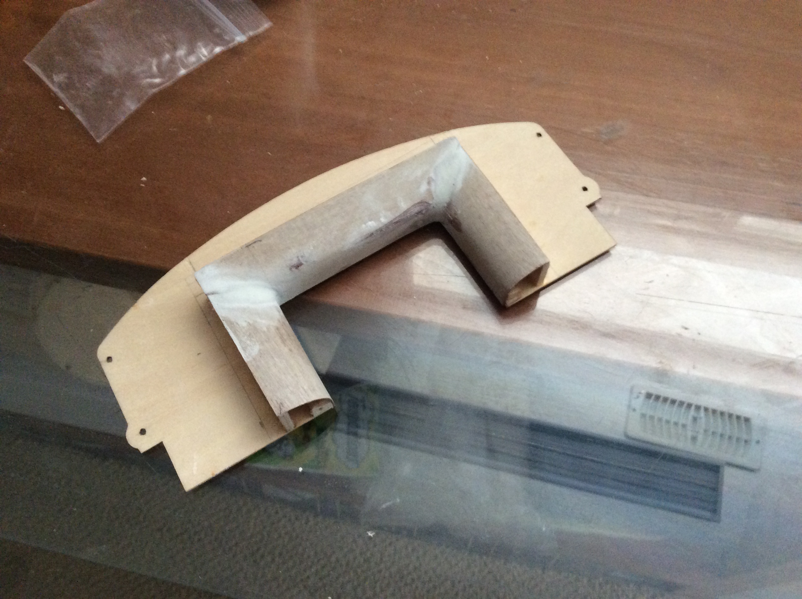

Made some changes to the air ducting for the motor and especially for ESC. Not quite done but this the first stage this is the front cover plate modified so that air flows over the ESC. Also did a little bit of duct shaping to help the air get into the slot over ESC.
